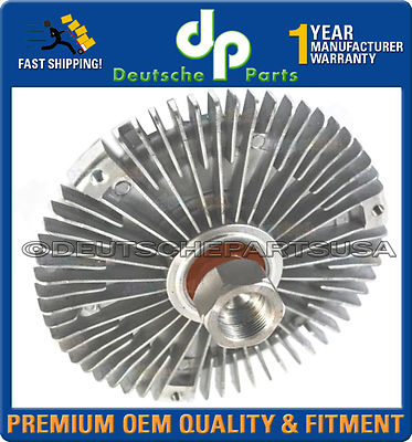

There are two water pumps, one uses a mount with four small bolts to the pump itself and a single bolt to hold the clutch, known as a ‘bolt on.’ The second has one large nut behind the clutch, 32 mm perhaps, known as a ‘spin on.’ You can use either but they must match, the newest one is perhaps easier to find, the spin on.
Not for an e9 but here is the spin on with the 32mm nut
