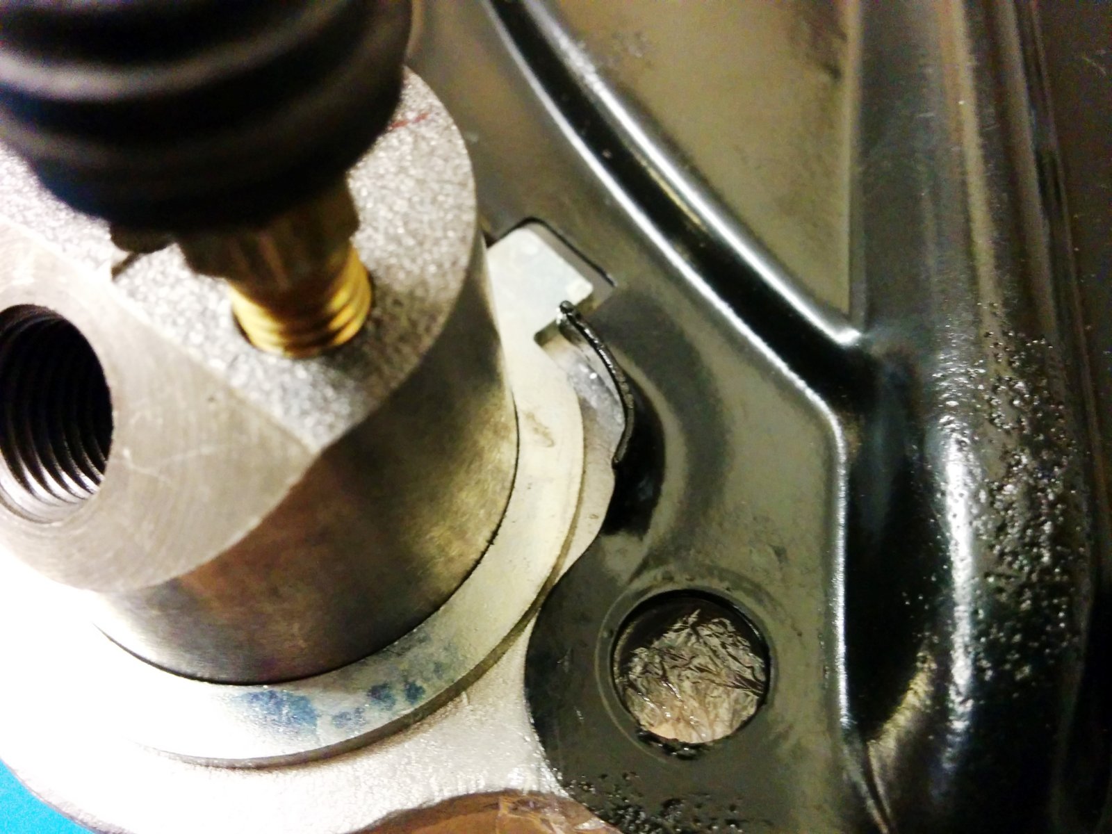

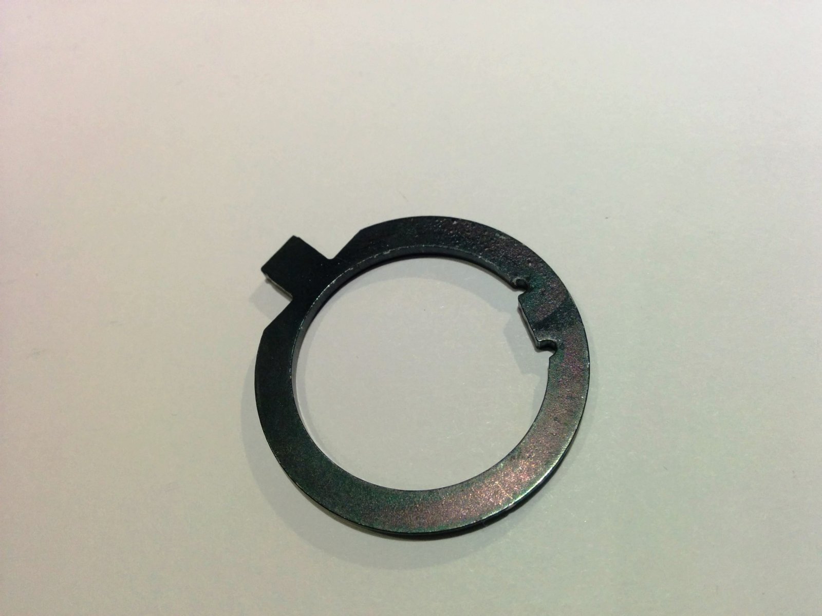

Early clutch slave cylinder bracket - 21521102748. I needed one of these but NLA. So, deduced the dimensions, got drawing and had some laser cut. Had them done at 2.5mm thick which is marginally TOO thick. Just about to have some more done at 2mm. I'll get maybe 10-12 done, they will be plated along with other items i'm having done. If there is anyone in the UK needing one, let me know and for a couple of £ i'll pop one in the post.

Just picked these up from the platers this afternoon. Had 25 made in the end, so have about 20 'spare'. These are version '2', not as tight a fit as the first version which may have caused issues long term. Fit on these is great.
Propose just £1.50 each plus £0.70 1st class UK postage. Please PM me and i will send my paypal details, and let me have an address to send out to. Please don't ask for 4, 5 etc if you really don't need them - they won't go very far otherwise!

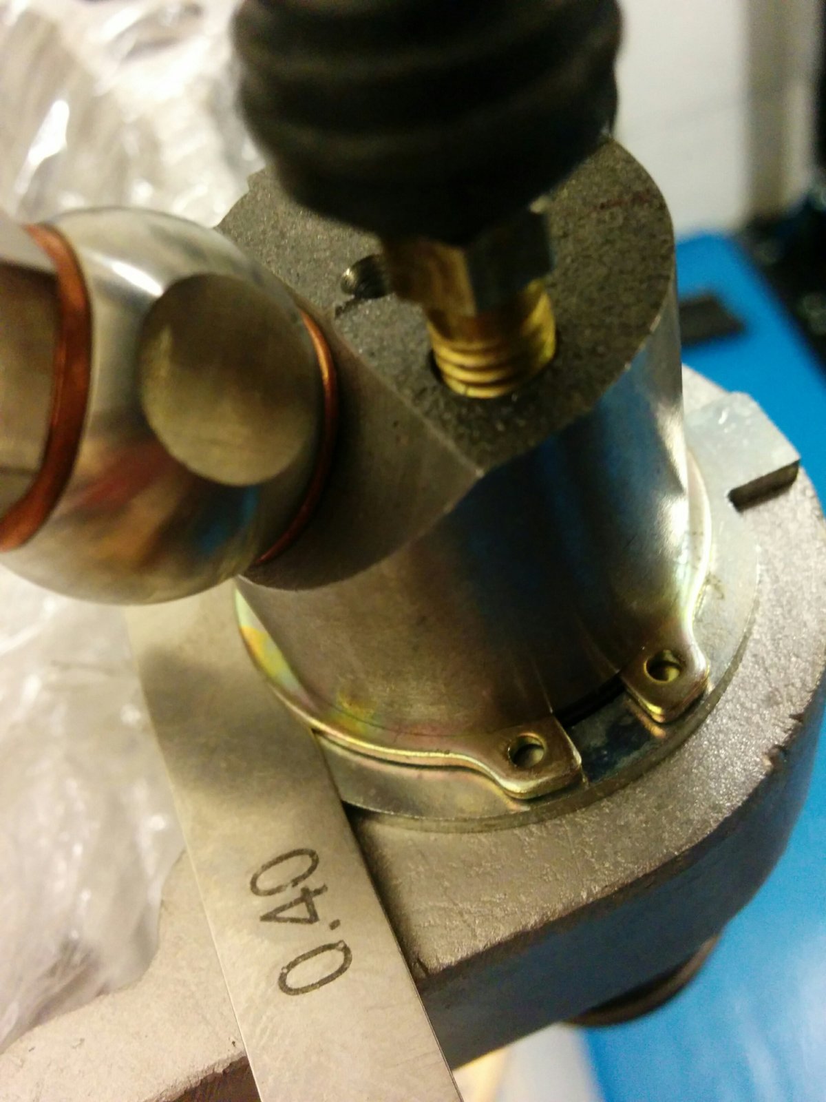

My bellhousing has been vapour blasted, new circlips. Gap on my installation is 0.4mm. (that's why the original 0.5mm thicker brackets would not allow the circlip to seat!)
