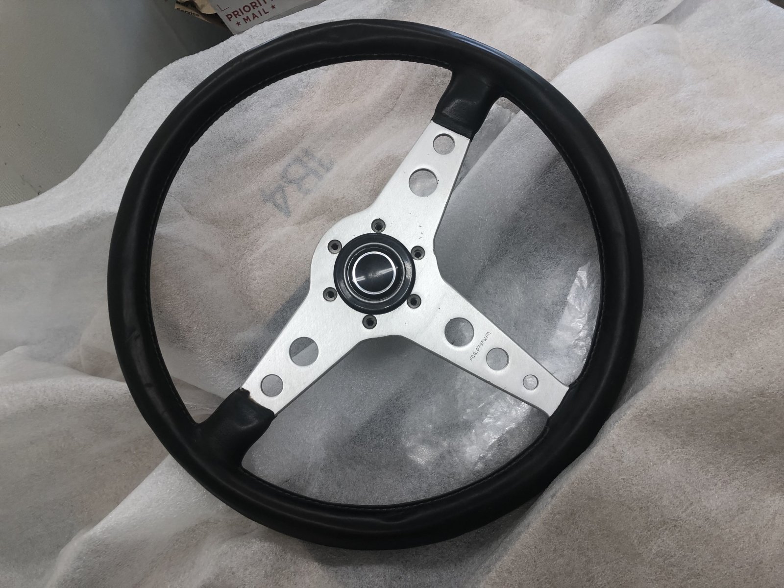

I have an early Prototipo with leather and stitching in decent shop, but the foam is very loose and/or shrunken in places underneath the leather. Has anyone had any luck injecting... magic goop?... under the leather and firming up the foam? If so, what kind of magic goop?
Thanks, Michael

There is a silicone syringe and the silicone with it that makes it very feasible to achieve.
Just saw it on the web the other day. Try this:
Please post results!
Regards, Alberto

Thanks for link, Alberto. Is silicon the right thing to use? Have you ever done this?

I have no idea, as never done it before, but it appears to be a good solution.
Plus, very inexpensive, and no need to recover a 'precious' wheel, if implants are easier and effective.
Please keep us updated :)
Regards, A.

I can tell that silicon-based glue used for windshields is really hard chemistry to peel of.
Someone use it to glue the plastic trim onto my car's fender and it took me hours to cut and peel it off.
Silicon to silicon can be different.
For sure I would apply it on several places with not a big volume per injection.

Michael, I would try to get a medicinal needle, as its tip is cut diagonally, to make insertion easier,
and not leave a horrible hole.
I don't know you either, but I commend you on saving a lovely wheel.
Regards, Alberto

I have to admit, I'm afraid to be the first person to inject silicon into my Alpina steering wheel. Seems like that would get very hard. I thought I remembered discussions about injecting some kind of foam, but perhaps that was with Petri wheels. Right now I'm using Leatherique products to heavily moisturize the leather and remove the oils and dirt, which is helping to soften it at least.
If anyone has experience dealing with the padding underneath, I'd love to hear about it.
Thanks, Michael

Why not get a broomstick, slice a chunk then fill it with silicone than wrap it
with a piece of spare leather, and see how it goes. The problem with foam, it compresses,
and might not be able to control the amount as it expand rather rapidly.
Clear silicone is not very stiff.
Regards, Alberto

Thanks for all the helpful replies. The wheel is responding well to Leatherique Rejuvenator Oil, which even seems to be expanding the foam a little. Give that the original leather and stitching is in such good condition, I think I'm going to leave it at that for now.

You want to use polyurethane glue, not silicon. The poly glue expands so in theory can fill those low spots in the soft or dried up foam underneath. The needle that Alberto mentioned is the way to go from what I understand. Caveat, I have not tried this myself but was told this is the method of choice by a professional. I would certainly never try it on an Alpina wheel first, but let me know how it goes if you do! Heh
