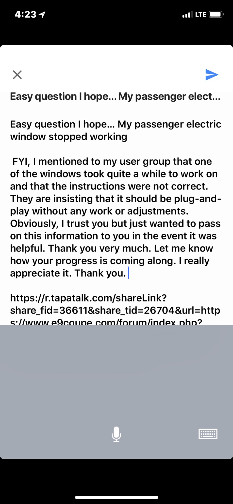

scottevest
1,981
598
Ketchum, Idaho
Even so I am still confused. Both Chris and Gary said the e28 motors were plug and play over two weeks ago, before the work began and before you left on your trip.
I am even more confused to be honest with you. I provided all the information previously provided to Bill Arnold including the portion that said they are plug-and-play and he still had to spend hours on it according to him. Not sure what else I can say here.
