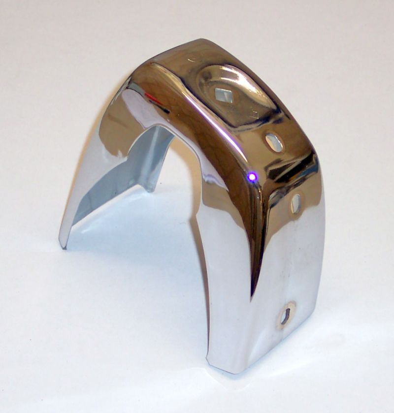

UPDATE: I received the NOS Over-Riders from BTS today. DHL is fast. When I opened the package and pulled out the parts my first thoughts were that these are so much heavier and with more studying I noticed that they have features that the eBay ones didn't. The rubber bumpers also fit much tighter.
My conclusion is that the eBay parts that I received were way over ground until they became defective. I suspect that these were extremely rusted and should have been scrapped.
I highly recommend the NOS over-riders from BTS.

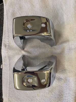

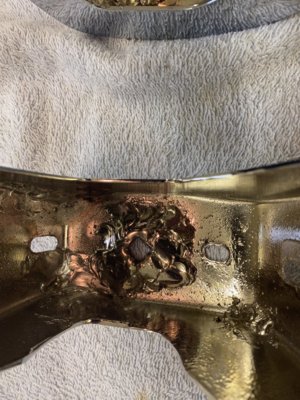

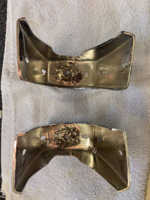

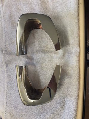

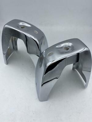

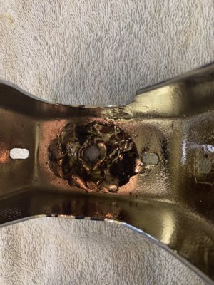

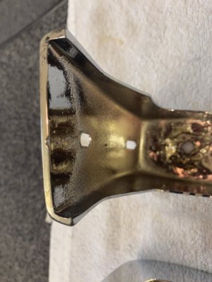

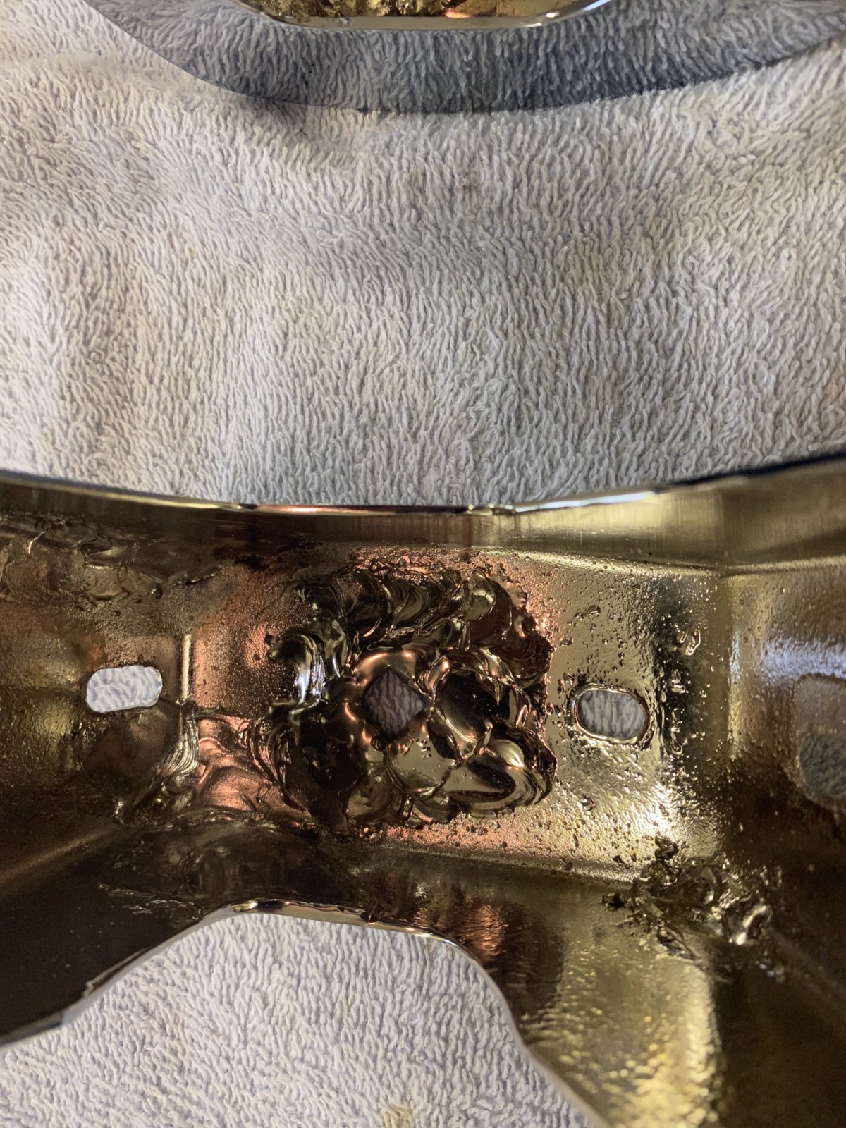

Dan, The box from Latvia arrived about 2 months after the EBay order was placed. The seller must have realized the problem with plating old rusty pieces that had to be ground smooth before the triple plating process. He added metal to the really thin areas as shown in the photos. I think they will accept the carriage bolts and torque down as required. The plating on the outside looks very nice. The next post will be the 2 pieces installed on my front bumper.
