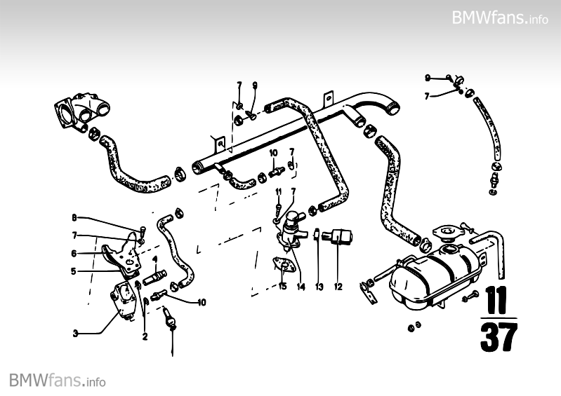

You superficially describe a problem that seems heat sensitive, so that poor operation only occurs when the engine reaches normal or above normal operating temperatures. This could easily be caused by a cold start system that is not fully disengaging, including disconnected or non-functioning temperature sensors, or a cold start injector that fails to completely shut off. One obvious scenario: if your vehicle has been sitting for a long period or it has seen limited maintenance, it is possible that coolant passages in which the bottom-most temp sensor and/or auxiliary air valve (14) sits, are clogged and not impacting the sensor or the air valve. The fuel injection system might function as though the engine is cold (despite it being warm or hot). Instead of fuel starvation, it would create a fuel rich or “flooding” situation. Neither scenario is a good one. This is not to say that there are other possible causes of your problem - given the limited information you provided.
Good luck
Note parts at center left containing auxiliary air valve

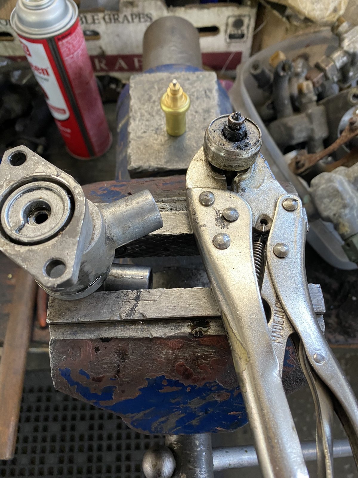

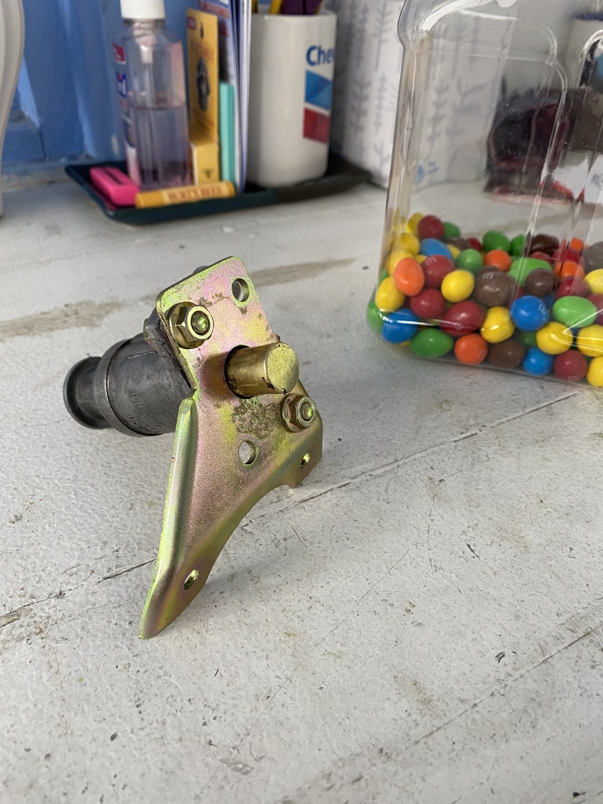

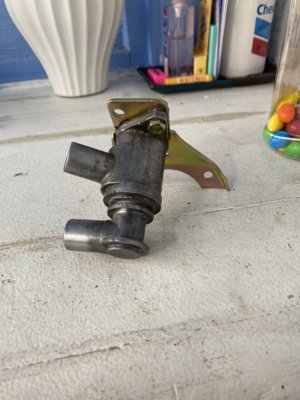

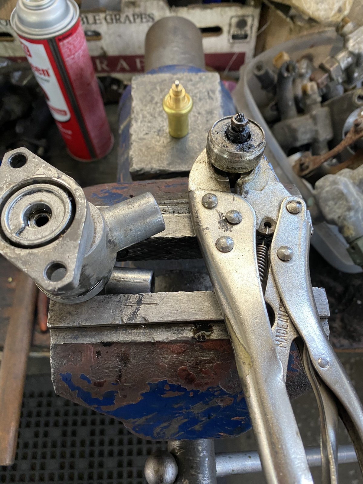

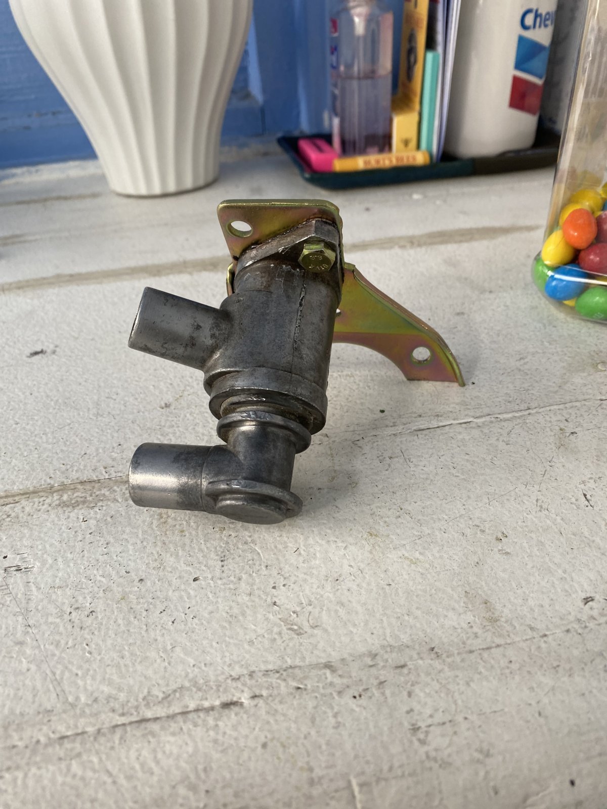

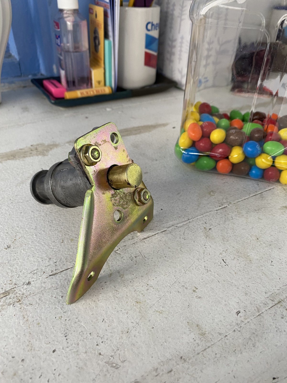

I had to replace my auxiliary air valve a few years ago. I could get it to start and run cold but not hot or I could get to run well hot but be almost impossible to start cold or I had to keep it at a ridiculously high idle rpm. I got mine from a guy in Norway that rebuilt them, but there is a Mercedes one that is angled the other direction.

I have a spare you can try (red spot). I am confident that it works fine. I am at CW3 9LQ and on 07860 515049. Best, John.
Finish this week..
