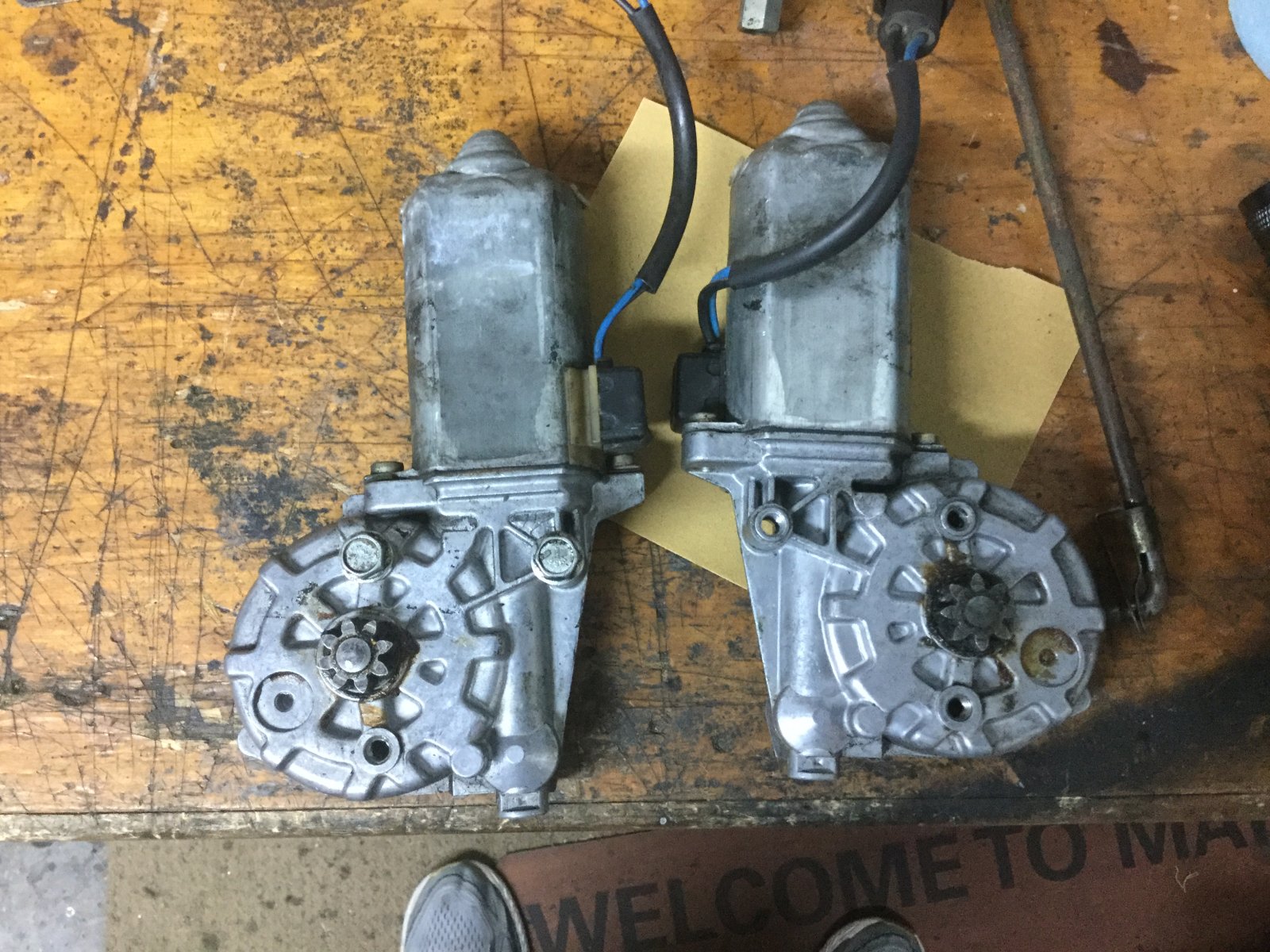

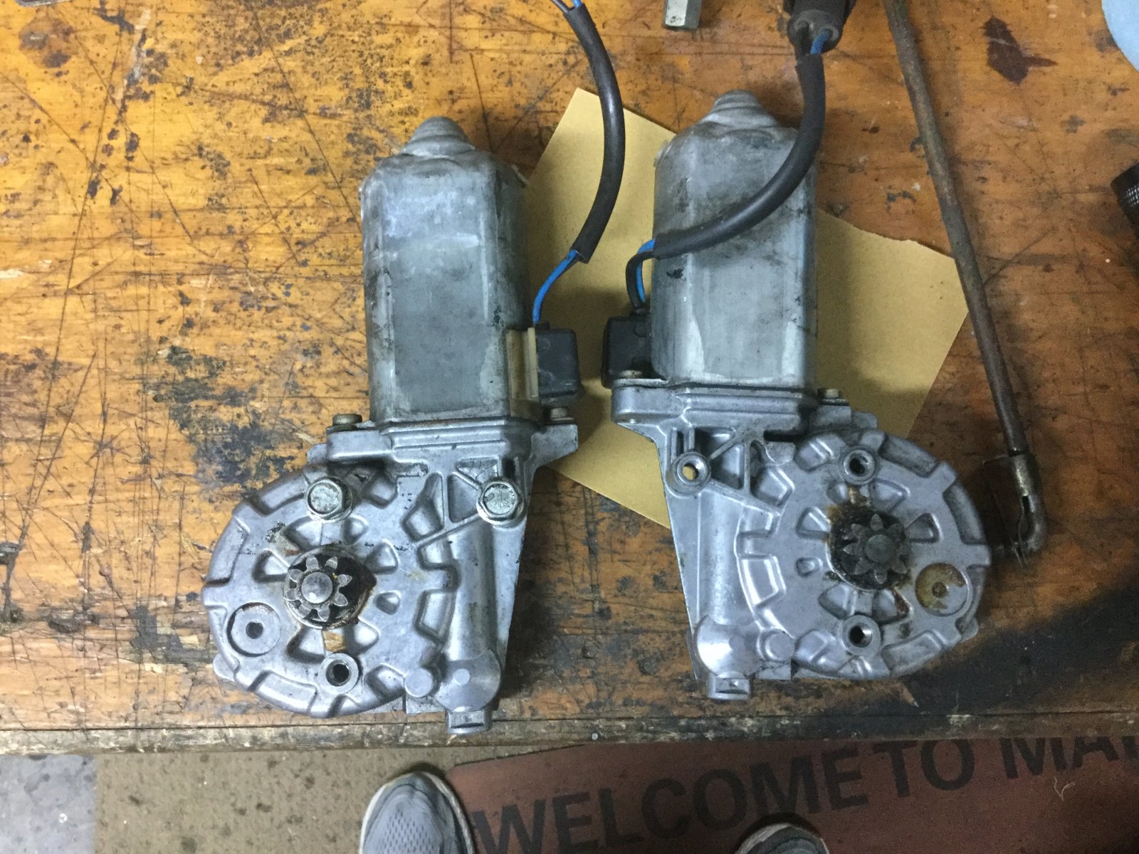

That's "sardine cans"! But Chris says that you have a '74, which evidently has the newer style motors. Posting a photo of what you have would clear things up. I have posted a photo of e28 motors below. If by chance your car does have sardine can motors, I wouldn't bother rebuilding them - the newer style motors - whether from a late e9 or an e28 - are the way to go.

Yes, they have to be e28 motors. And not just any e28 motors - that would be too simple - they have to be REAR e28 motors. And the L rear motor from an e28 goes on the right side of an e9 (either front or rear) and visa versa. The correct motors will have an 8 tooth drive gear; motors from other BMW and Porsche models with 10 tooth gears will otherwise look similar, but not mesh with the large gear on an e9 window regulator.

Late E9 motors look the same as E28 motors but are about 40% slower. But E28 literally bolt on are already wired correctly.

So the e28 motors are all interchangeable, front back, right left? in this case, the left rear will fit the front driver door motor?
NOPE! I'd phrase it as: "e28 motors are not interchangeable, front back, right left. So, only the right rear e28 motor will fit the e9 left front drivers door".
For what it's worth, right rear e28 motors will also fit the e9 left rear regulators. And visa versa.

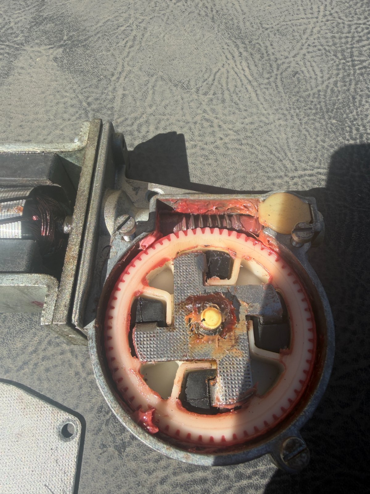

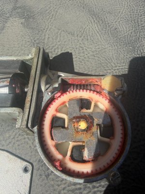

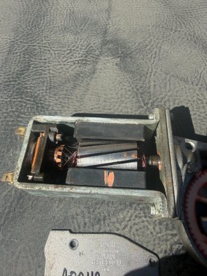

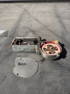

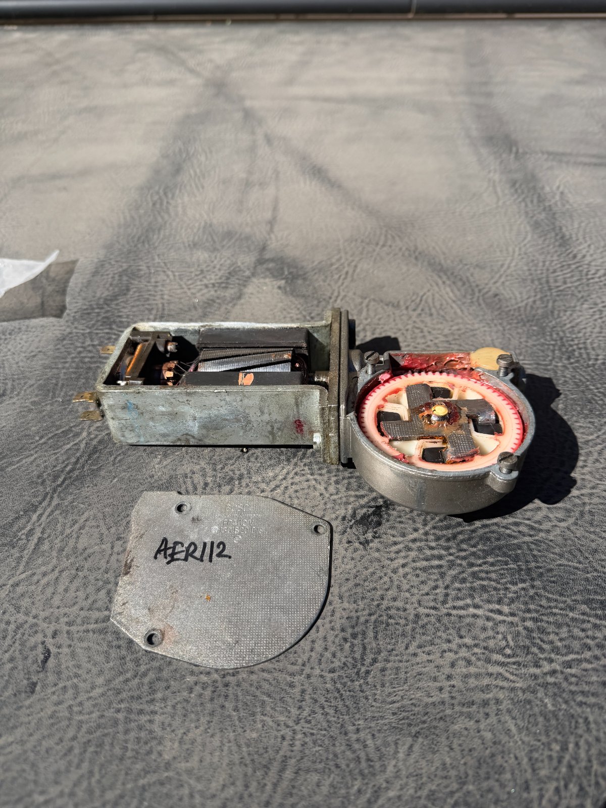

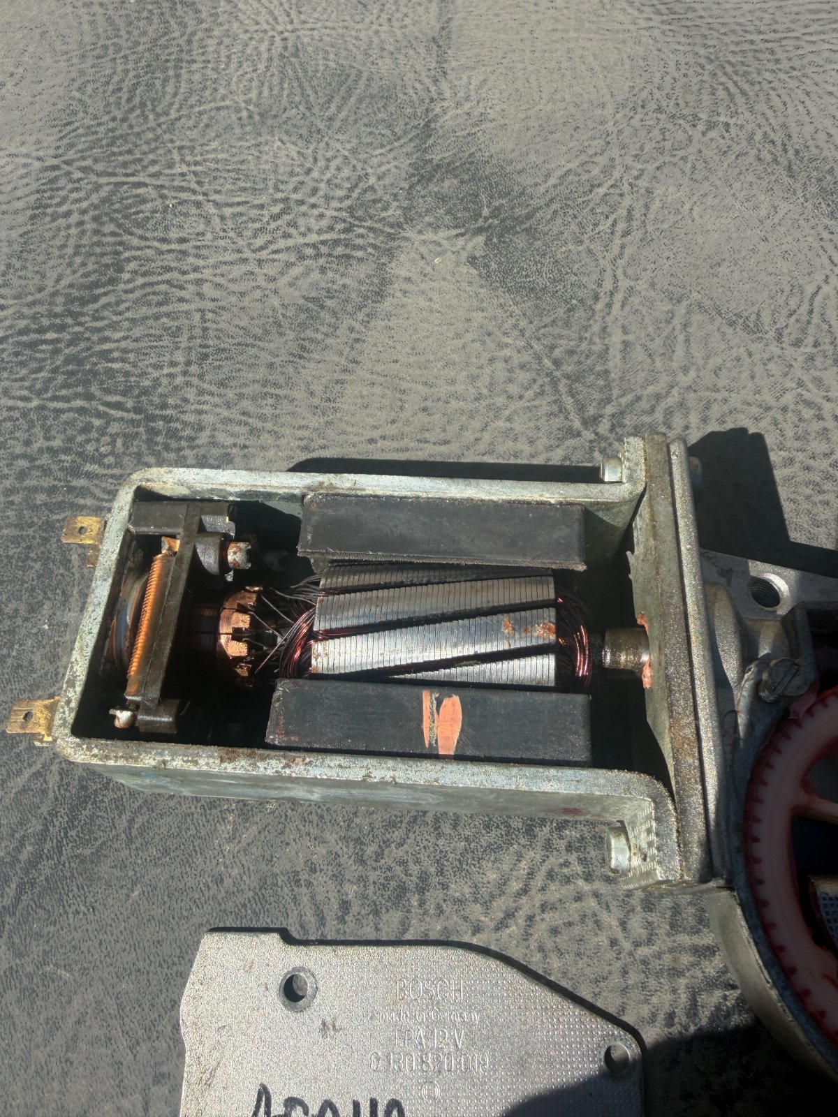

Here is a pic of the window motor.
That certainly isn't a "sardine can" -style motor; those have separate gearboxes. Yours looks like the configuration of an e28 rear motor, so something like the one on ebay referenced in e9Leveque's post #13 should fit.
NOPE! I'd phrase it as: "e28 motors are not interchangeable, front back, right left. So, only the left rear e28 motor will fit the e9 right front and right rear regulators."
I was told the motors changed in '74, I believe these are original to the car, but could be wrong. The picture on Ebay looks slightly different than these and these are VERY SLOW and I heard the e28 was a faster motor/regulator. Not sure why BMW would redesign in '74 and still have a slow motor...not like them.
I'm just going to grab that Ebay motor so wish me luck. Hopefully it is in working order. I reached out but no word back. Thanks for all your help guys.
When you say "these", I assume you mean your motor pictured in post #16. It's a little hard for me to tell exactly what that one looks like since it is disassembled. I can say with certainty that it isn't the earlier, "sardine can" style. Does the side of your motor with the gear have the three, 6 mm, tapped mounting holes that the motors shown in post #4 have? If so, a right rear e28 motor should bolt into your left regulator.
