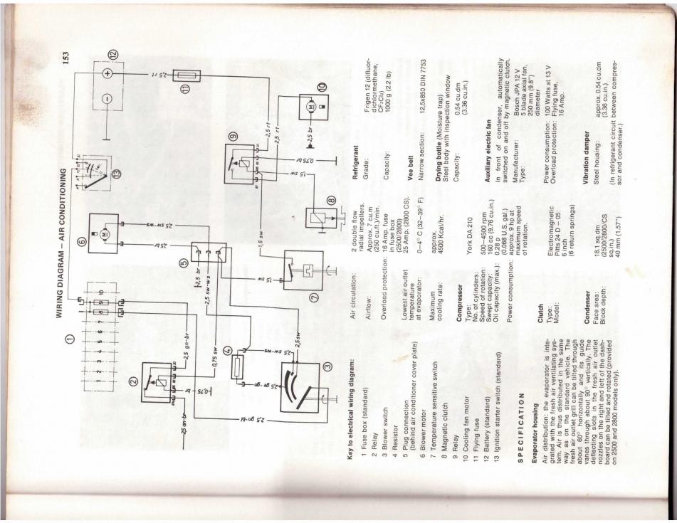

Will this help?

those two sensors IMHO are the ones related to the AC electric fan, they are there for compensating the presence of the AC front evaporator that reduces the flow through the radiator, i know they have two different temp settings to act when the AC is not on but the engine requires the AC electric fan to help, one for each speed

The schematic is in the E9 manual and may the same as posted above. See it here at the bottom of the page.
http://www.e9-driven.com/Public/Library/BMW-E9-Manual/pages/en/64500200.html#refertoc

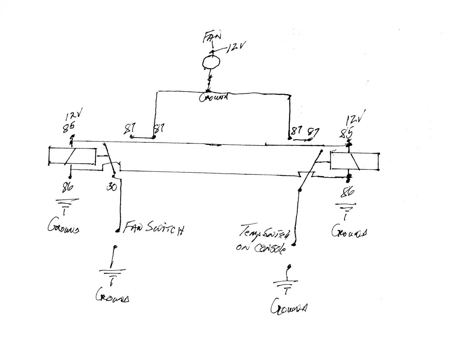

I completely rewired my electric fan so it operates with the a/c on or when the thermo fan switch in the radiator turns it on. I've attached a schematic showing how I wired my car. I replaced the factory electric fan with a Spall hiflow fan and I used 2, 30 amp 5 pin relays. I hope this helps.

Ken - I believe DougE's wiring schematic is incorrect. The relay switching circuit usually runs through the 85/85 pins and the higher amp 12 volt source to pin 30 and then pin 87 to the fan. If I understand the diagram he shows the 12 volts driving the fan running back through the switch and nothing controlling the switching side.
