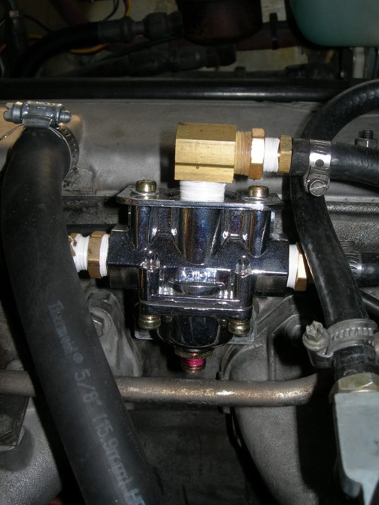

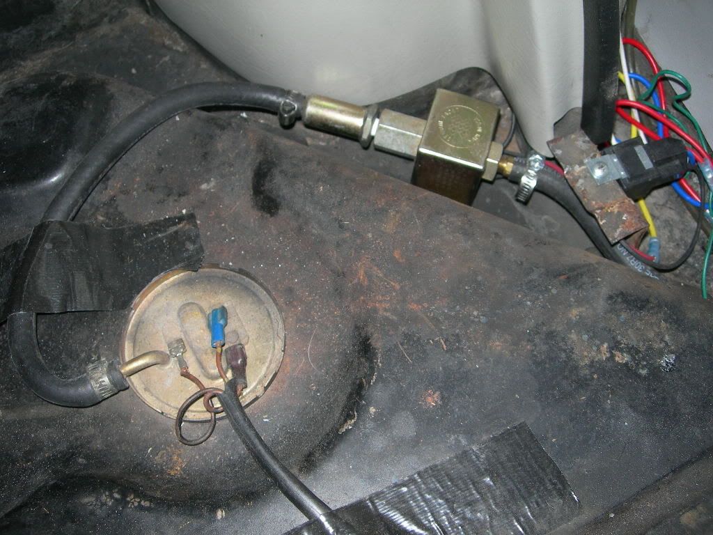

I did do a electric fuel pump conversion after experiencing a vapor lock after doing a conversion back to Zeniths. I chose a Facet 40106 which is 4-6 psi. Since the Zeniths are happier with about 2-3psi I also installed a Holley12-804 1-4 psi , two port, adjustable high capacity pressure regulator. The two ports on the regulator are perfect for a coupe. I had planned to set the pressure to 2.75psi but when I put on a pressure guage it appears that this was the default setting.

I installed the fuel pump in the trunk as shown in the photo; this position allows the fuel tank cover to fit down without interference. I was able to tuck on mount pad under the fuel tank and I drilled a small hole and screwed down the other pad; I recommend installing a bit of rubber mouse pad under the unit because it makes noise. I also ran a fused power feed from the battery (the same one I used for the windows) and feed it through a relay connected to the ignition circuit; eventually I may install a hidden fuel cut off switch for added security. As you can see in the photo, I also put a pre-filter directly on the pump.

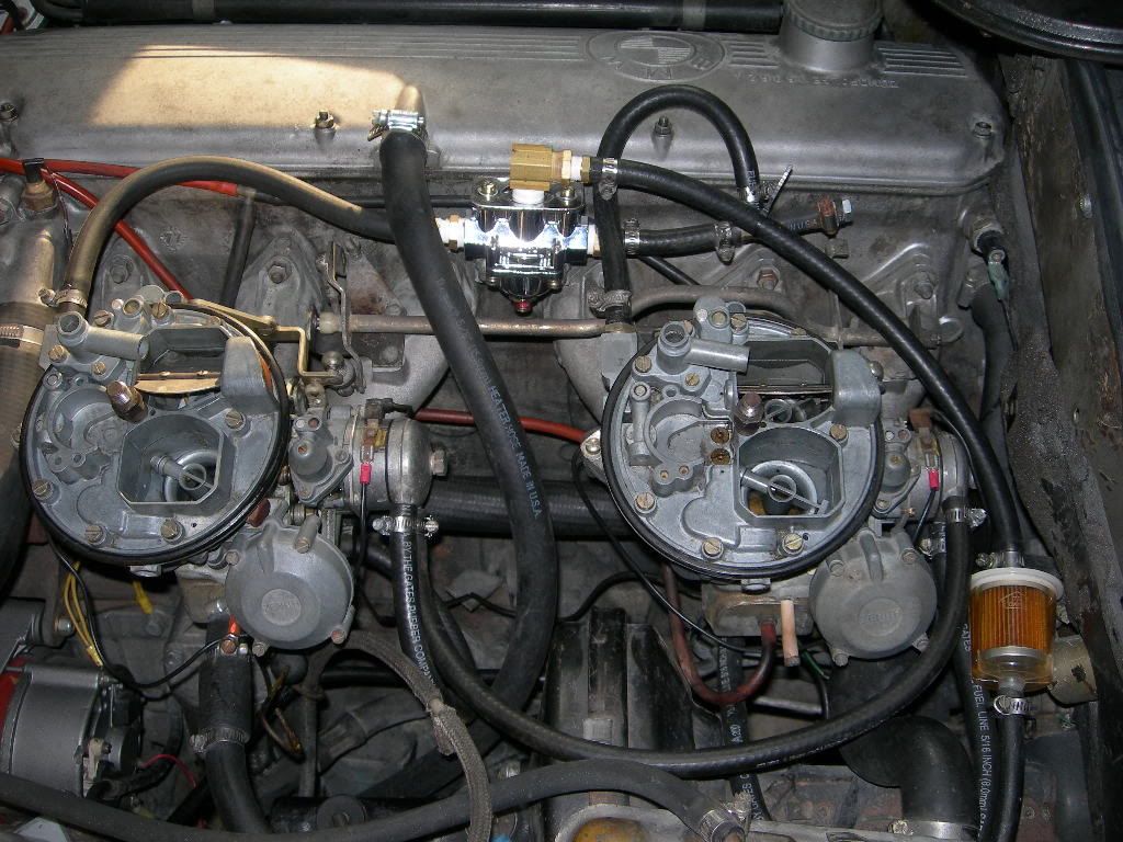

In the engine bay I added a clear fuel filter before the regulator. The regulator is mounted on the old fuel pump studs. I cut our a piece of thick aluminum (probably about 0.15") to cover the fuel pump hole and added holes on the top to mount the regulator. I also plumed in a pressure test point behind the rear carb in case I want to test again.

- How did you route the line from the output side of the fuel pump? I can readily see how the input from the tank routes into the pump, but what path does the line take after leaving the pump? Does it still exit at the front of the cavity, ahead of the tank? Or did you put a hole in the trunk floor, aft of the pump, and run the line underneath?

Routing the pump output was a bit of a head scratcher at first but then I realized I could just route a long piece of hose clockwise around the tank. It all went together rather tidy and I don't have any sharp bends.
