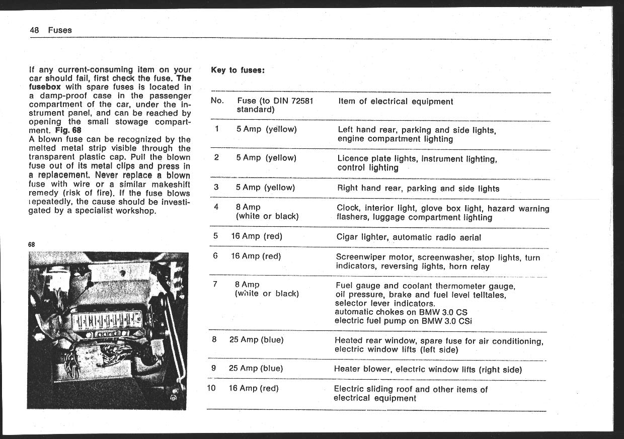

According to your owner's manual - fuse no 9 controls both window motors on the right/passenger side of your car. So while it is possible that a fuse has blown, it is unlikely since you state the rear window continues to function.

Hey thanks for the good info, pages from the shop manual and the quick replies. I just came from the garage and I can detect some current draw when pushing the button and the rear window on that side is also making a noise, but not going down now (it was working a few weeks ago). I do have the disk where I assume a crank handle would have gone. I am going to bed soon, but will check the fuse tomorrow to make sure it is good and to look for corrosion. With both windows now not working I am guessing I have corrosion or a weak connection somewhere which is not providing a good connection and possibly not enough voltage to operate the motors. I will report back after I do a little testing. I do have a voltage meter as well that I can put to use. Thanks again for the helpful post.
