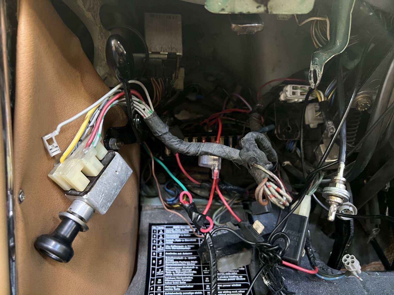

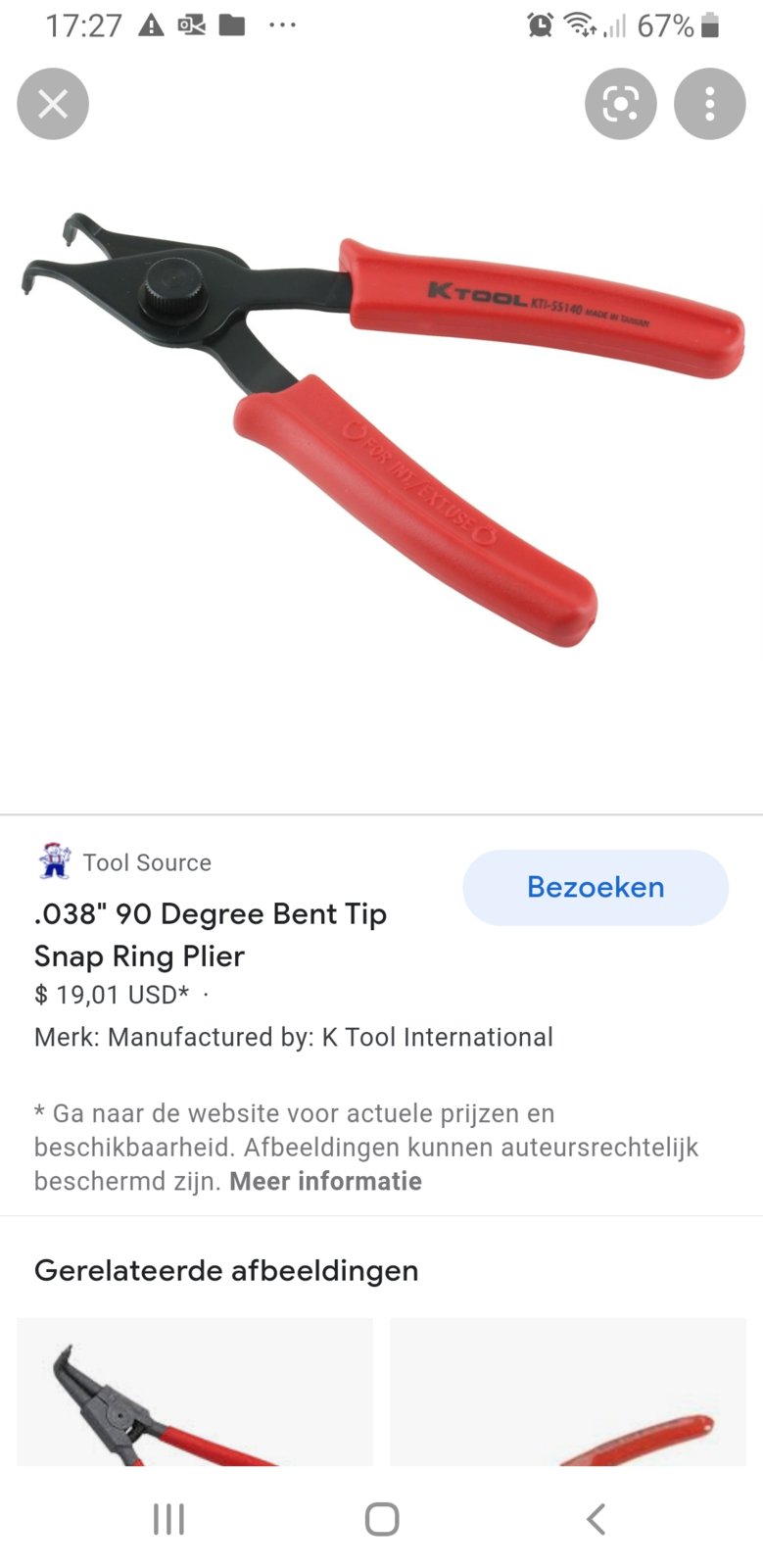

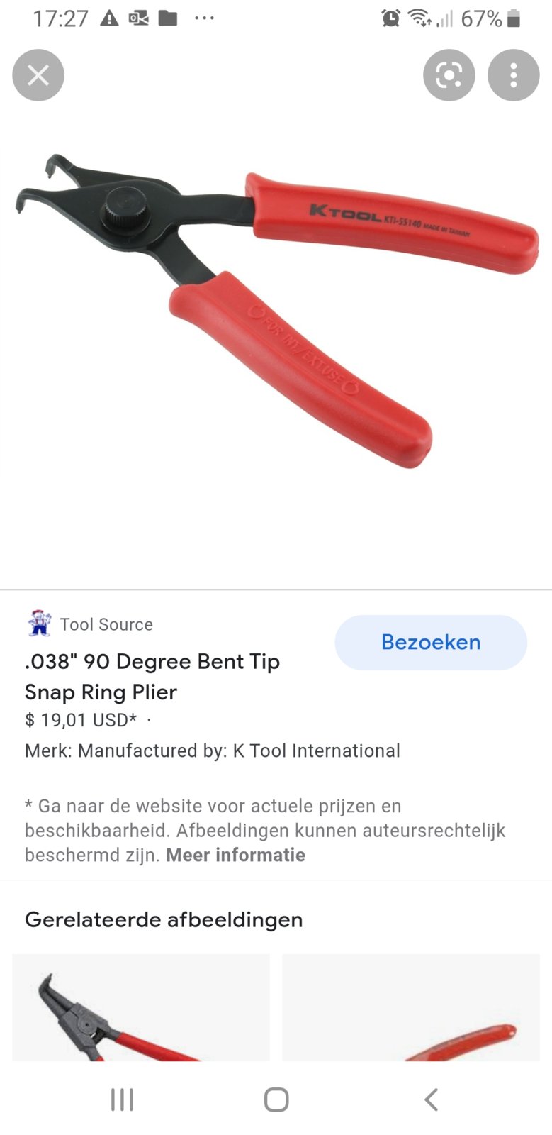

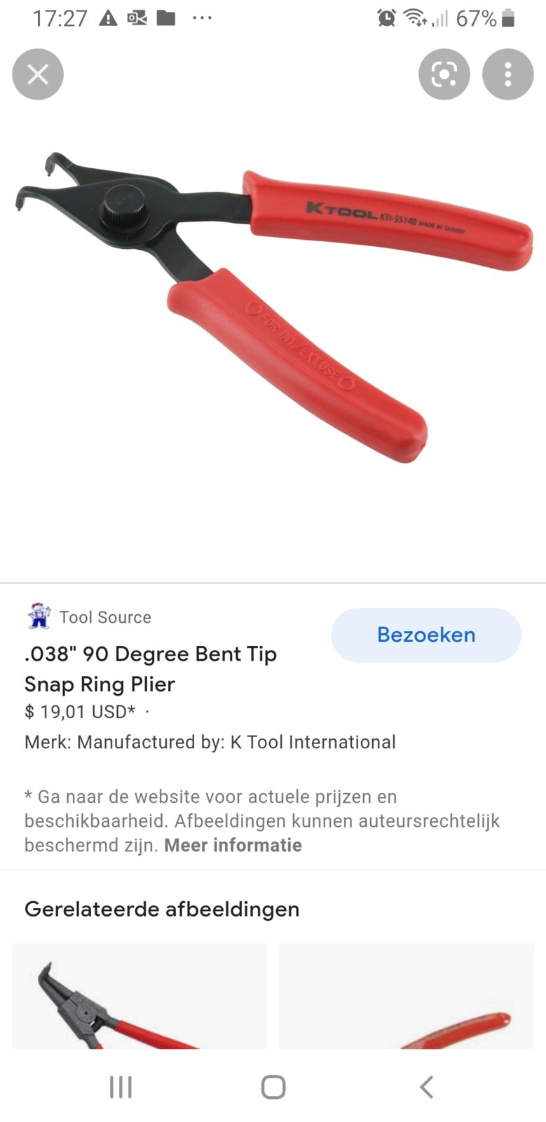

You can also unscrew them with a correct size Snap ring plier. If so, push hard so not to have it jump out and make scratches.
If you happen to have one already, it saves you buying a tool that you need only once..
Erik--You are the Forum's official Tool Man. If that special tool had a red handle, you would have it in your trunk toolbox already.....:)

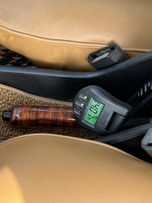

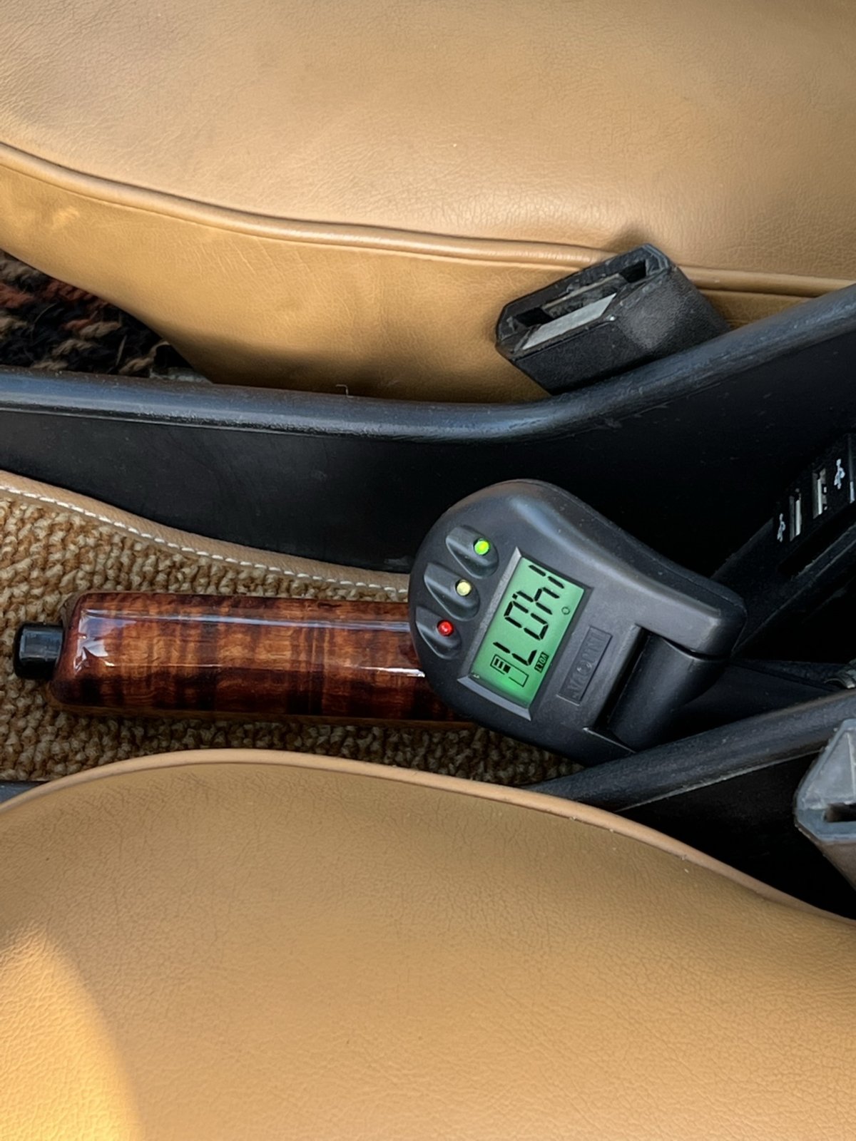

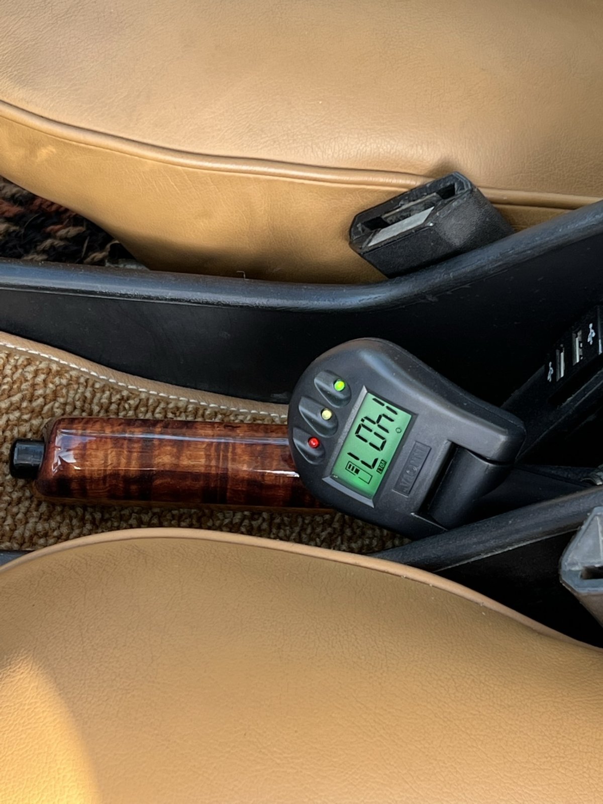

The EQUUS # 3721 battery & charging diagnostic tool is a safe way of seeing if your charging system is working correctly while driving. Plug it into a cigar lighter power port and read your voltage and check your charging system at any RPM. I found it on eBay for about $35. My lighter is not wired up,but I have a power port in my custom console.

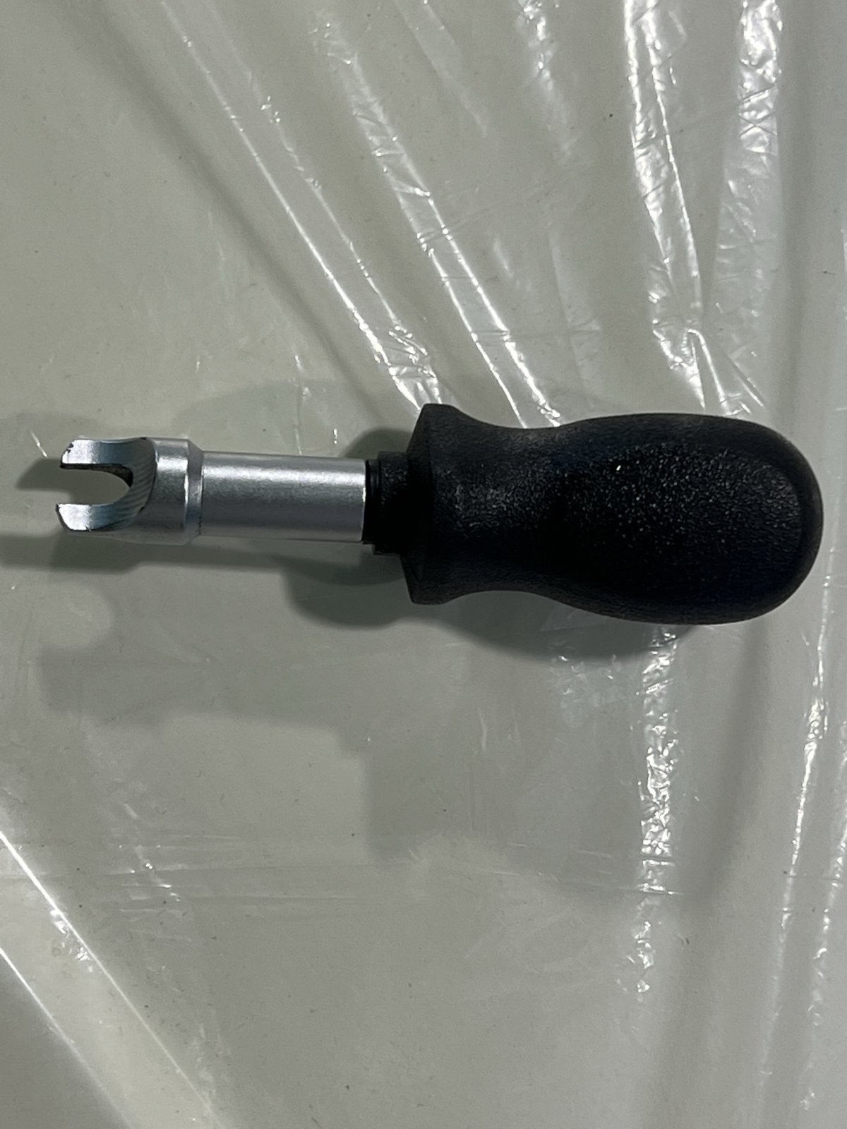

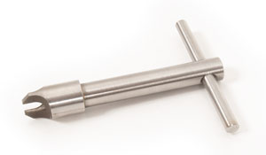

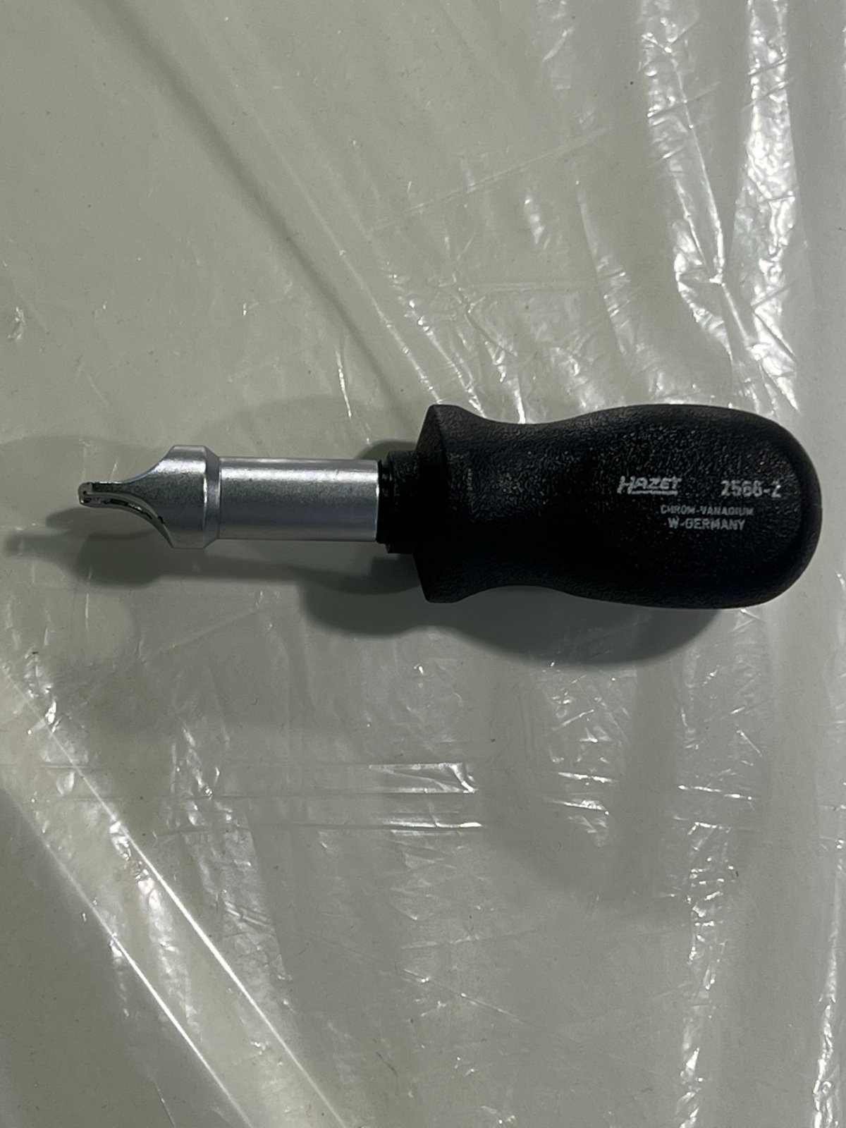

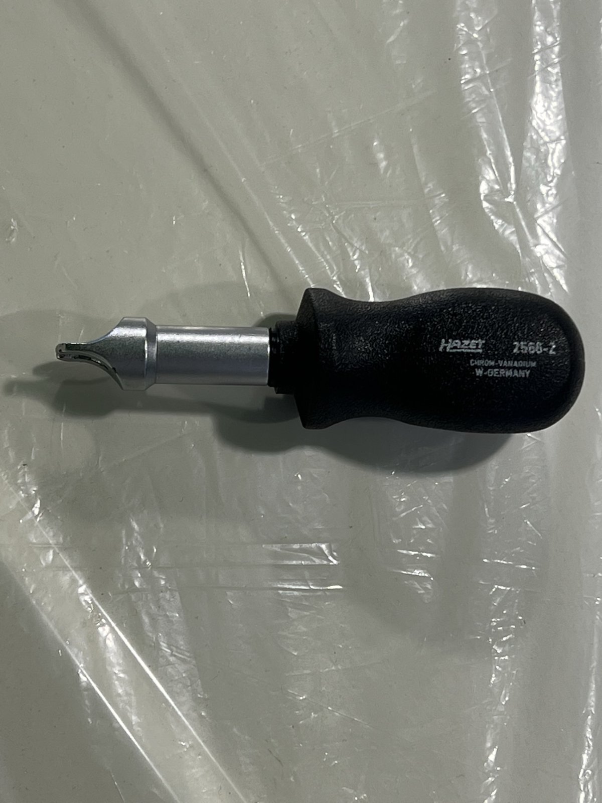

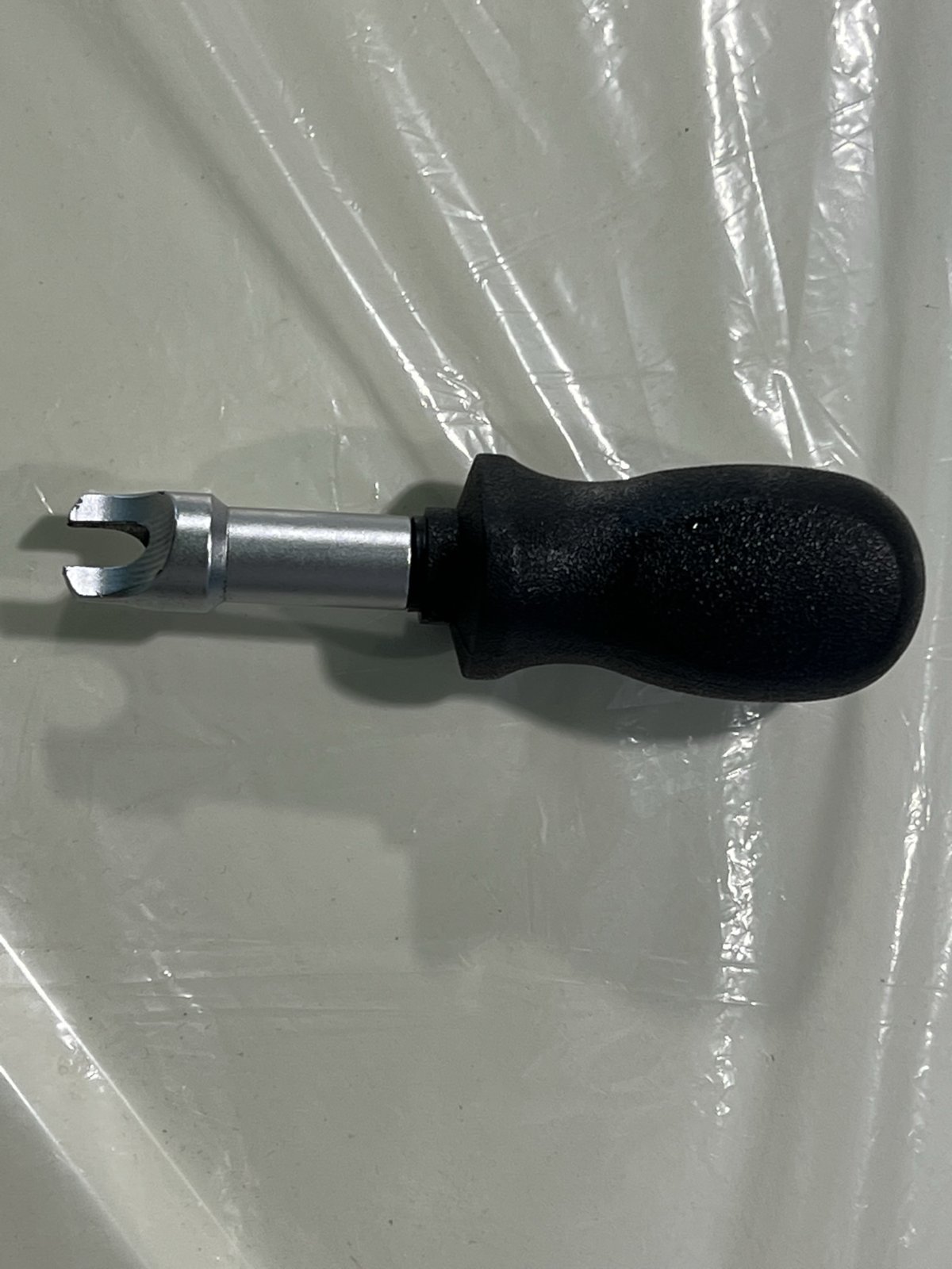

It looks like the same tool that similar age VWs used for their light switches. I used to have one, decades ago with my VWs. It shouldn't be too hard to find.
Ah, here's one.
I went to their site and bought the tool. It has tangs that are a tight fit. Pretty rough machining, but a little hand file to soften the edges and the tool will safely remove the headlight switch bezel. Thanks for the link.-----Drew

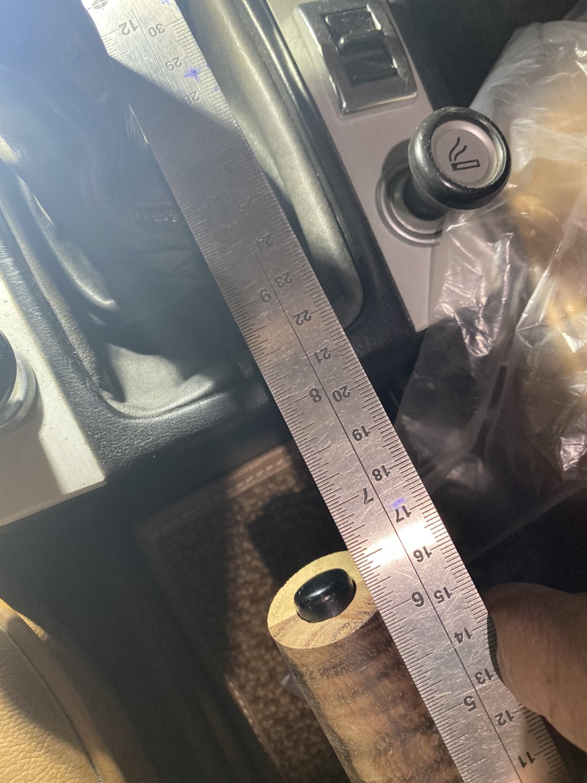

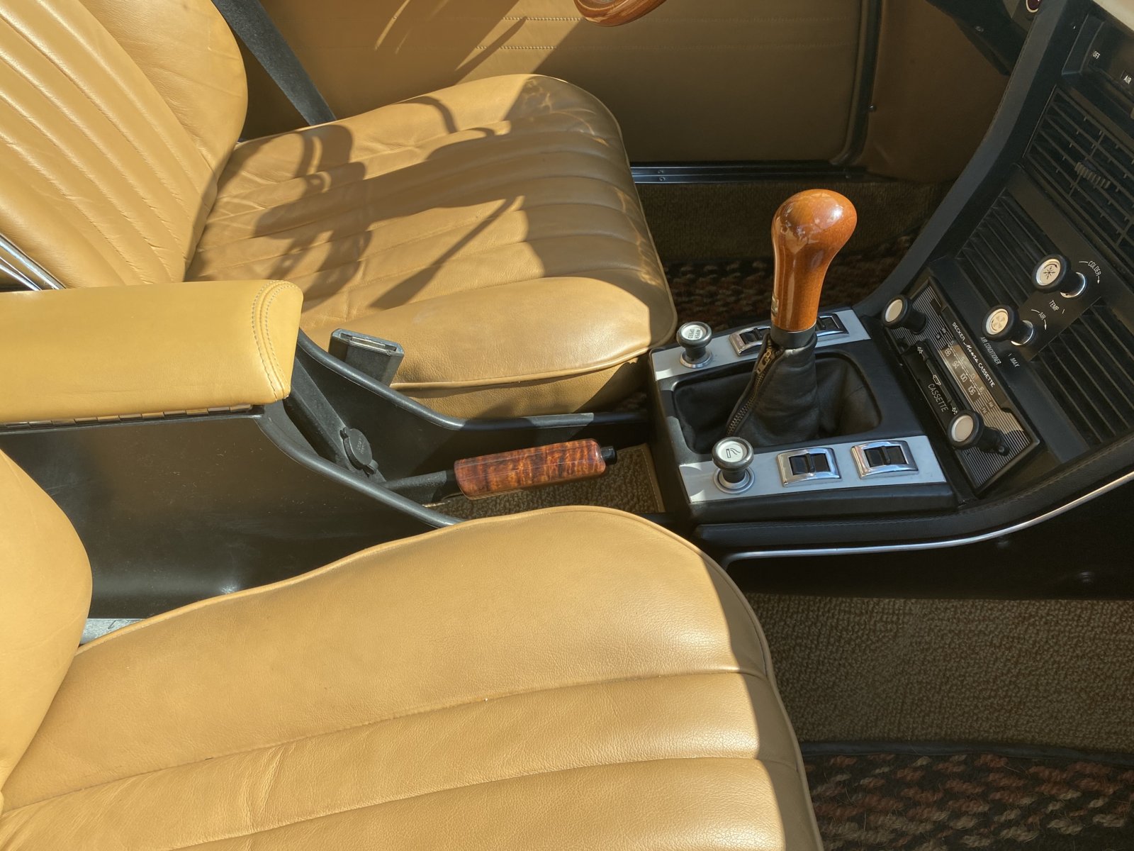

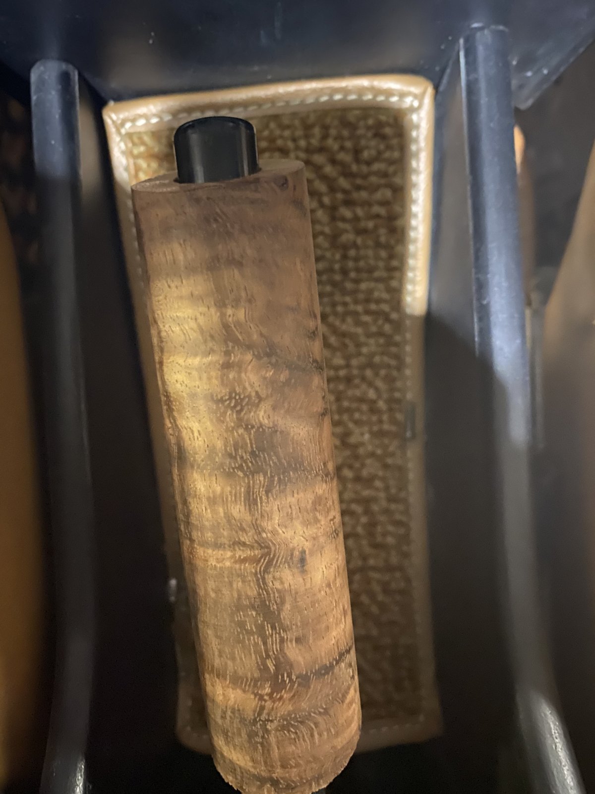

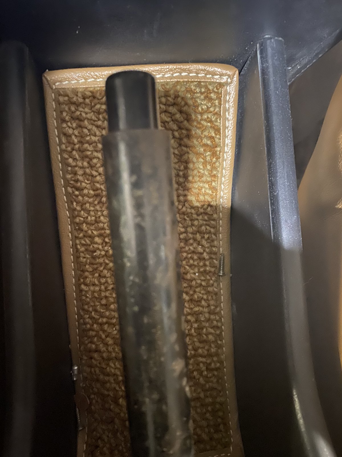

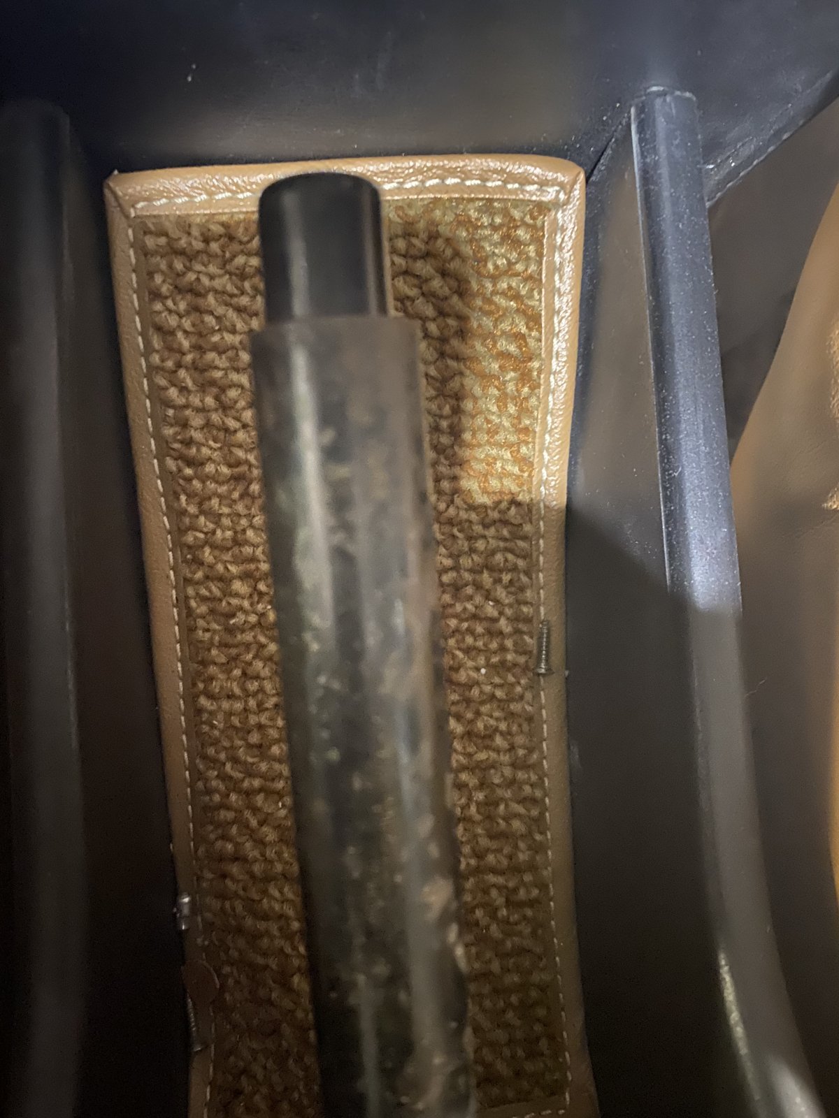

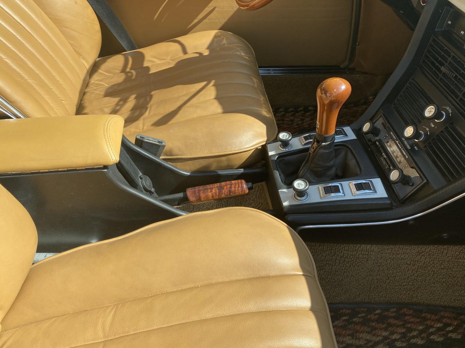

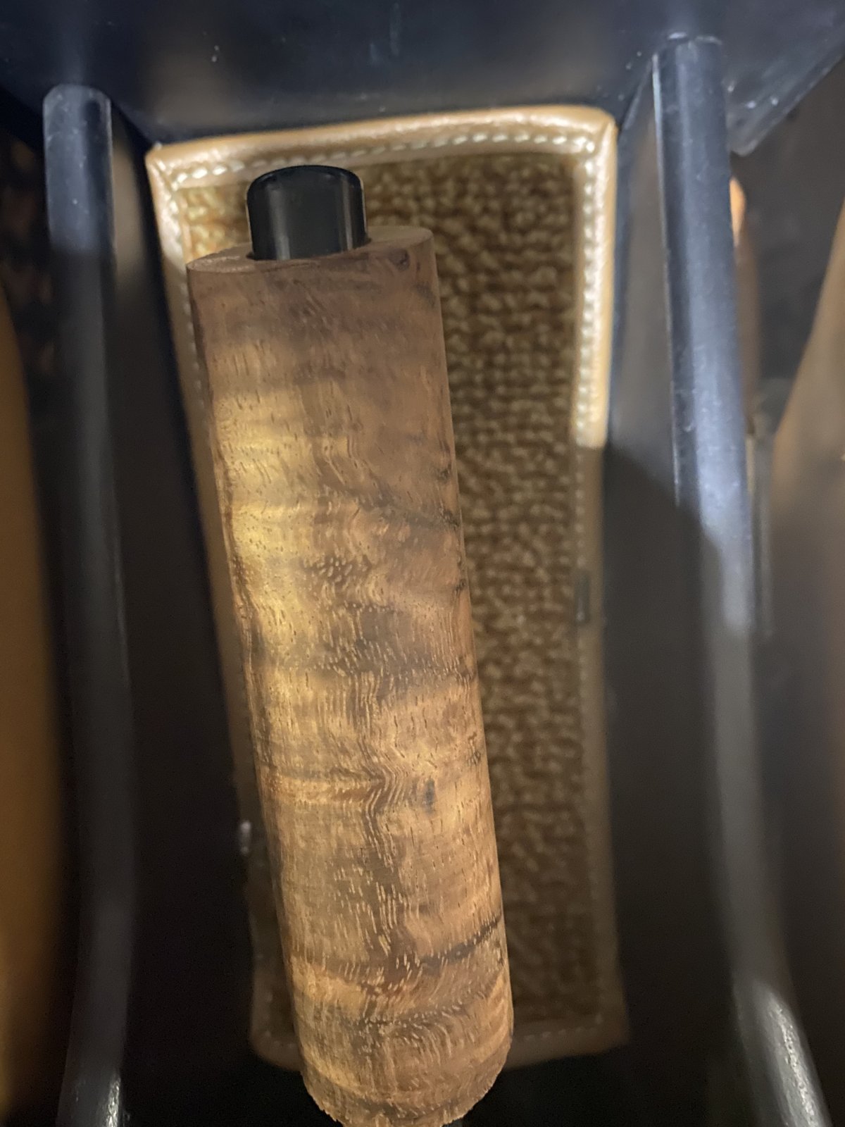

Love the wood e-brake handle!

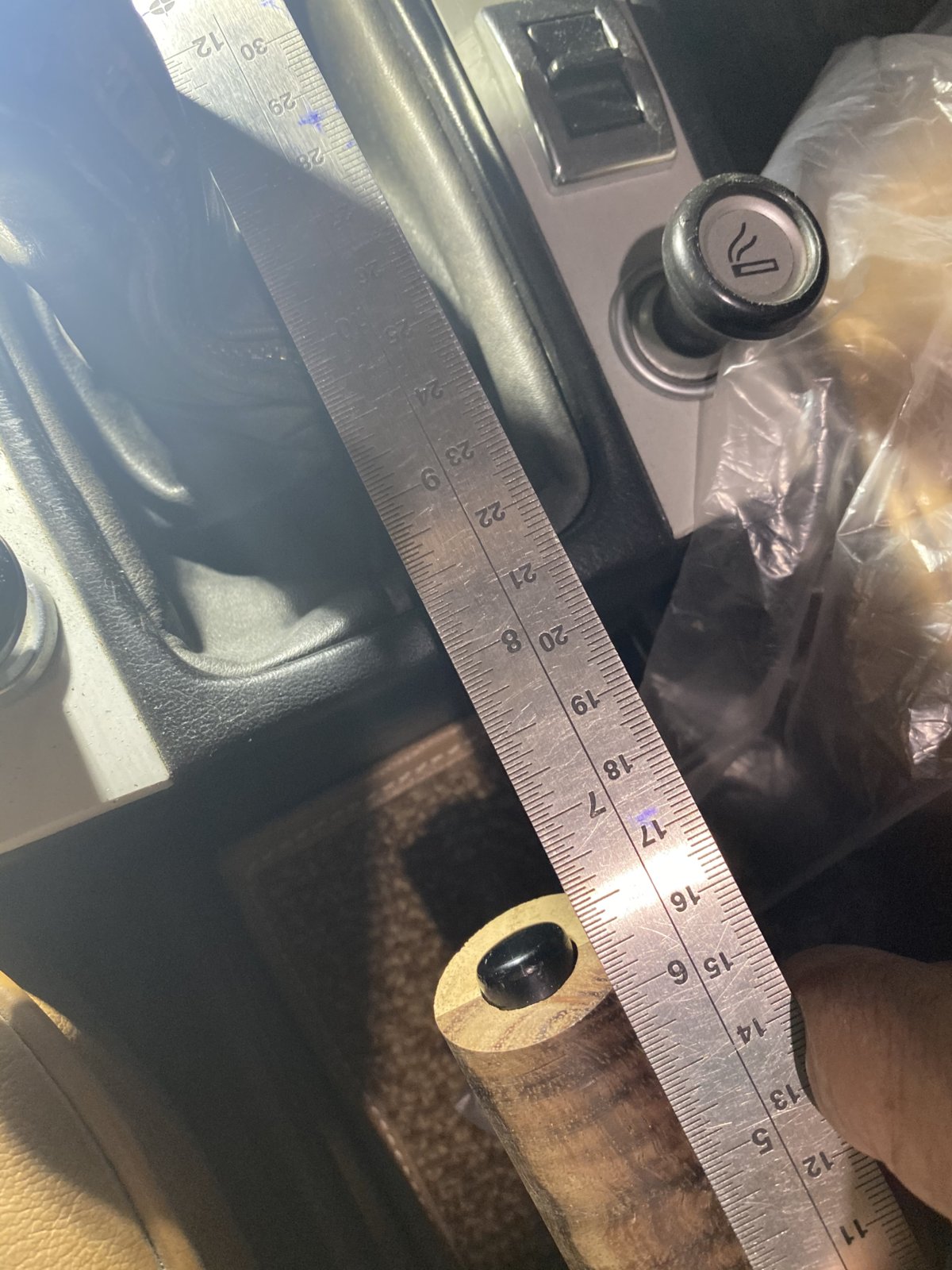

The wood is curly Hawaiian Koa to match the dash. I bought 2 billets of the wood on eBay some time ago. They were glued together and the furniture maker even duplicated the finger grips on the bottom.

I like this armrest idea it is very nice
I've got some Monkey Pod wood from a felled tree from when I lived on Maui. It's not as nice as Koa but I'll make a shift knob and hand brake enhancement and see how it looks.
