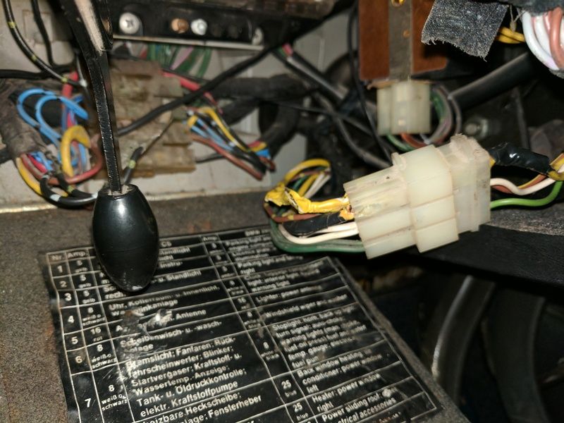

I am assuming the overheated and soon to fail Yellow wire comes from the ignition switch. Anyone know if this harness is available by any chance? God I hate working under dashes.

i think that would be a NO. either find one or replace the wire. yellow goes to the lights. goes from the light switch to the dip switch to the headlights

The yellow wire is the low beam lights. White is high beam. Yellow is thick because there's no relay for the low beams. As you can see, that's a problem.
That's a pretty easy fix, remove the pin from the socket, cut the wire, splice new, add a new terminal that snaps into the socket. The male side is this thing shown below, an extended male spade terminal 'with tab' to lock it into the socket. The female side is even easier to find, typically called a 'relay terminal' for the location you most often find them. The whole assembly is known as a Packard 56 series connector. Used on old GM's. The male terminal also happens to be the same as what's in the side-by-side connectors you find all over the car, but the female side of those is just a plane spade since it does not lock in.

Thanks Layne, encouraged that my problem seems figured out. Wonder if this occurred because my bulbs draw too much, resistance in the circuit, etc? I will redo these with Relays as Steve suggested.
