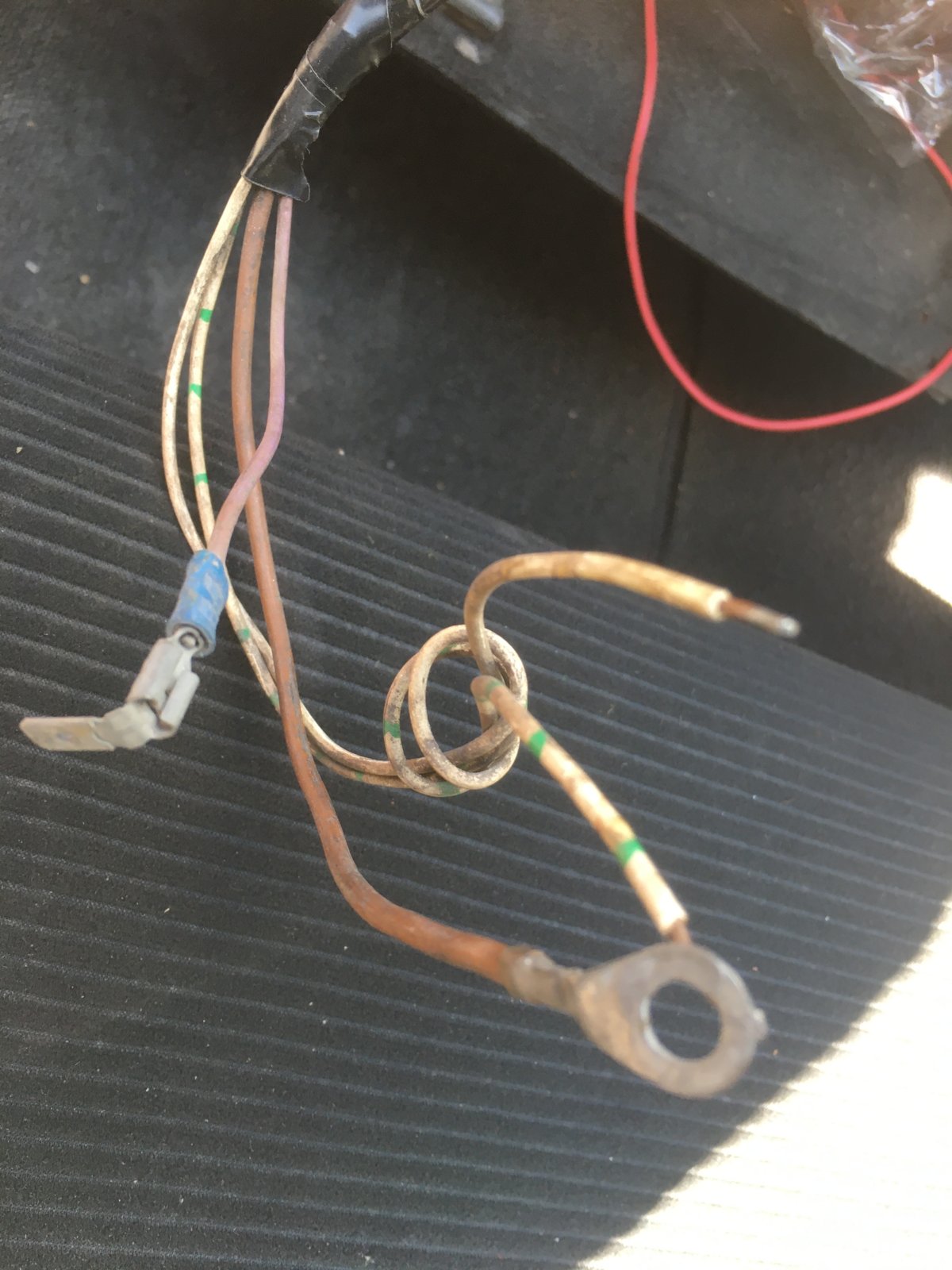

can anyone help I've got loose wires in the glove box as follows.
white with green (soldered end)
white (soldered end)
purple (spade connector)
and a brown (earth terminal attached).
i'm not sure if the car had a sun roof many years ago? removed prior to the car getting in my possession.
i will try to add a photo.

I believe they are radio wires.
67 on the schematic off fuse 10 with the ignition switch.
You can use the brown for ground and the purple for +12.
It should switch on with the accessory and run on the ignition switch.
The 2 wires with stripes could be speaker.

thanks,
i will check that out later hope your right.

Year and assumed Euro, let us know.
Is your glove box light accounted or? If so, then probably, radio wires.
Quick way to establish speaker wires if you cannot follow them back.......turn everything off. Take a 1.5 V battery and apply wires, should get a crackle from the speaker. Also a way to figure which speaker is which if there are multiple.
