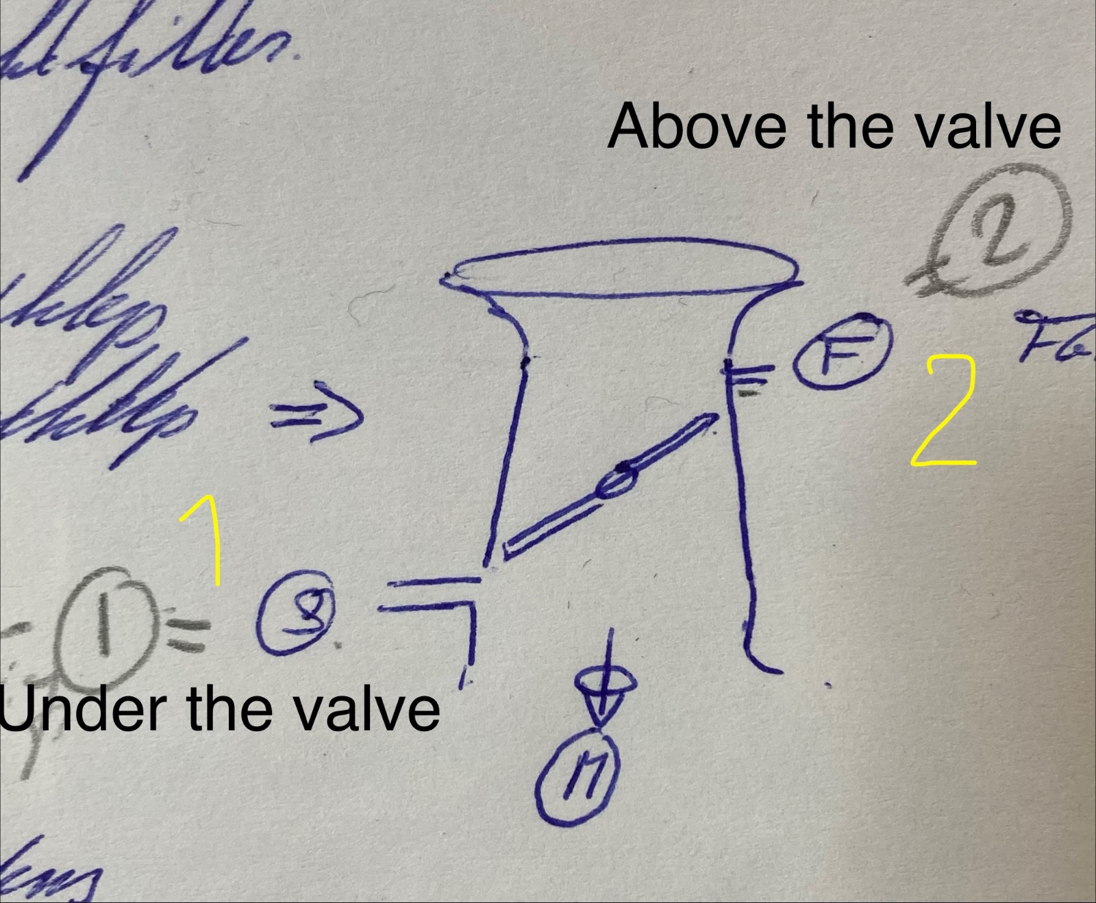

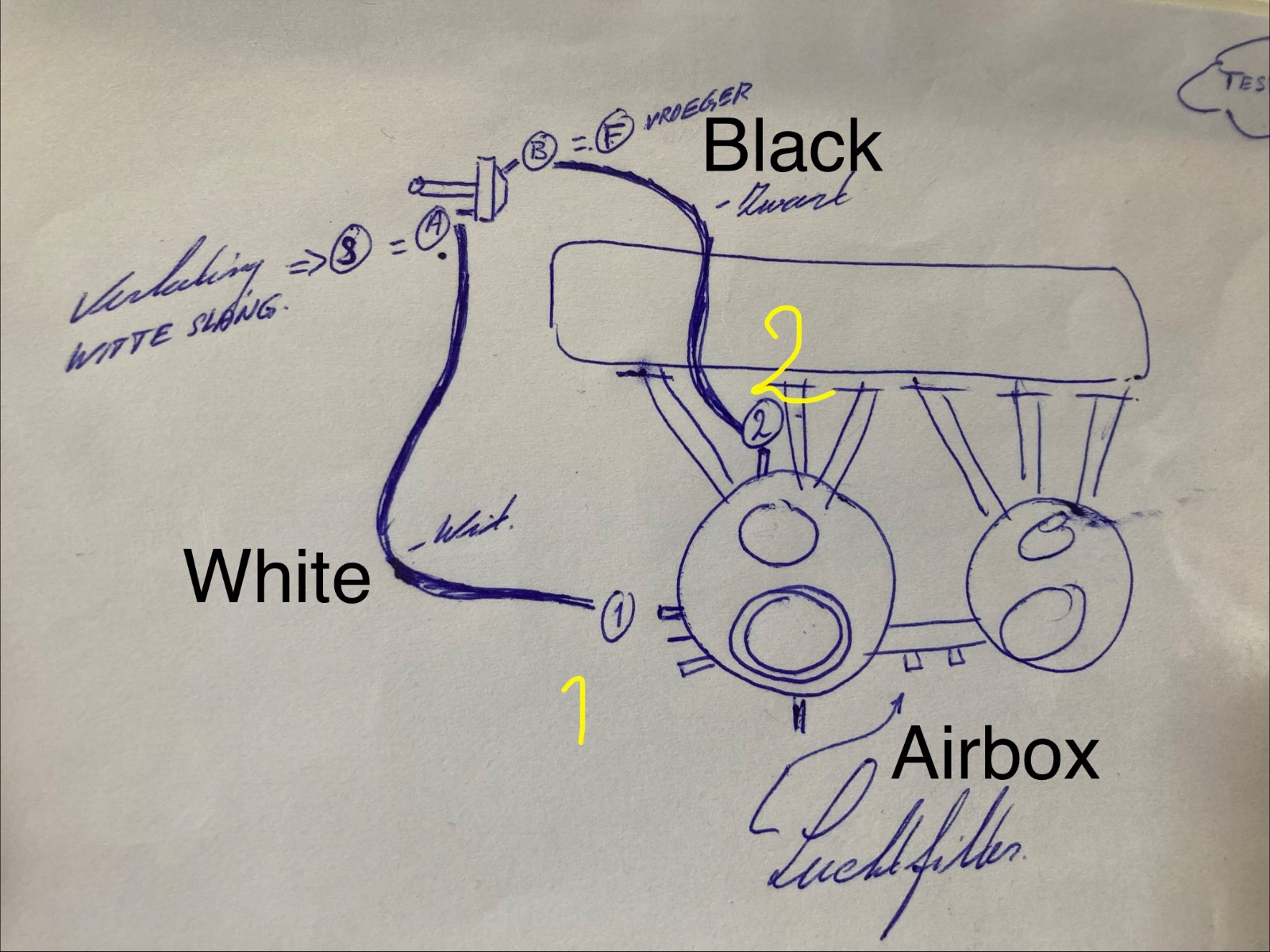

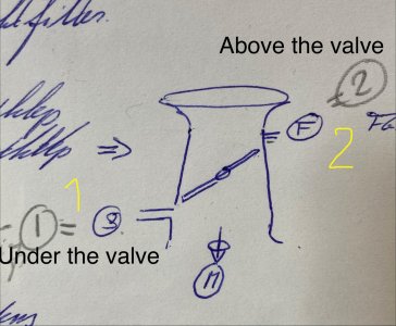

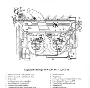

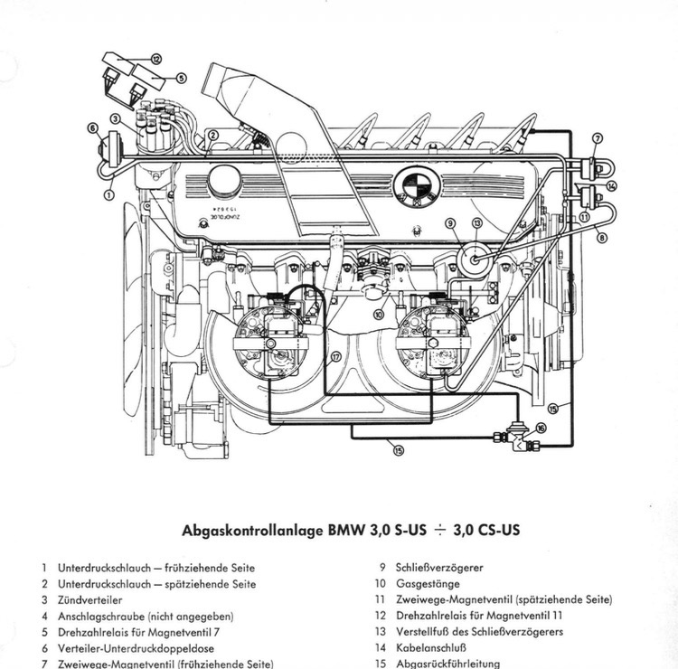

Are the vacuum hoses in place on the ignition retarder? Your description give me the idea there is something chanced with the ignition.
When you accelerate, the engine suddenly receives a lot of oxygen and fuel, causing the ignition to be advanced. This is done by the vacuum that drops when you accelerate, advancing the ignition.
Look for the scheme for your engine. E.g.
My engine hoses look a bit different but I will take a look at them.

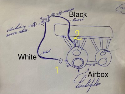

The EU 3.0 CS is the easiest one. Maybe this pictures I made once helps to check.
Appreciate the pics. Seems all is properly connected.
