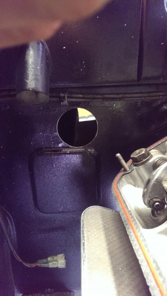

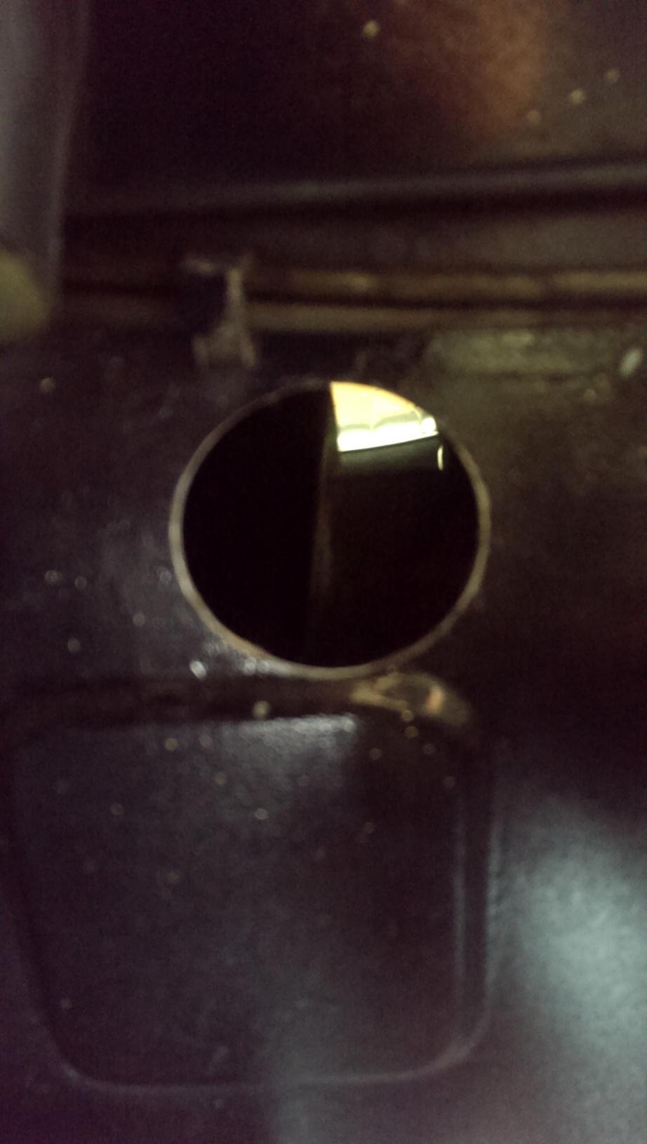

You need a 2 1/8" hole here and mount the ECU above the glove box, closer to side panel is best but you are limited by length of harness. I need to trim back of my glovebox.

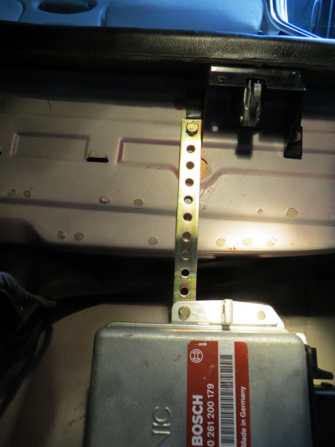

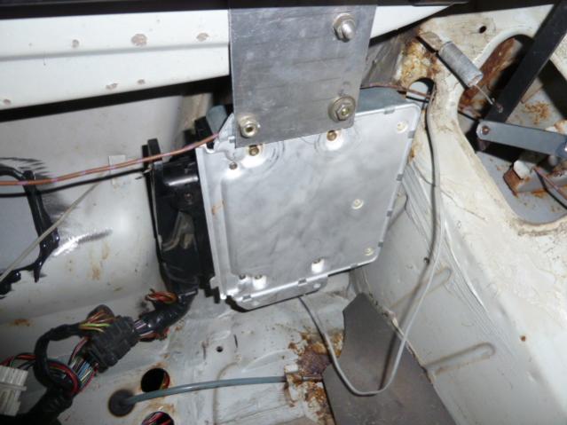

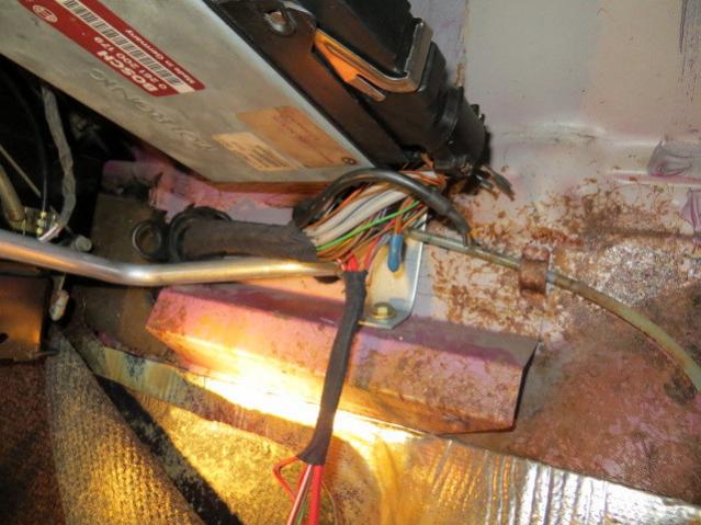

hole in firewall and ecu mount
Here's a couple of pix showing the hole thru fire wall (not mine) and the way I located the ecu... crude but effective.

That is not MY car... Pic was sent to me referencing the hole thru the firewall... I might have gotten that pix from Don L.

For the finishing touch on the hole- use a 325i engine grommet.
