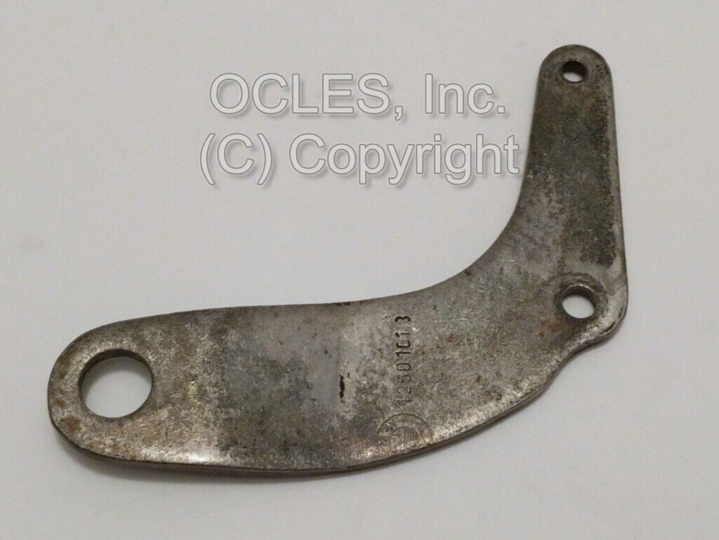

Chris, you mention a lift strap in the front of the head. I haven't looked carefully yet to see what is available on mine is there a common bracket? What do you use on the back of the block or head as a lift point?
There’s a ring in the block above the starter for the back and a bracket mounted on 2 of the upper timing cover bolts for the front.
