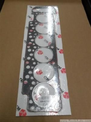

As this is a 34 lower half and a 35 head anything special I should know before I purchase the gasket?

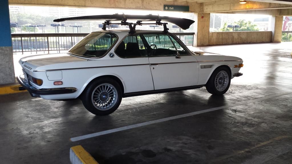

That is the second coupe I have seen with a surf board on top!
The first being Charlie's
Not sure if I would allow salt water that close to my coupe.
There are two head gasket designs... Any suggestion of which one is better?
