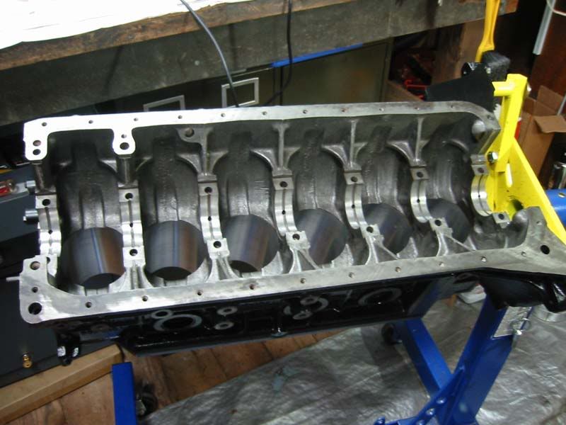

So there is some hope left?
Are these the reliefs I'm looking for?

you've got it
Yes that's the right block with the right notches, stick in the boring bar and hog it out, you can do expensive ultra sounds and all of that, but generally speaking, german engine blocks don't have much core shift during casting. Also don't take too big of bites with the boring bar as these blocks are tough(high quality cast iron).
