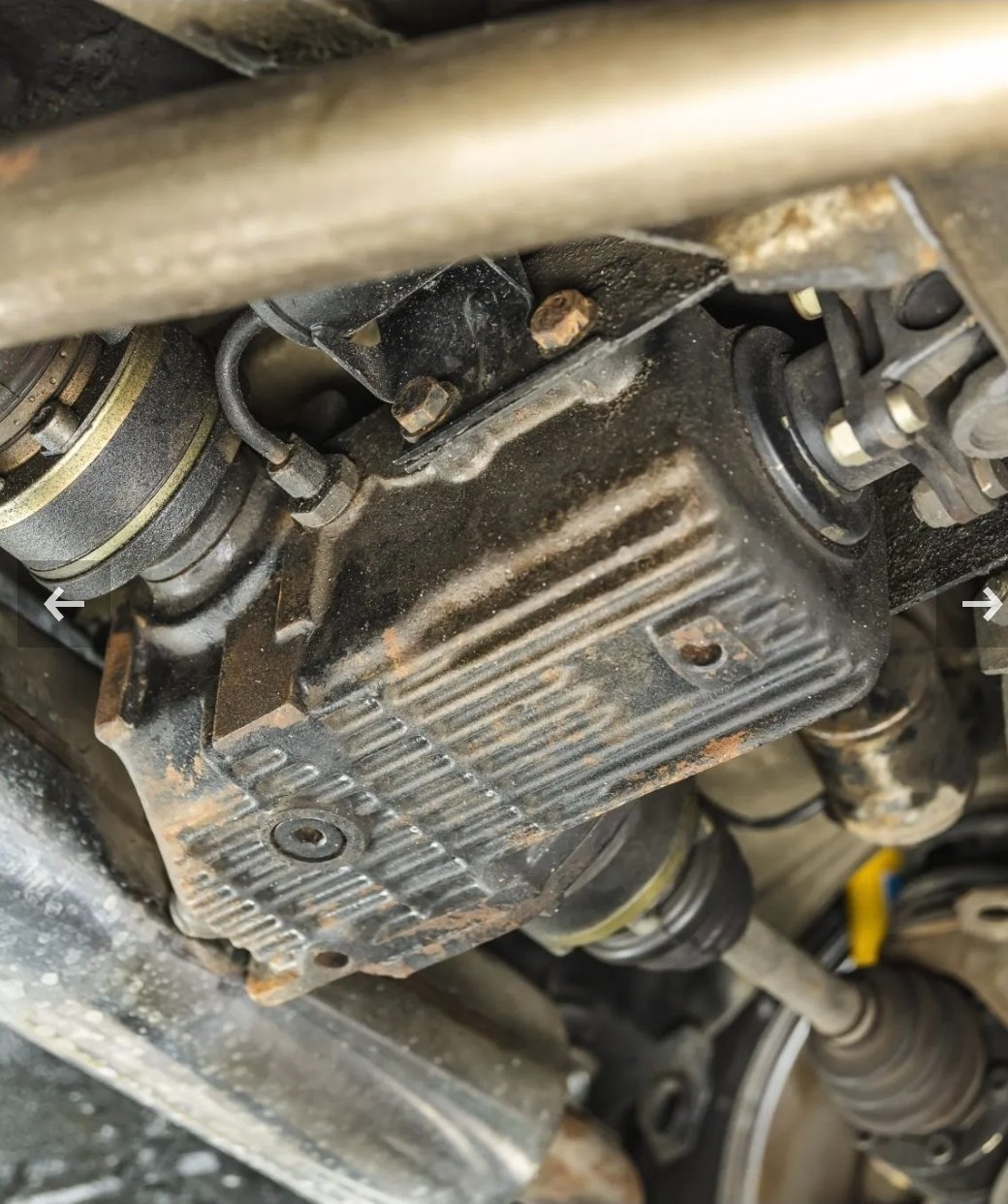

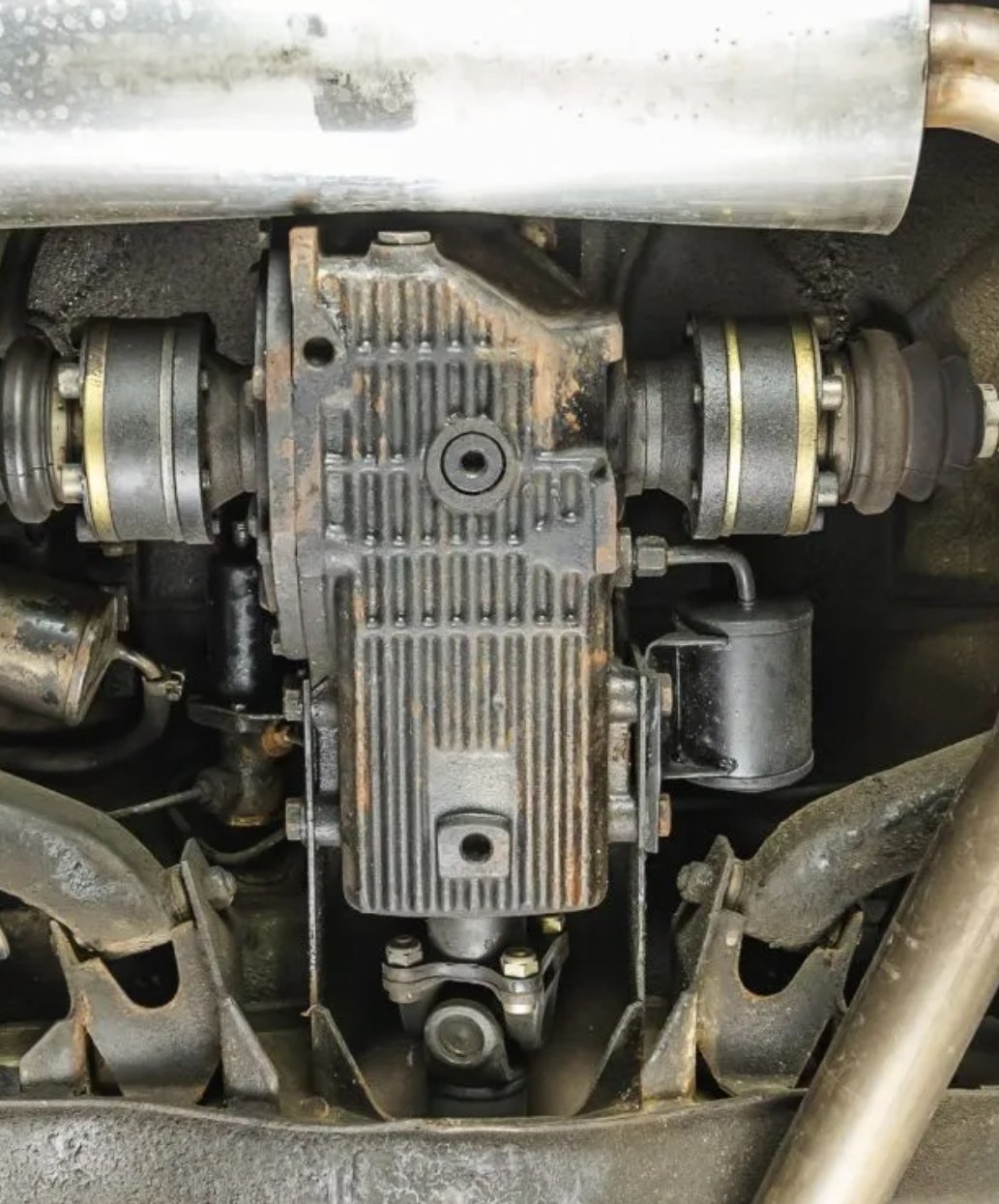

Anyone guess what is going on with the top of the Radiator?
Was that the reason for new motor mounts and tranny mount?
Diff with additional oil cooler.
So, would be an LSD?
