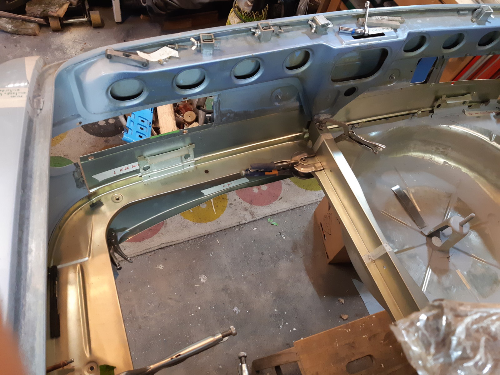

There is a small plastic funnel ( which I have) that fits into a hole and is used to vent the filler neck in a Euro car below the bumper. Is this the hole in the center of my image....which was covered during a repair?
Italian csi pic for you

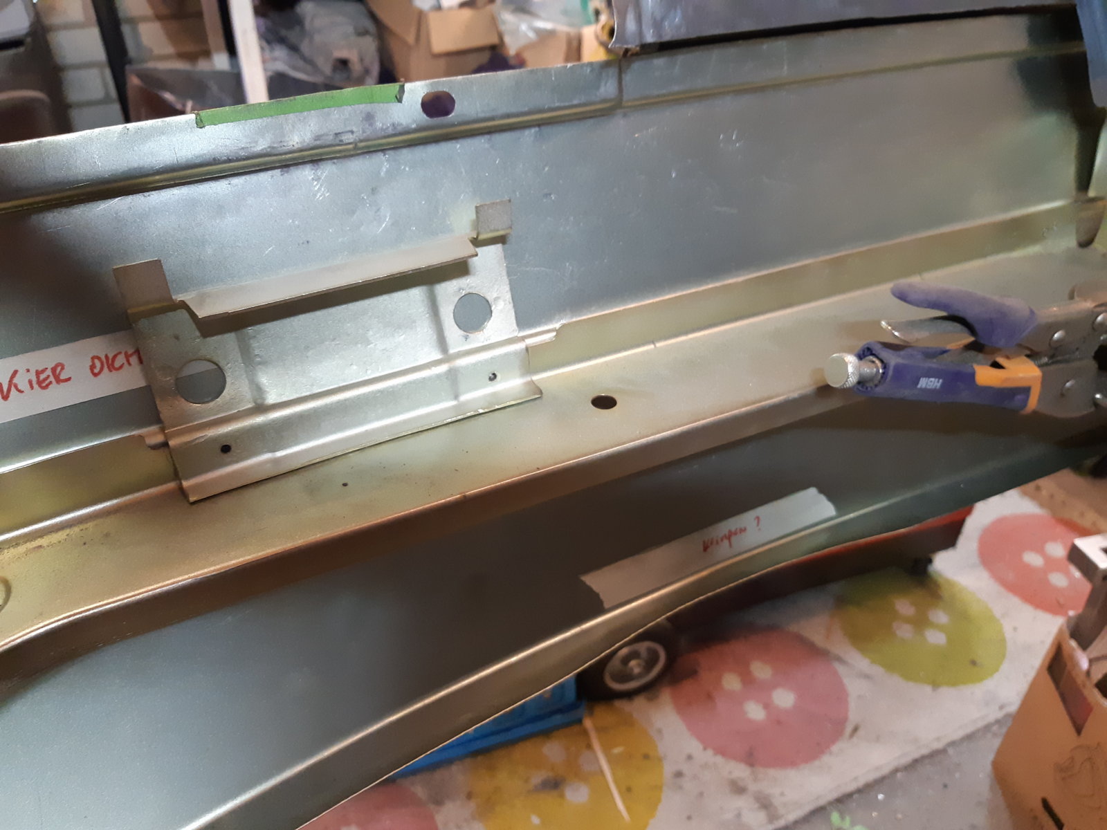

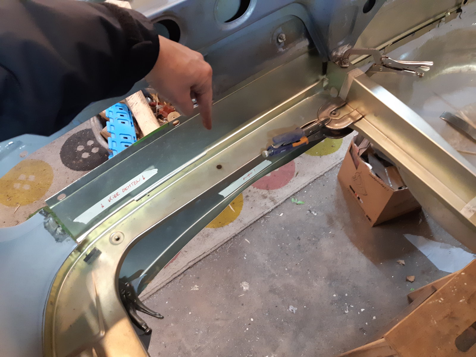

Yep, your pic is correct. Here it is in a fresh walloth panel. It goes through the floor panel. Mind you, the bumper reinforcement is not yet mounted in the first pic.
