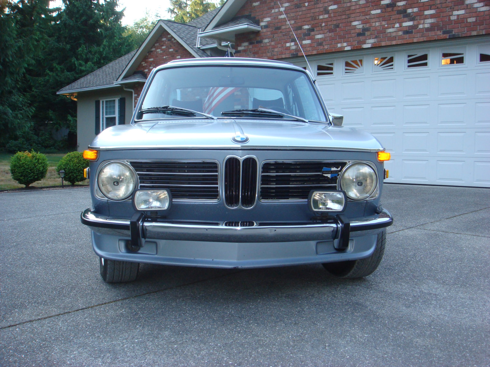

I installed Cibie BOBI headlights (with 70/100W H4 bulbs) paired with Cibie OSCAR driving lights with 100W H2 bulbs All was powered using relays with new wiring made so the driving lights came on with the high beams (or they stayed off). Had lots of time driving on the twisty back roads at night - and LOVED it. See pics... I know the shape of driving lights aren't everyone's favorite - but for me (and my college budget) - they were great.

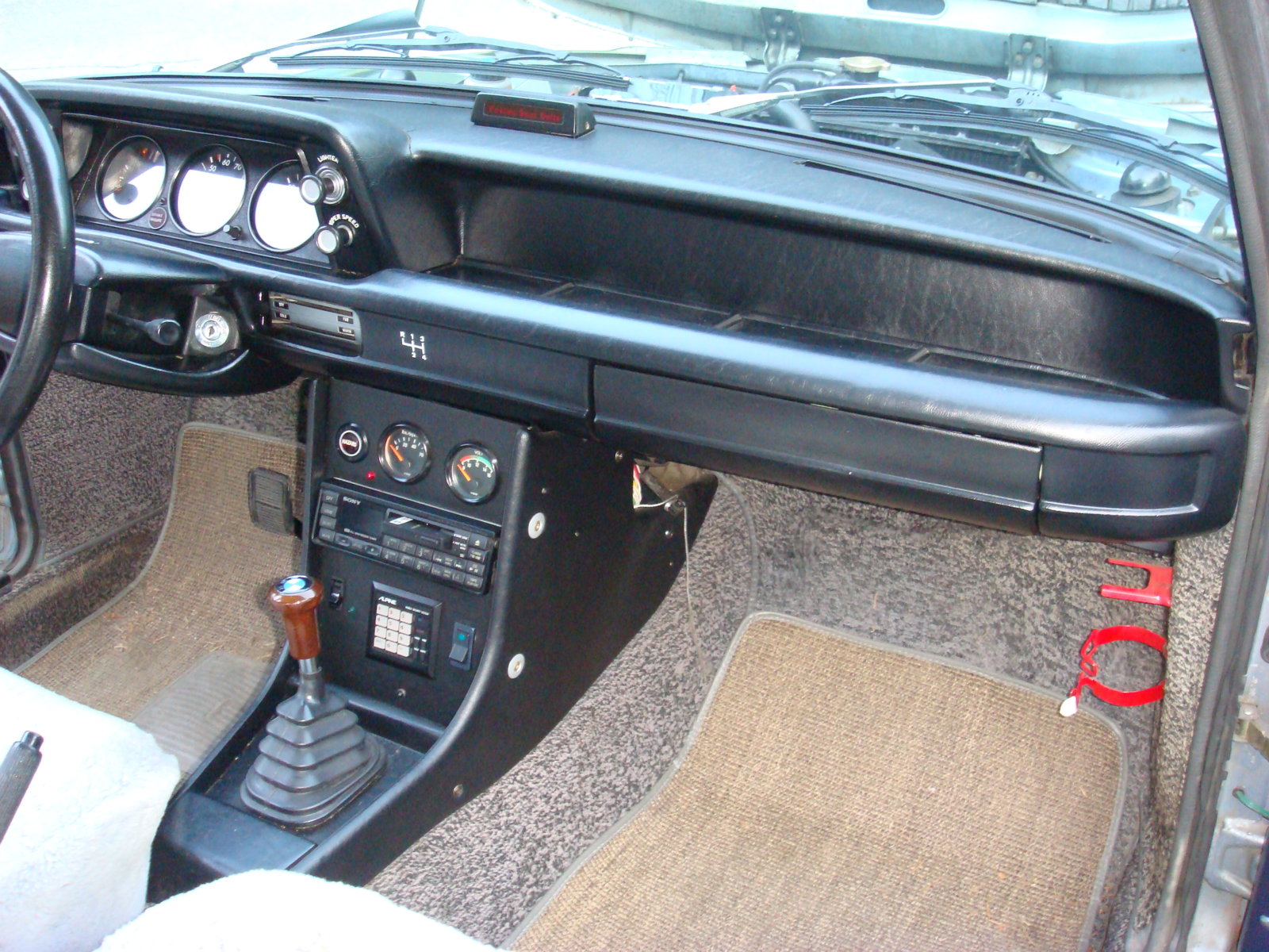

You can see the console I had in the car as well - the switch on the right was for the driving lights - the switch received power from the high beams. When on, that power then went to the relays for the driving lights (or if the switch was off - no driving lights with high beam).
That being said - With 400W and my stereo and windshield wipers and ... whatever... pulling from the battery - the headlights sometimes kept time to the stereo. LOL
My next step was to install an alternator out of a 320i (E21) with internal regulator (and a boosted regulator at that - so I was putting out ~70A or so).
The load was managed with that new alternator - no prob.
That complete set up worked great till I sold the 02 a few years back. I wish I kept that car... But I hardly ever drove it after I bought the Coupe... Still... I do miss it. Such a fun and tossable car.
So - for me, while I don't expect to drive the car all that often at night - when I do, I DO WANT to have very good lighting...
SFDon is taking care of me that way for the Coupe. :)
YMMV as always...
Cheers

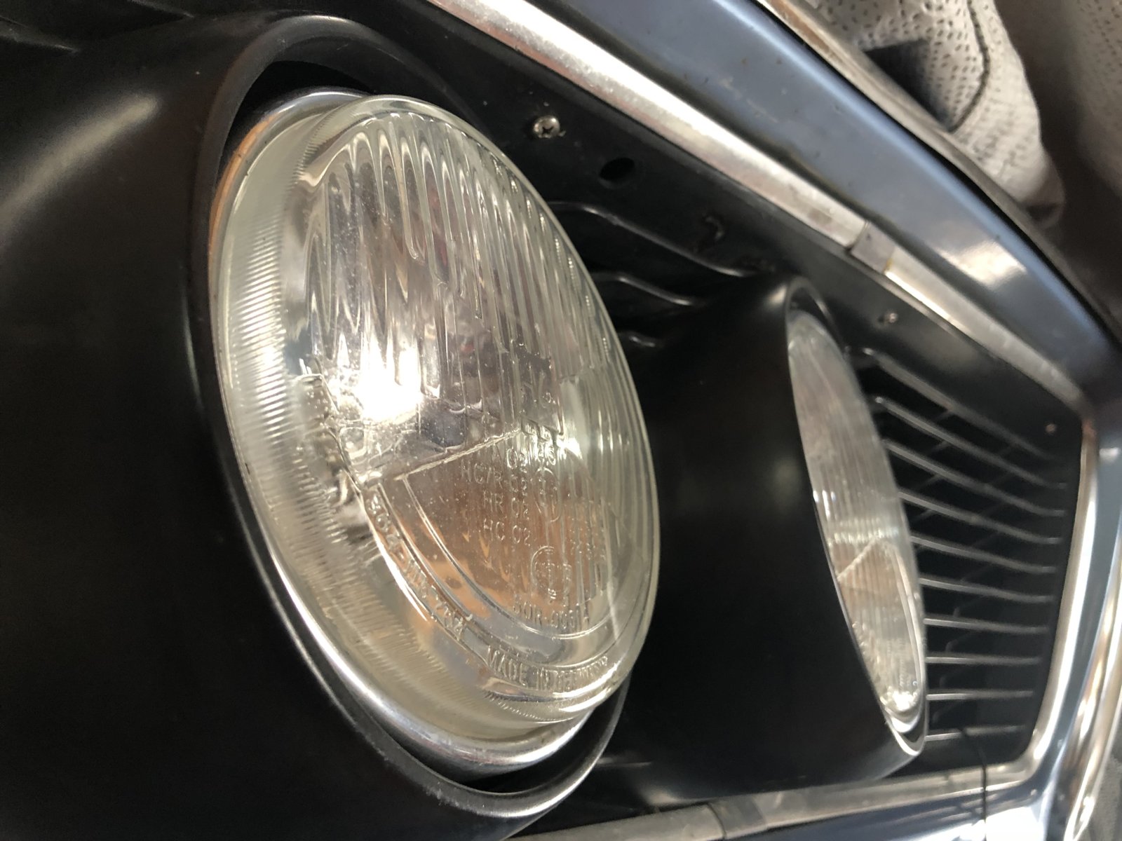

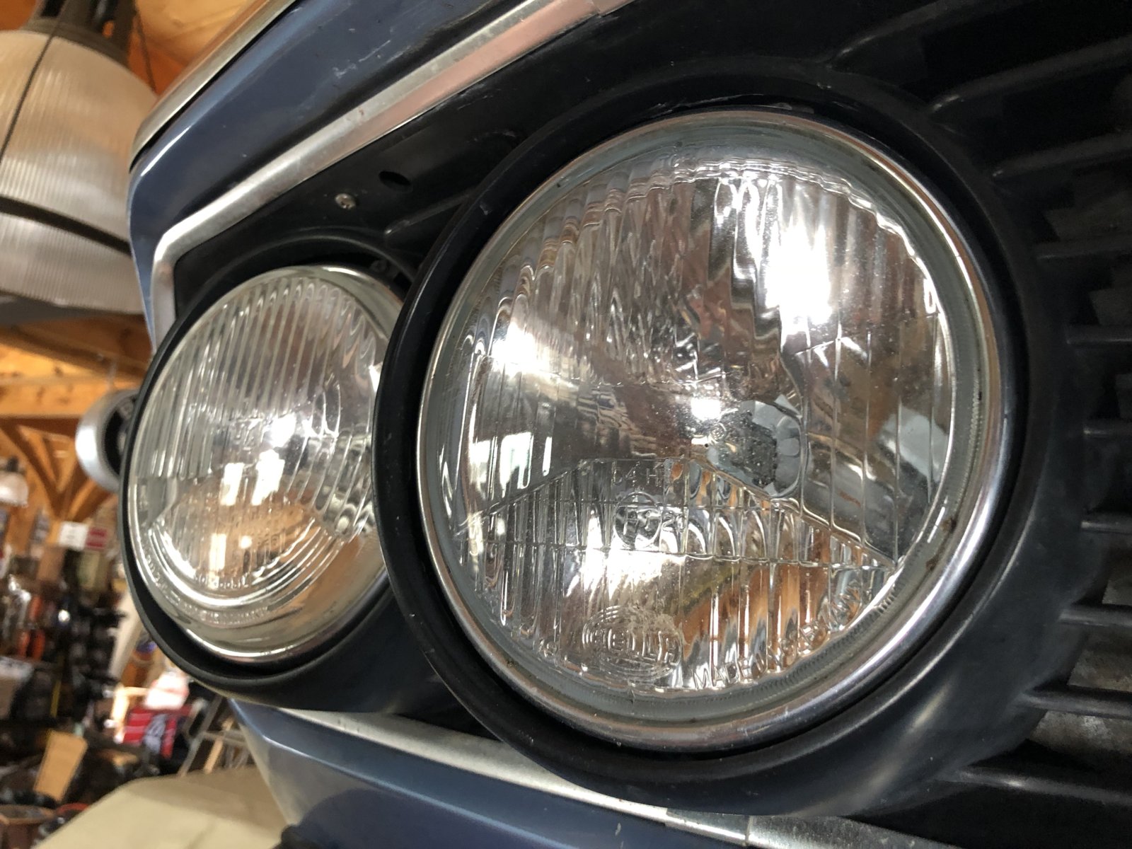

I bought the headlights from Daniel Stern a few months ago but he didn't have many old sets left.

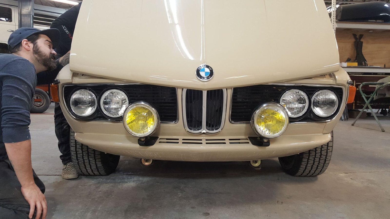

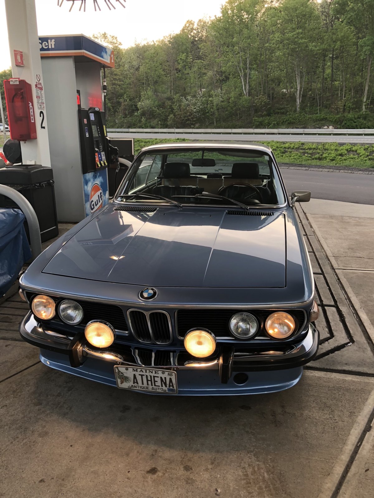

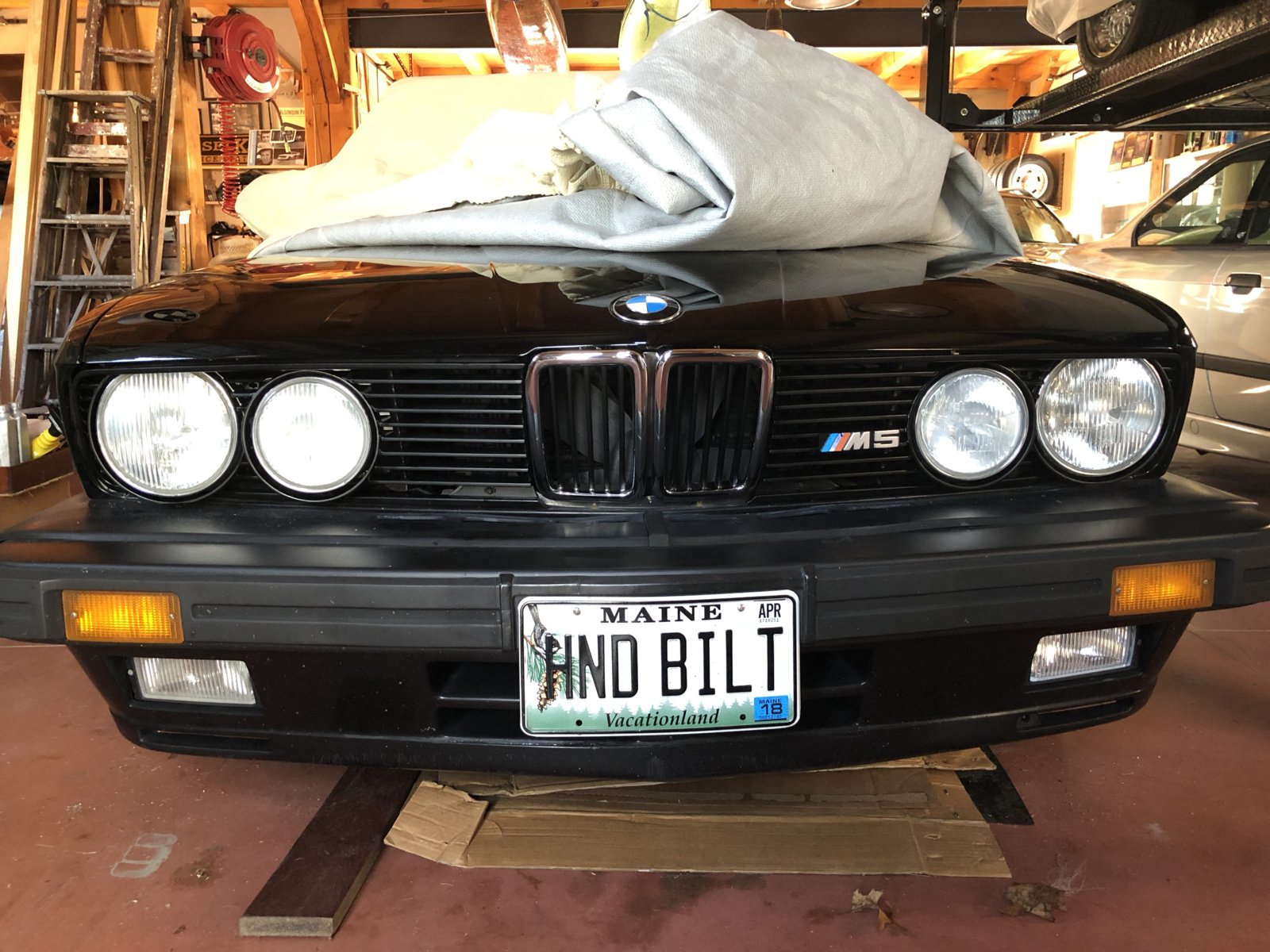

Converted Athena in 2014 to H1/H4 with city lights from sealed beams. Her lights are as good as our 2007 & 2014 BMW X3's adaptive Xenons for brightness & clarity. Of course VSR handled the relays & installation.
Also converted Vern the Tii from sealed beams to H4 with city lights as well as Rodney the M5 to Euro lights also with city lights.
Lens covers Clean Grills2:3:18.jpg
