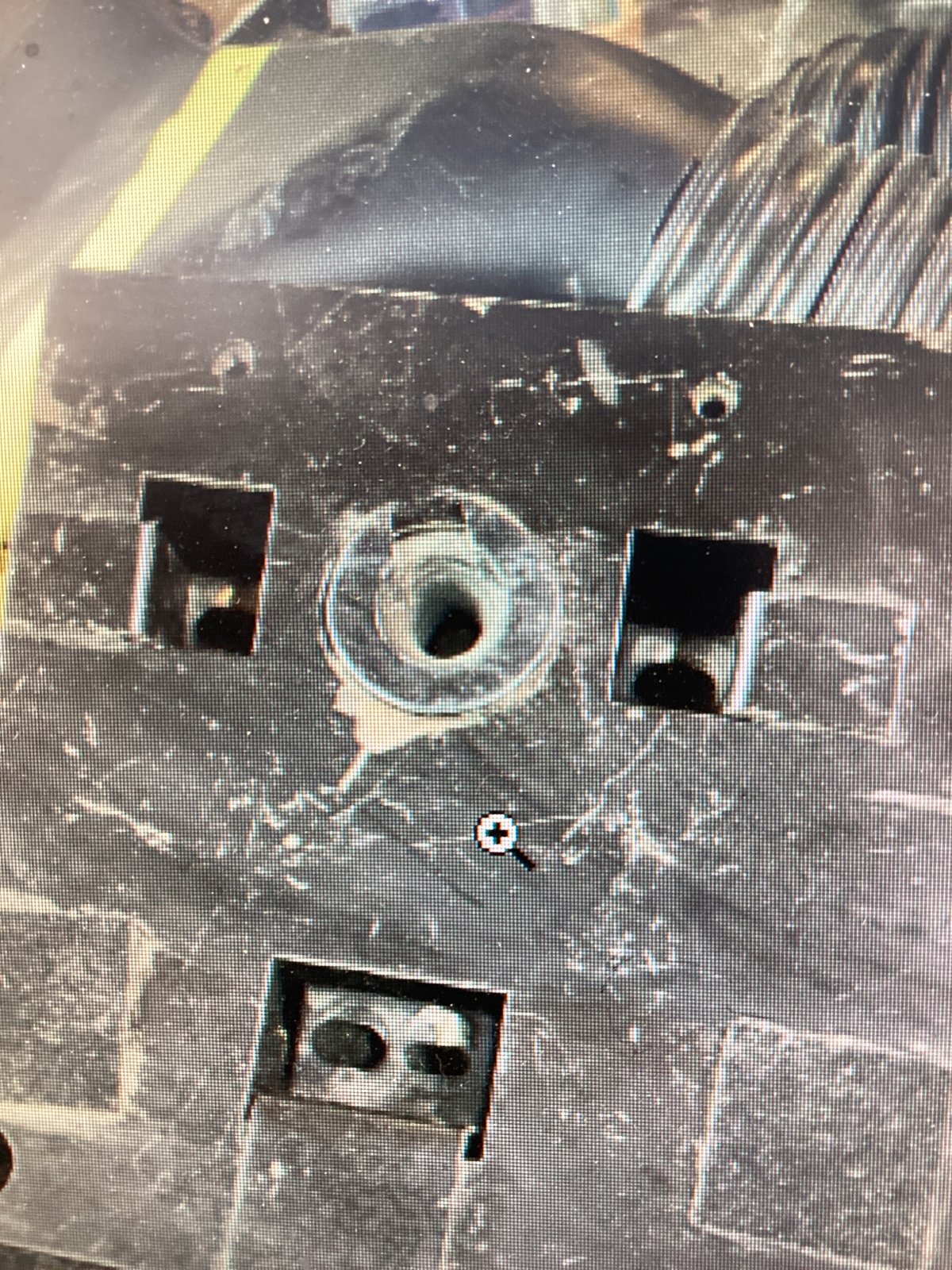

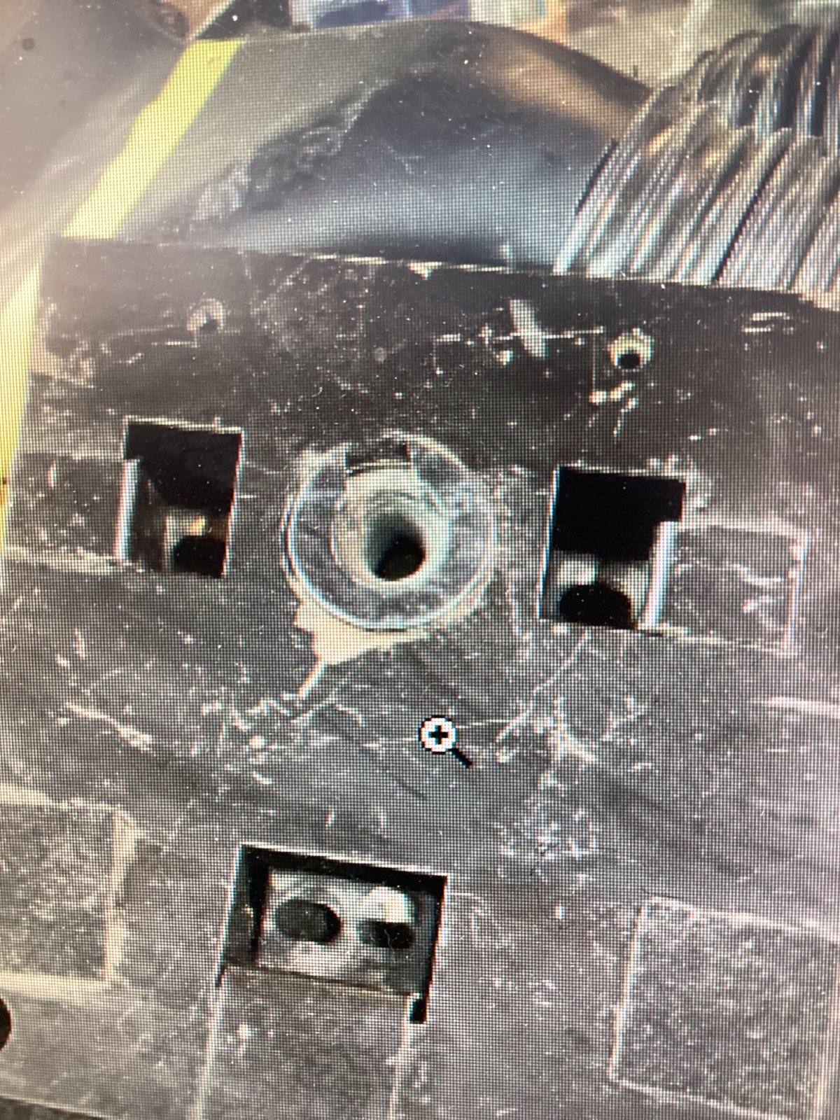

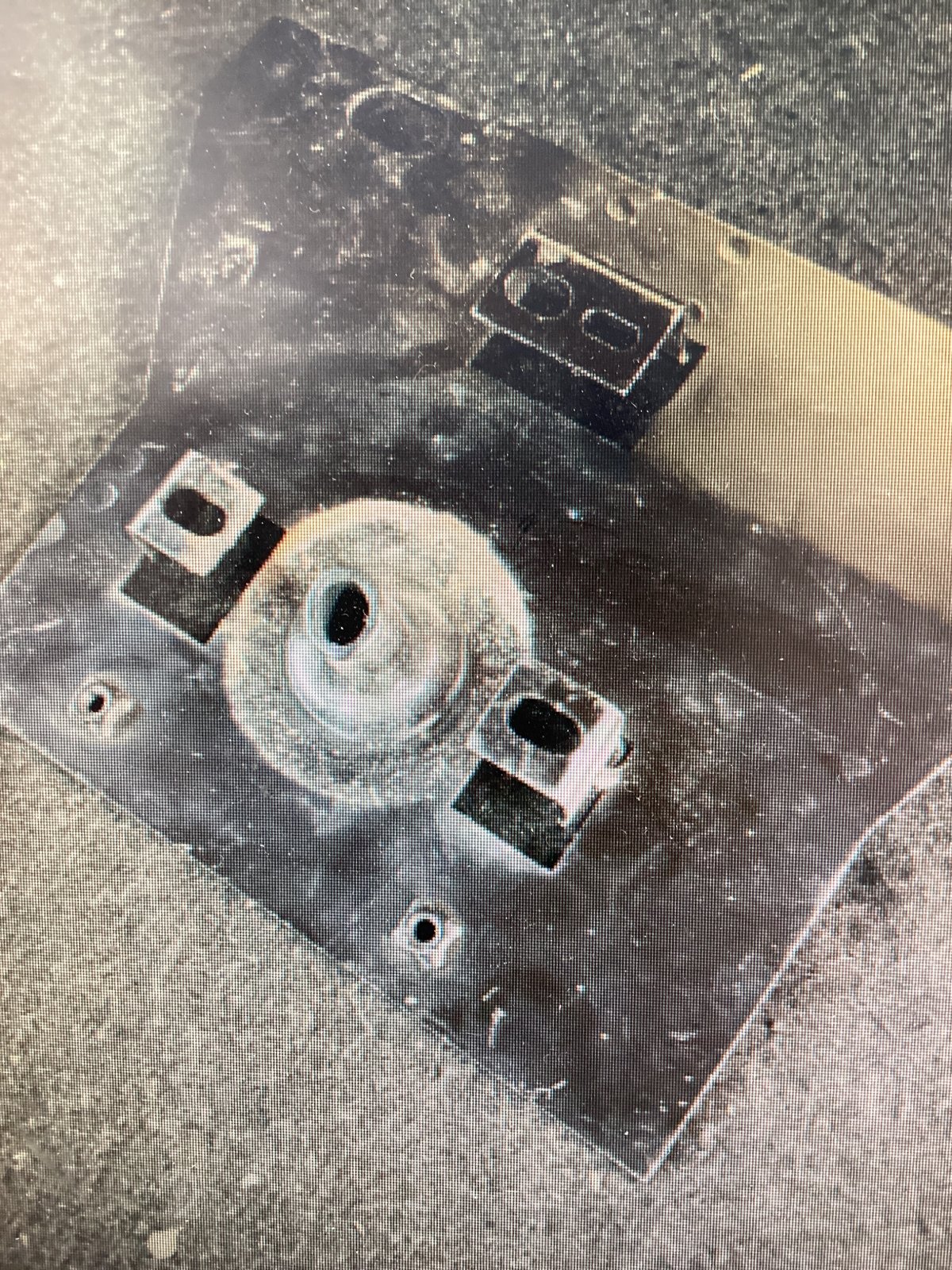

I need help with some pictures of the evaporator drainage hose. It is missing from my car, so I would like to find or make a hose for the drainage. I would like to know it size, material and doeofs it come outof from the floor of the car?

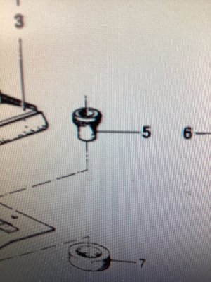

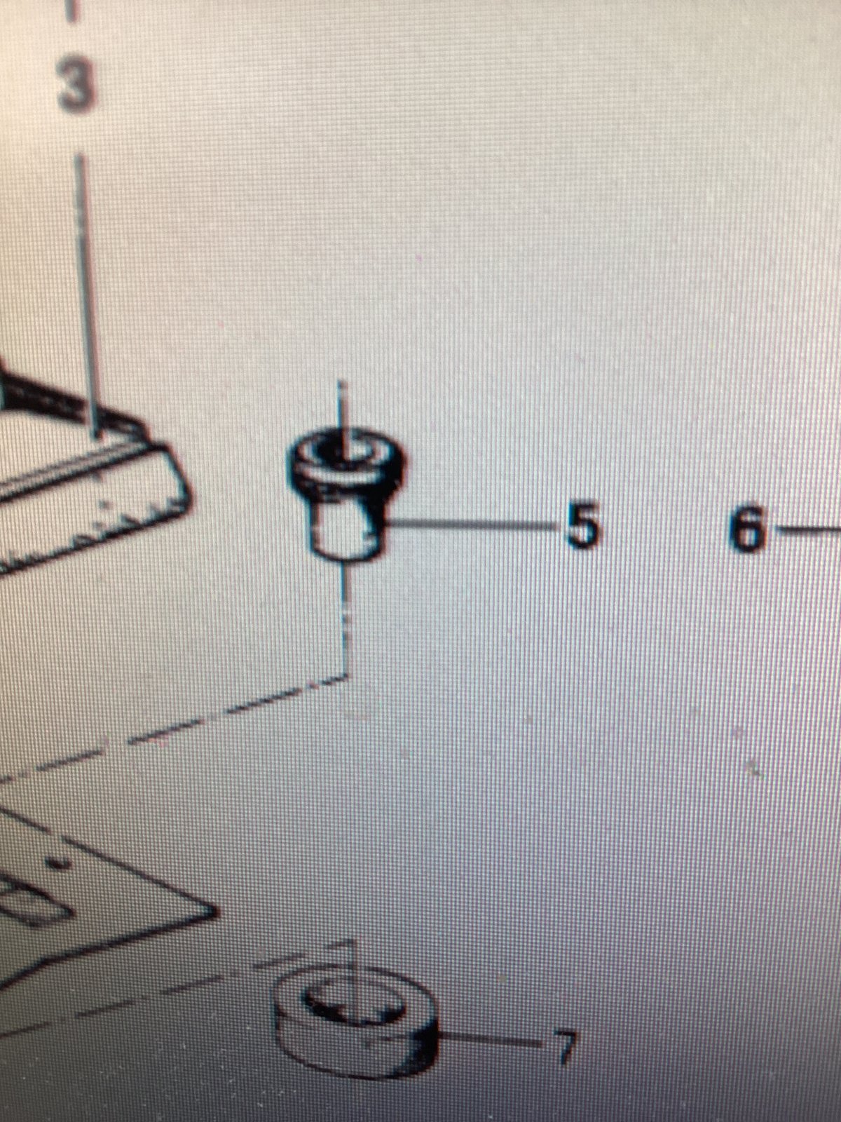

No hose…just a sealing grommet

I glued a short hose into the drain hole of the evaporator enough to clear the tunnel when installed so no chance of condensate staying in the car.

I used a small plastic funnel and it hasn't leaked.

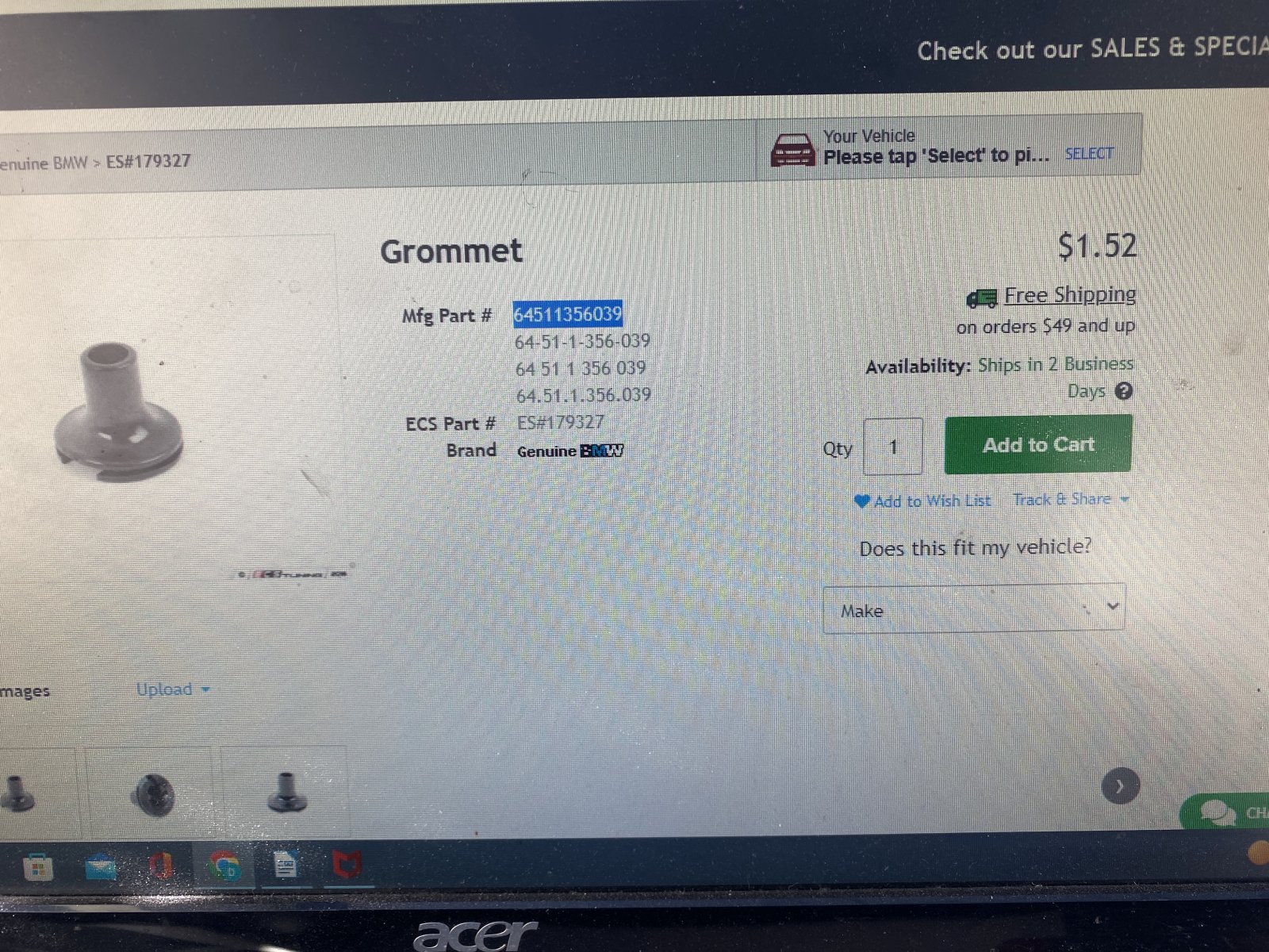

I ordered the grommet if I ever need to take the evap out again.
