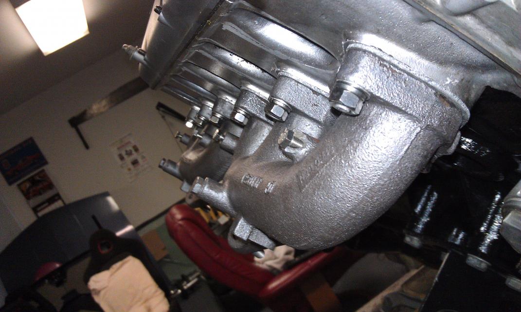

I used hi-temp paint marked specifically for exhaust systems, I was just looking for the "metal" color as opposed to the "rust" color that came with the car. For the manifolds I used Eastwood stainless steel coating, which is supposed to have "steel" in it? who knows but I have had the car running for probably four hours and so far it looks new, also the "high temp" paint I used on the header pipes is holding up well. Regarding the prep, if you use an abrasive layered sandpaper pad (I don't know the proper name for them) on a grinder you can get those pipes right down to the shiny metal and it was really easy, took no time at all.
Just my results so far- Good luck
