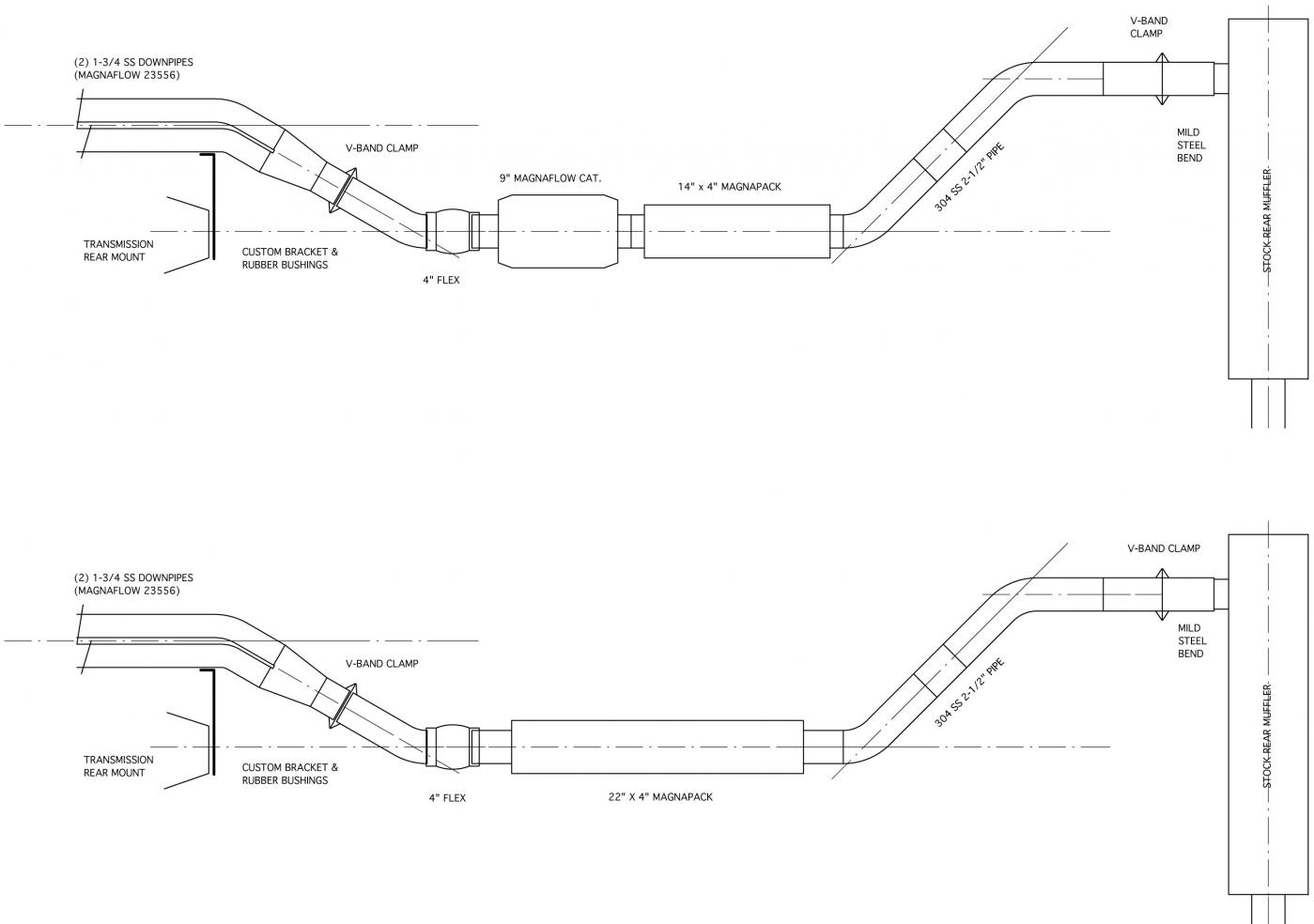

So my question is, exactly how should the center portion be set up? Attached are plans of two options: with and without a catalytic converter. My understanding is the cat. has very little restriction on the gas flow (and hence a potentially positive upside - cleaner exhaust). This however would require using a shorter center resonator. The cat. does contribute to the quieting of the exhaust some, so that may offset the shorter resonator. I may ultimately have to try both setups, but would rather not. Part of me says go simple and use the 22" resonator sans cat., the other, eco-friendly in me says otherwise.
Any thoughts on this?

Hi Sven,
I think I would start with opt 1 sans resonator - you could always add it after if too loud. Add the resonator and it's probably very close to the stock 3 pc system in sound level and that is pretty quiet. Cat plus magnaflow rear is close to what I'm planning.
I think your opt 1 - cat plus rear muffler - wouldn't be much louder than my current stock resonator and rear muffler which is quieter than the intake sound of either the 38/38 webers I had or my current EFI with cone air filter. At idle all you hear is the intake. Floor it and the intake and exhaust are about equal.
I really like what you've done with the magnaflow downtubes and merge. Wonder if I could weld the cone flange ends to that for the b35 exhaust manifolds I have?
Keep us posted on further developments please,
Doug

When I was part of the exhaust group buy years ago, I opted to swap in a straight 2 into 1 pipe for the resonator. It is loud, like I can hear you before I can see you loud so I'll bet you'll want a resonator. Every year, I say I'm going to get a resonator, this may be the year.
Also, don't count on the cat to have any real effect on reducing the exhaust sound. I took mine off my E28 5 series and it had no effect on sound at all.
Good luck with what you choose!

Doug - For the downpipe compatibility I think it would depend on the drop angle of the manifolds being close to the same. Obviously they are spaced fore and aft the same. The Magnaflow pipes have a section of about 2" from the flange down where they are parallel to each other. Below that the pipe angles are different.
Tod - Interesting, both the muffler shop and the Magnaflow tech guy say that the catalytic converters do have an affect on sound. The tech could not (or would not) quantify anything since they do not measure the cats. contribution because it is not intended for sound absorption.
I was surprised as well. On my E28, I removed the stock downpipes and cat and replaced both with Bavauto headers into an X pipe and then dual straight piped back into the OEM resonator and muffler (no cat).The exhaust tone is different due to the headers, but not appreciably louder than stock.

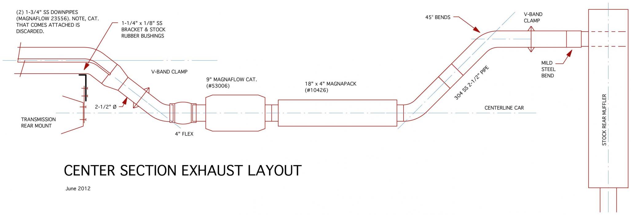

Final plan of center section:
