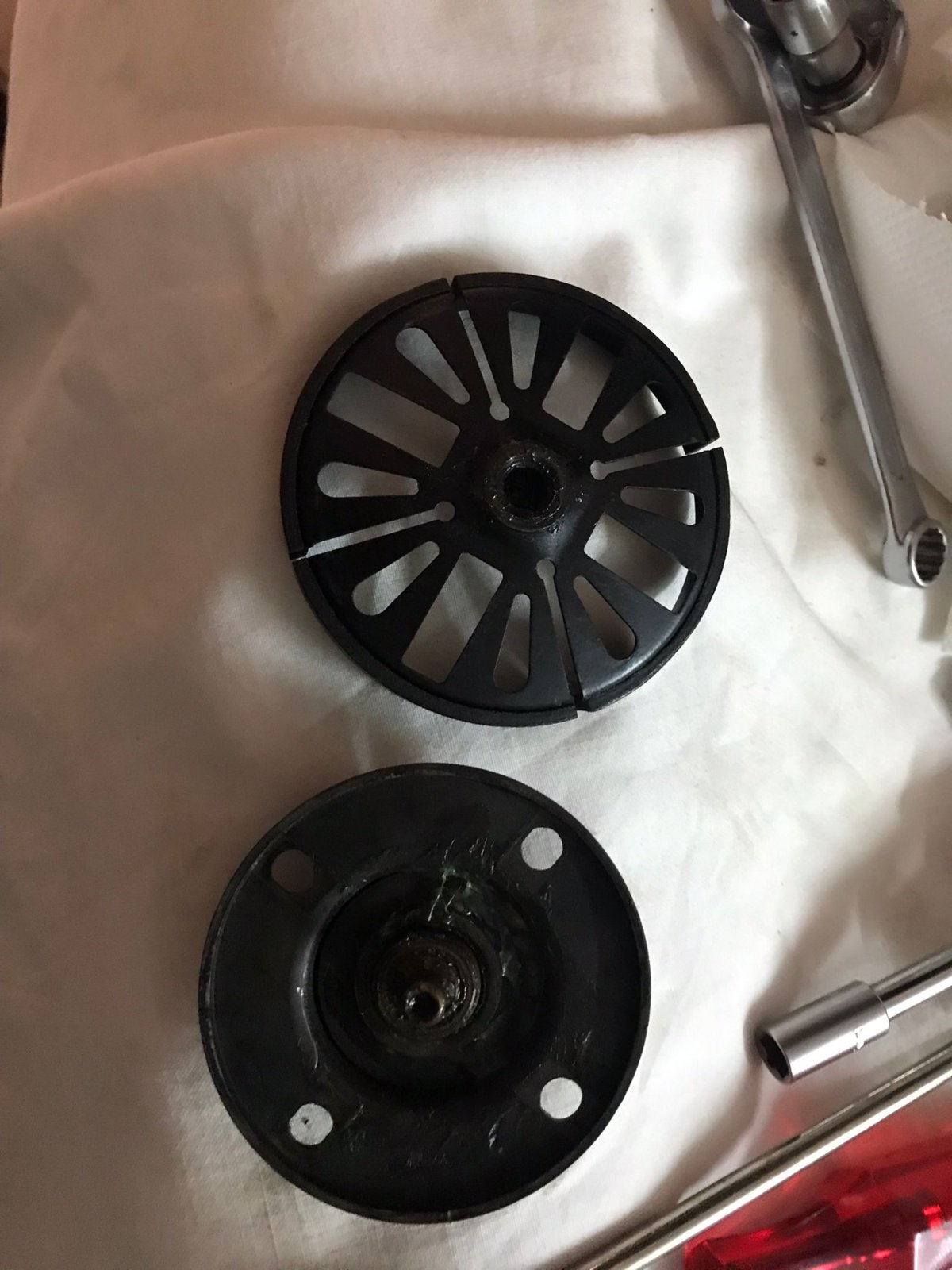

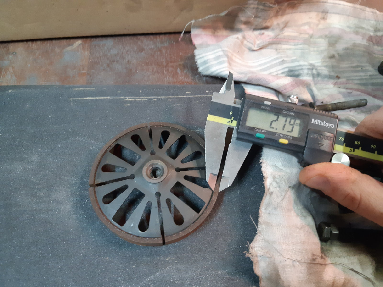

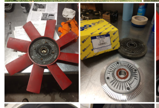

Just to answer my own question, in case another forum member may searching for thesame in the future:
Yes, the old style friction clutch can be recovered. User Dequincey did it. In my case it wasn't necessary as the thickness of the friction material is 2,7 mm which is same as NOS condition.
See picture.
