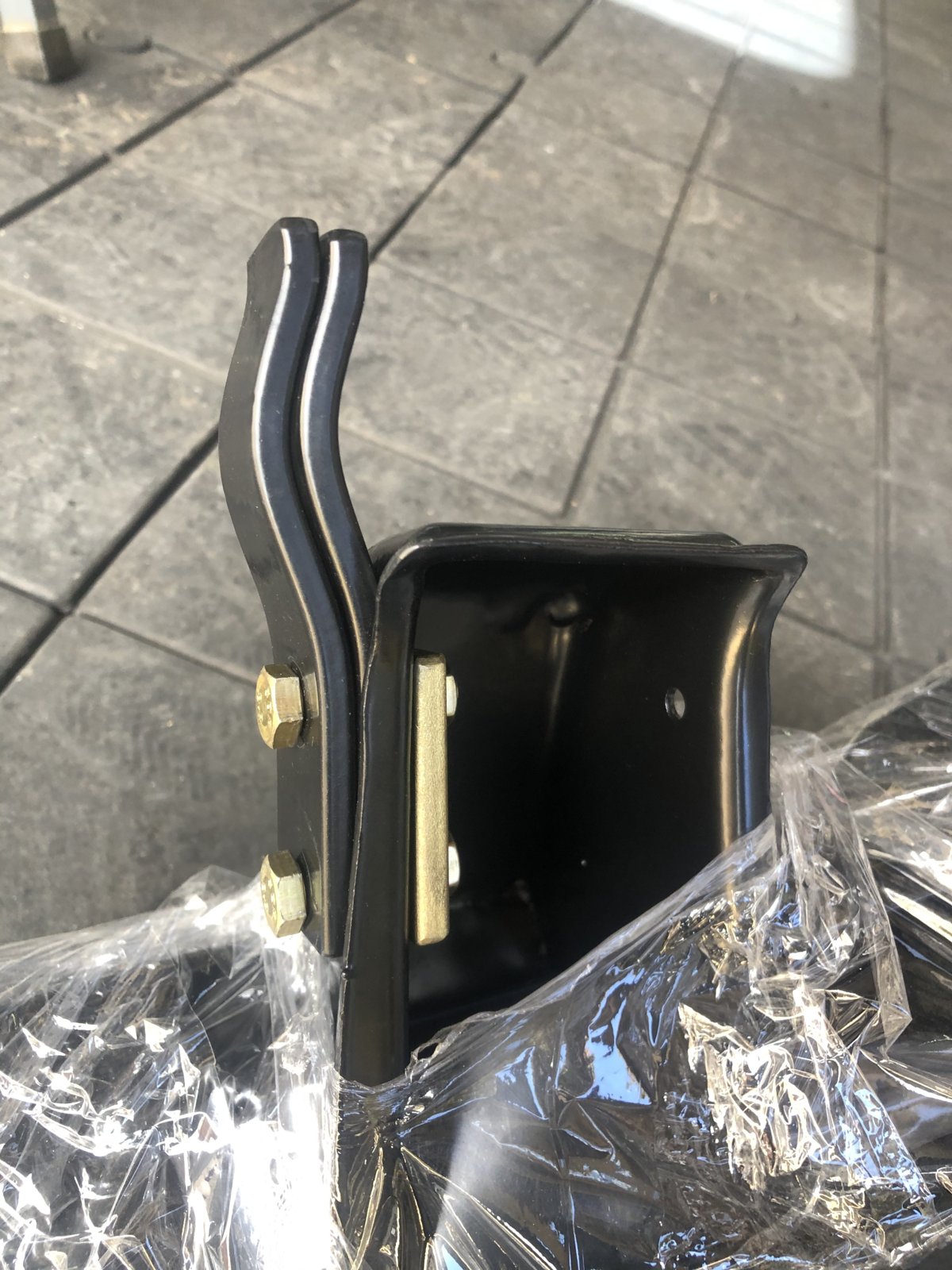

Wladek
1,316
799
Gdansk, POLAND
The single stop brackets were added to the 3.0CS (US) at 2240391 and 2250319. The US 74 coupes received the double stops. These are not intended to stop normal movement of the motor mount.
Ok, maybe it was only for US cars, but it doesn't change a thing that it might help & that originally the front frame is adapted for additional stops, no need to drill any holes etc.
