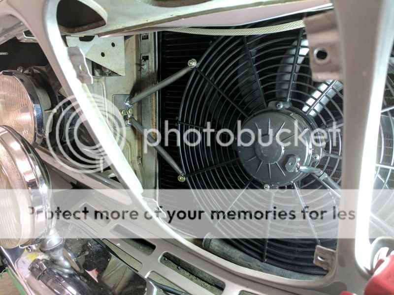

I installed my Spal fan last week and test fired it (Same as the one Alan is selling at an excellent price) Really runs quiet. I made the mount to attach to existing holes, so no drilling on the Coupe body.

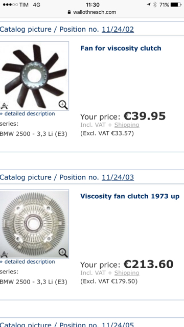

Answer from Wallothnesch :-(
"if you want to use the visco-fan clutch on your car you have to change the water pump, fan blade and radiator also.
please follow the links for the parts you need for a change:
https://www.wallothnesch.com/en/radiator-manual-transmission-11-25-01.html
https://www.wallothnesch.com/en/wat...535i-all-years-of-manufacturing-11-00-00.html
https://www.wallothnesch.com/en/fan-for-viscosity-clutch-11-24-02.html
https://www.wallothnesch.com/en/vis...535i-all-years-of-manufacturing-11-00-00.html"
