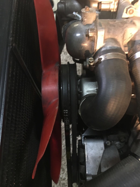

Here I am with photos of the old water pump and the radiatore on site.

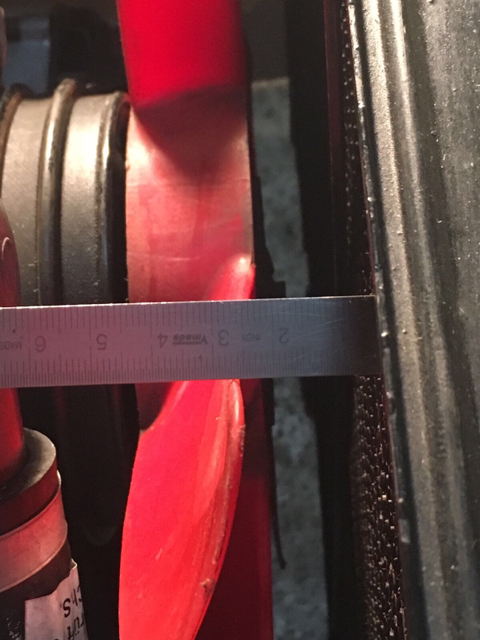

Does your new waterpump have a round pulley mounting surface (the one with the 4 holes in it)? Looks like you have room to fit the upgrade. What is the measurement between the fann blade and the top piece of the radiator (not the fins)?
Here you can see the pump actually fitted:
I think it is not the right one to do the upgrade, isn't it?
And, about the measurement I have to look at, is it the red or the green one in the drawing?

Yes with that water pump you need the 2 pieces I linked to before but with the fan clutch with the hole in it, that one is for the screw on water pump. Red measurement.
This can get confusing. The earlier viscous clutch uses the same four bolt holes but with with an adapter with a bolt in the center. The second version is called a spin on with a very large NUT on the pump side. I think screw on and spin on get used interchangeably and they aren't.

Here I am again: the measurement between fan blade and top piece if radiator is at least 2.5 cm.
The nearest point is the low hose near radiator...I think about 1 cm
