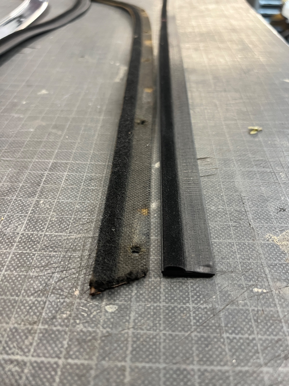

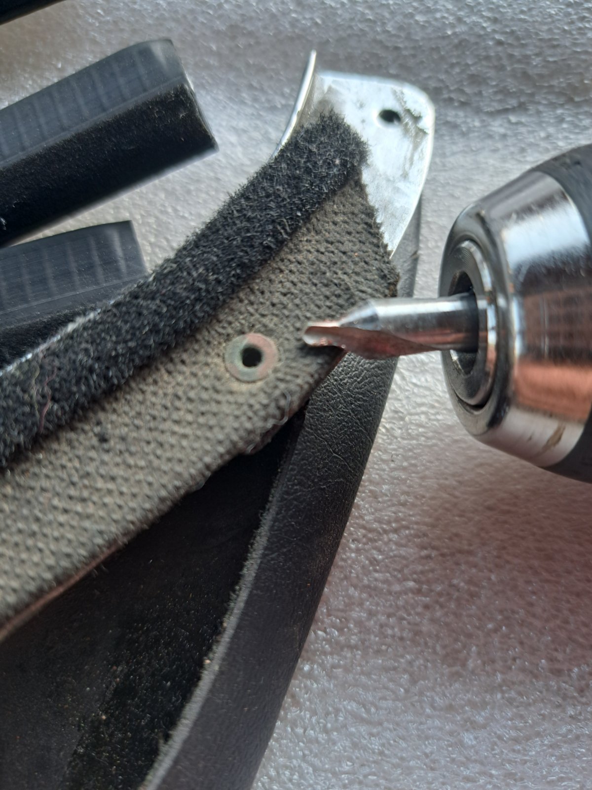

Well, it was me who started this thread, seems I am supposed to explain. 20250414_184212.jpg

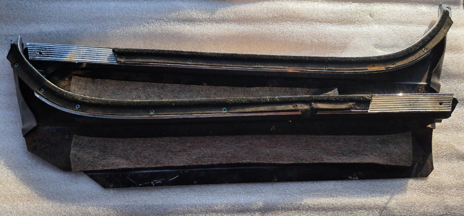

These felt strips act as a seal at the inner sides of the rear windows. One for the left, one for the right side, so two per car.
The original ones are no longer available, this is the replacement part.

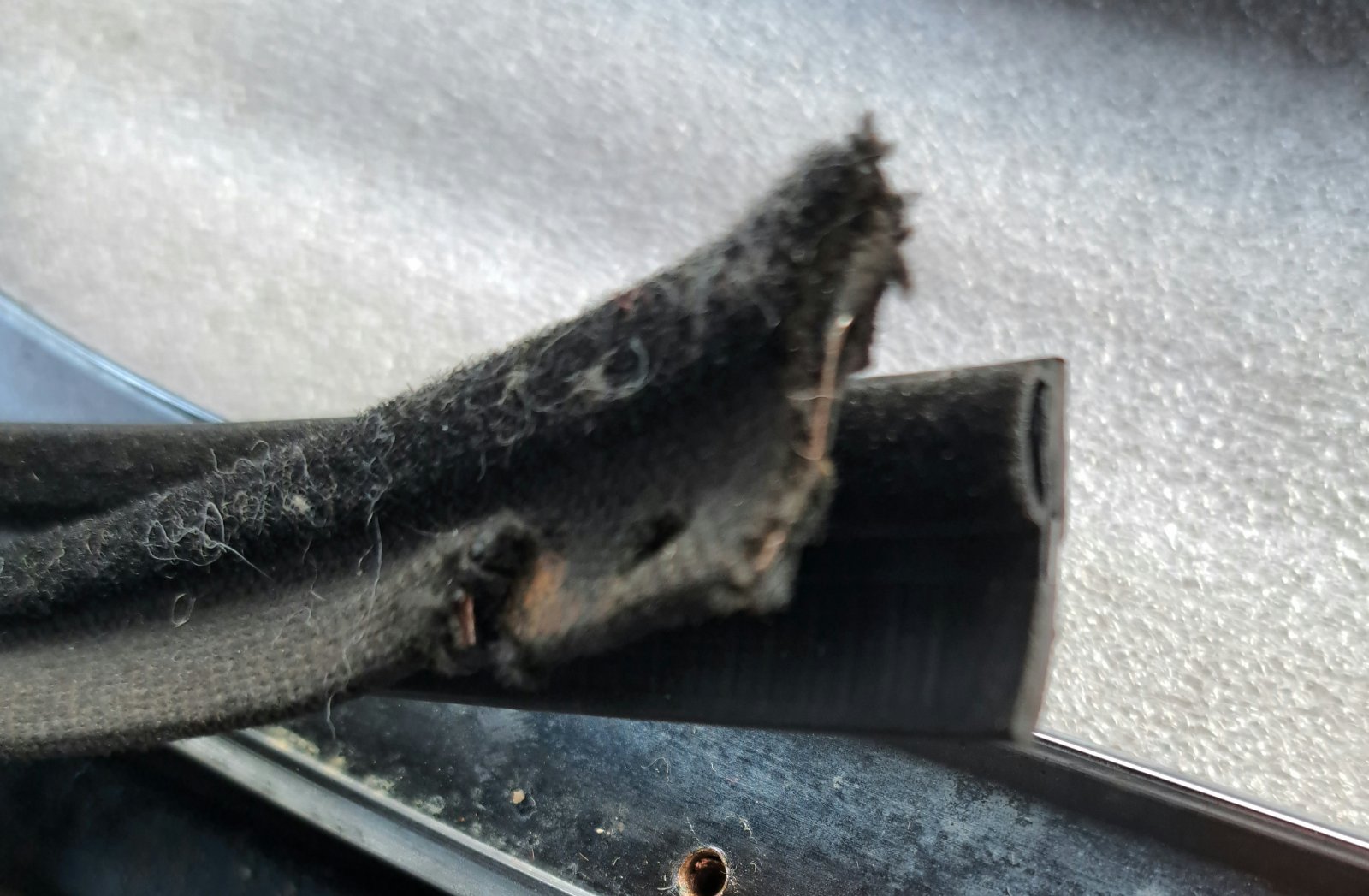

A metal strip, coated by a layer of rubber, with a wool strip on the upper edge
The original seal with an extra cotton layer surrounding the rubber and a thick wool strip. The new part, just rubber with wool coating on the upper edge.

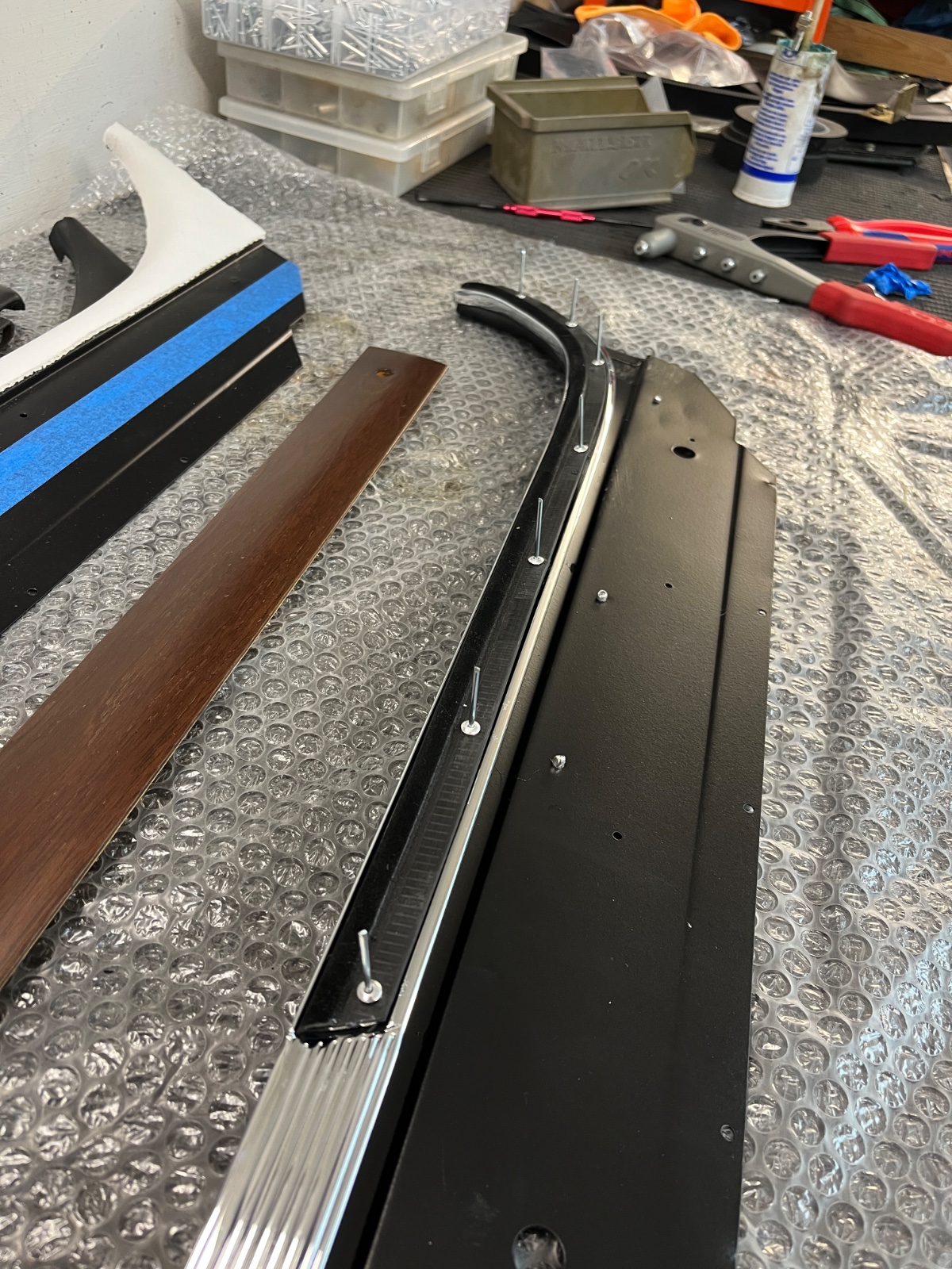

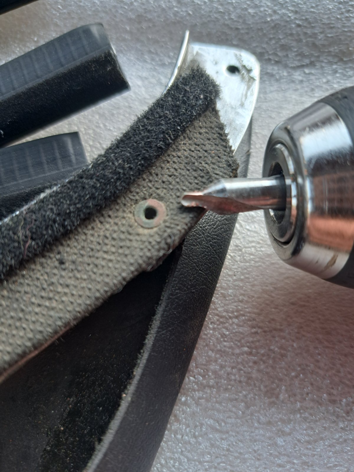

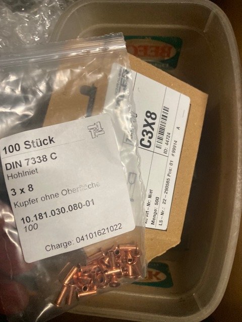

For changing the seal the rivets need to be removed.
