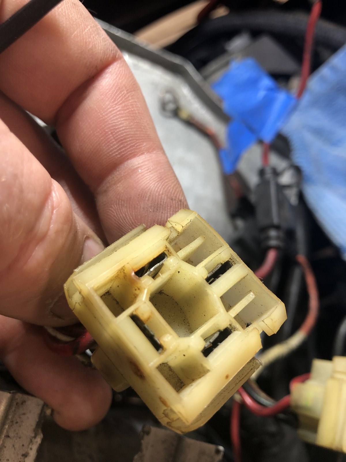

Where does one buy these that lock in place into the high beam and horn relay sockets? TIA
I also have a bag of these, from Hella. Same description, same appearance, I wouldn't be surprised if Hella was a customer or if they both sourced them from the same large supplier. I got them from Hella's US distributor, I use them for E24 six series lights, made by Hella. They're used everywhere in BMW cars.
And yes, 6.3 mm is the metric equal to 1/4 inch US (.250") terminals.
My price is $0.25 each - four for a dollar. Small quantities mailed in a padded envelope - $0.55 shipping.

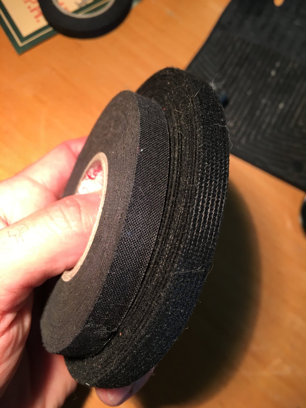

All my exposed under hood wires are inside the cable covers shown in the wirecare catalog. I bought 3-4 sizes of that in long rolls. I don't like tape and this is easily removable for any changes then you just slip it back over the wires. Great stuff.

I've used a lot of the F6 woven stuff before. Highly recommend it. Makes everything look good and is easy to remove.
