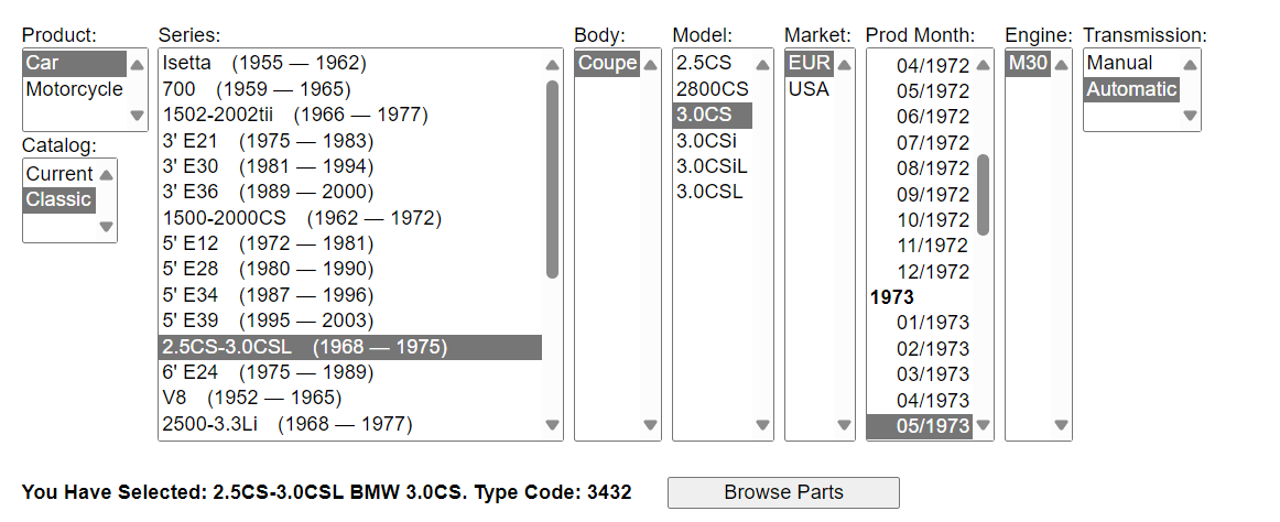

I actually now start to think that realoem also gives you this exact code; called 'model code' there.

my car would get the code 3432 from RealOem.com; I yet have to check if i also have any pencil marks on the rear bulkhead.

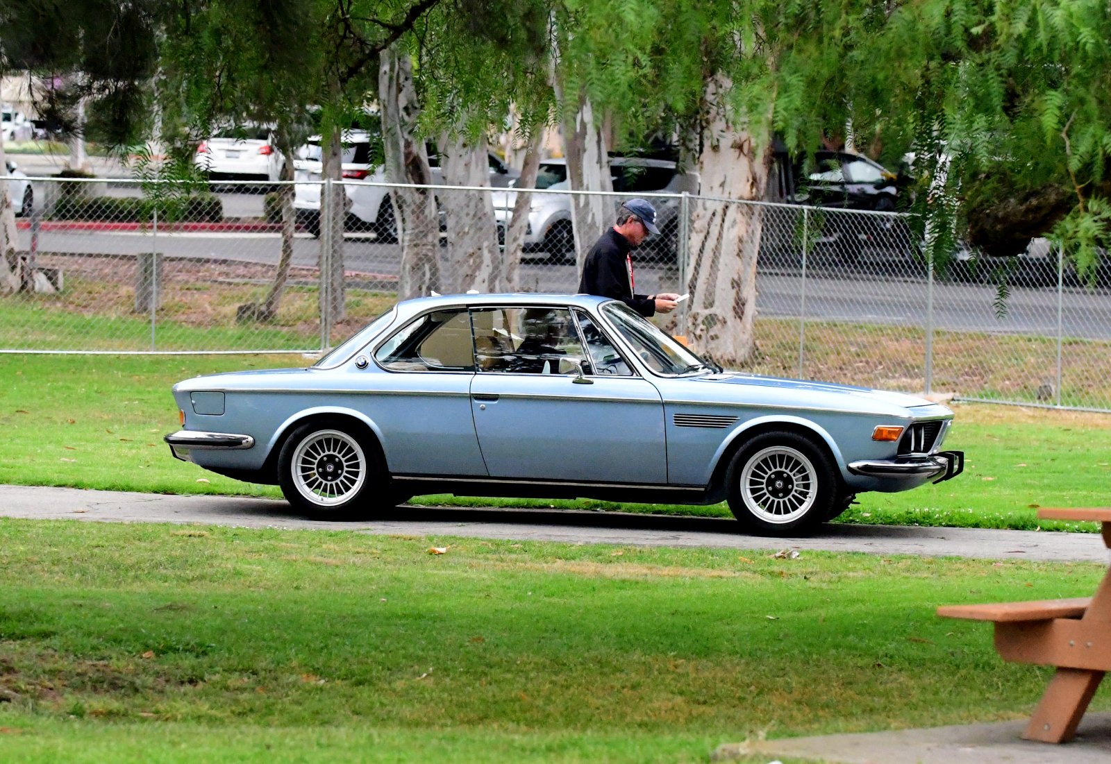

Project 89: Enter the 3.0 CS in a BMW Concours.
@HB Chris is one of the stalwart volunteers that organizes Huntington Beach's annual Concours. This year BMW was one of the featured marques, along with the Ford Mustang. (note the lower silhouette image).
Thank you to @HB Chris and his judging team for a very fun day with friends!
photo credit: Kyle Van Hoften June 2 2024
Congratulation! It’s hard to imagine any restored BMW that could score higher than your gorgeous fjord coupe.

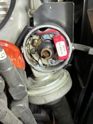

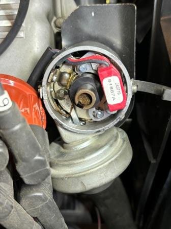

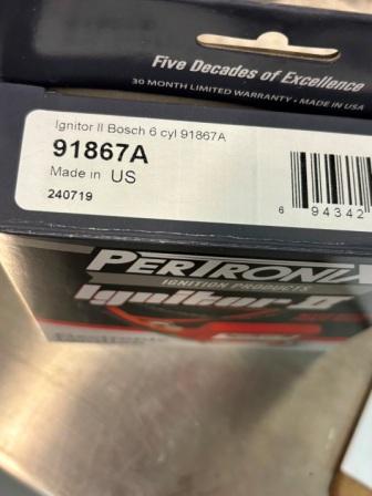

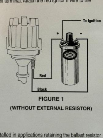

Project 90: Install the Pertronix ignition system. Since my last update I've taken the car on another 800 mile trip back up to Carmel, Calif. On the return trip home it started making this random misfire and it felt like the entire ignition system was cutting out for a few milliseconds, then recovering. Irritating as it was totally random. Earlier, I had posted the issue with ordering a Petronix ignition system off their website, only to receive the wrong part. I now have the correct part, noted in the pic below. The installation was very straightforward and it only took 45 minutes including the wiring. This completely fixed the misfire and now it is running very smooth to redline with no hesitation or stumbling. Very gratifying.

Had the same issue. Crane Optical & Pertronix, both caused car to instantly stop running at random. Returned to Points/Condenser & fixed the issue for ~10K miles. Ultimately MAP Sensor failed before July 2012 & rebuilt in March 2016. Now run a 123 6VRIE w/helical spindle.

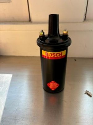

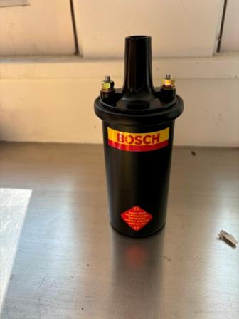

With pertronix it's common that there coil become hotter.
I recommend, with the pertronix install also install a flame thrower coil from them.
Got those issue with an 8 cyl .
Breit
Breit,
Good catch. What looks to be a Bosch coil is in fact a Pertronix 'flame thrower' coil in disguise. Already installed in the Coupe. Before repainting, you need to trim about 8mm off the top of the neck to get the stock coil wire to fit down into the ID of hole.
