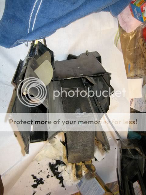

The heater core does have some minimal insulation wrapped around its sides. It is about 1/8" thick. I am in the process of replacing it. Most of it was originally soft foam that now turns to dust when you touch it. The control flap that lets air pass through the heater fins also has foam padding on it for sealing against the fins while closed.

I'm replacing my heater core too. If you have a photo of what that insulation is supposed to look like Id appreciate seeing a copy.

Here are some pics. I am planning on using a 1/8" neoprene like material - maybe thicker if is fits. The foam around the inlet/outlet tubes was closer to 1/2" thick (covered by the oval plate on the engine compartment side).

Thanks for the photos Sven.
My core didn't have any of that insulation left. But am I seeing this correctly--the core as well as the plastic heater box both have this insulation ?

Just the core. The insulation you see on the heater box around the pipes is between the heater box and the firewall around where the pipes poke through the fire wall.
