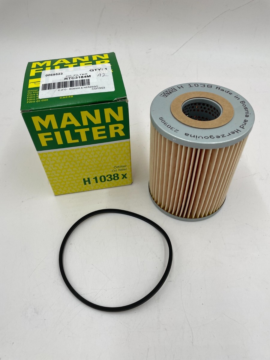

The Mann H 1038 filter was not available at your LCPS. Amazon delivery was 4+ weeks. That left eBay as a faster option, but still a one to two week delivery timeline. So be it. I ordered the Mann H 1038 X. When it arrived, the o-ring was a flat type with a slightly larger diameter, but too large. What? So, I reused the old o-ring.
After more research, I learned that the replacement o-ring appears too big but supposedly fits into a groove on the housing lid. I don't recall a groove and will investigate this during the next oil change. The AI wizard explained a few tricks to get the flat o-ring to seat properly in the groove and tighten it without coming free and binding. As the Zen Master says, "We'll see." Just in case, I intend to purchase a supply of the standard o-rings as they fit perfectly inside the houseing lid.
