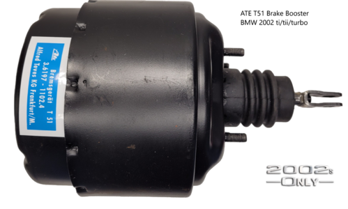

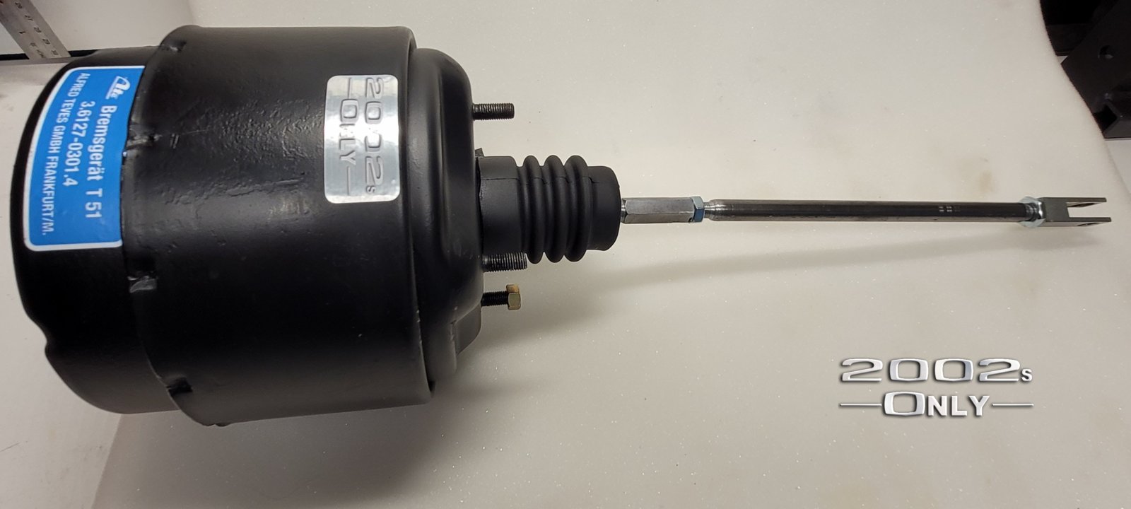

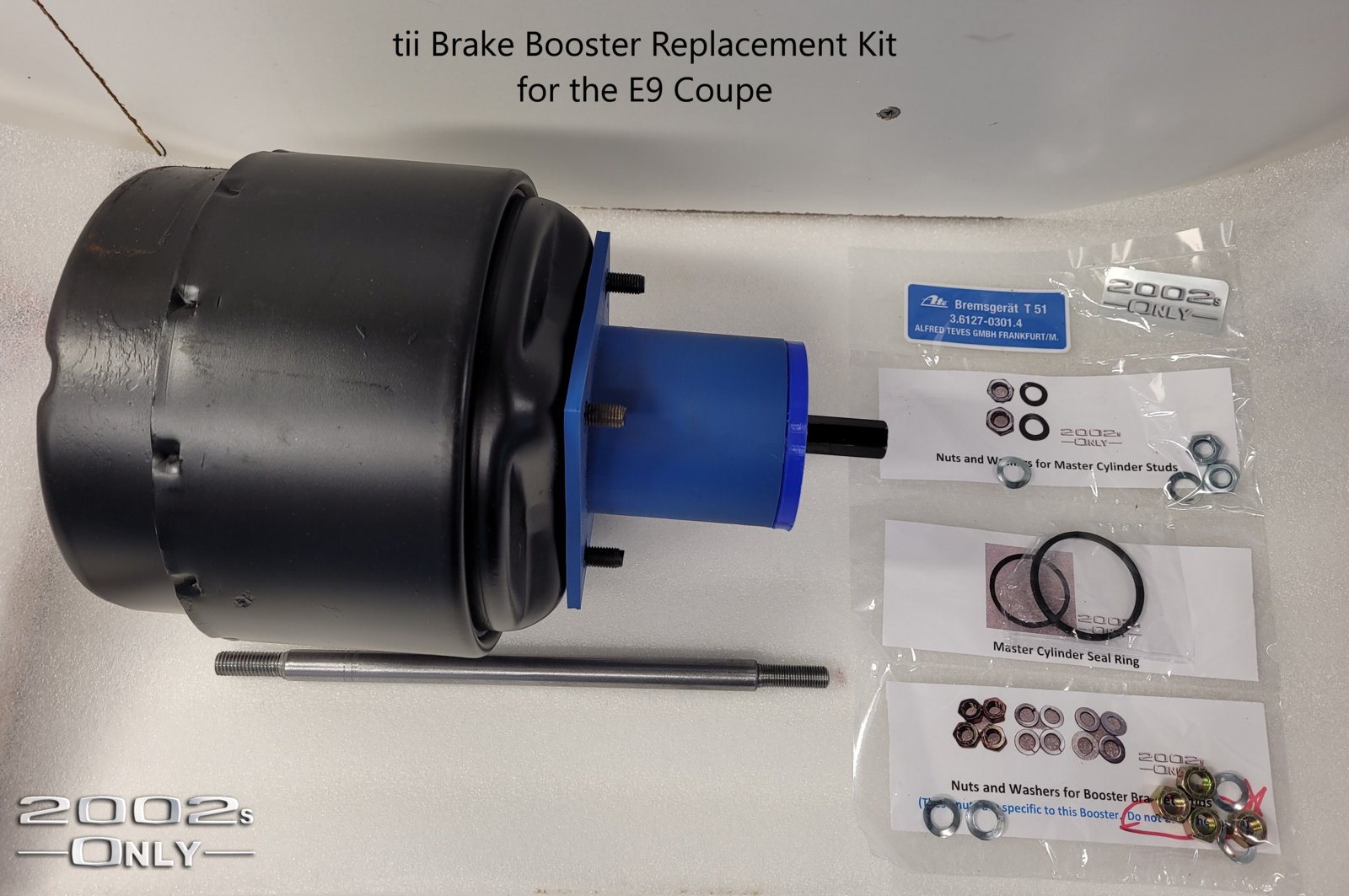

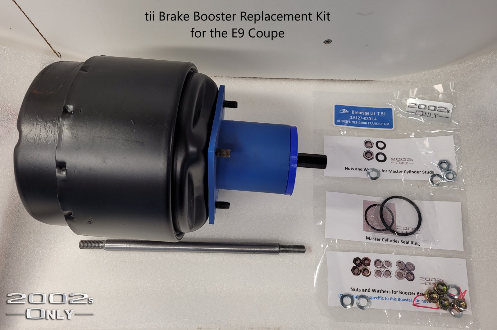

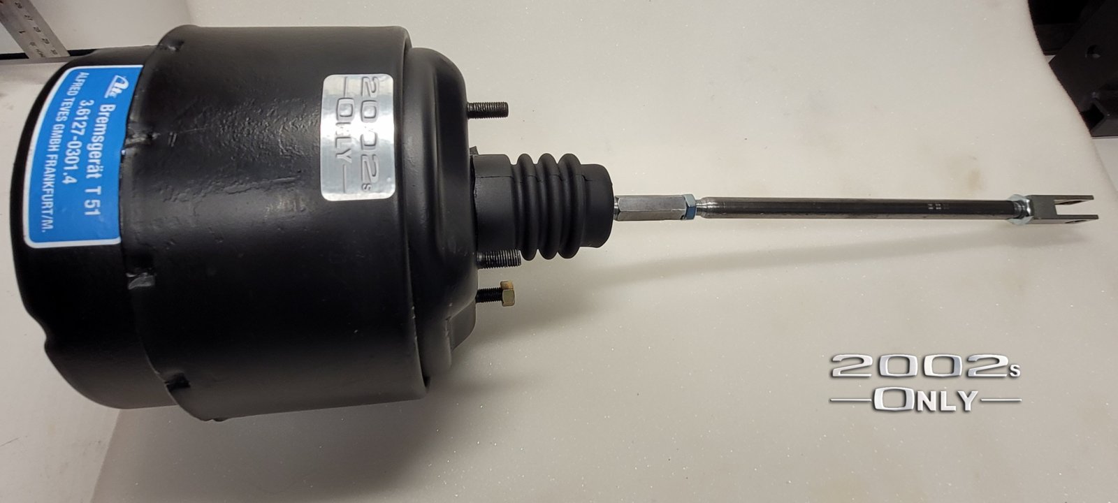

I've already mentioned this to @mark99, but thought I'd reiterate for the group. At 2002s Only we convert professionally rebuilt ATE T51 brake boosters to be a bolt-on conversion for the E9s. The original connection to the pedal is a straight rod threaded at both ends to allow for pedal height adjustment. Our conversion retains that original configuration and maintains the rigidity of the booster to pedal connection. We have these in stock if you are considering the upgrade. They come with a all the hardware needed to bolt it up, the master cylinder seal ring, an ATE T51 sticker, and a 90-day warranty.
Here are some pics.

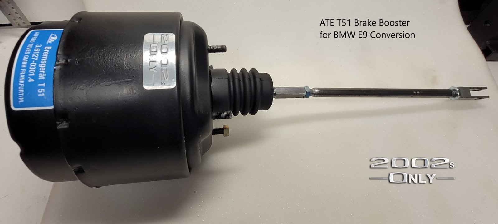

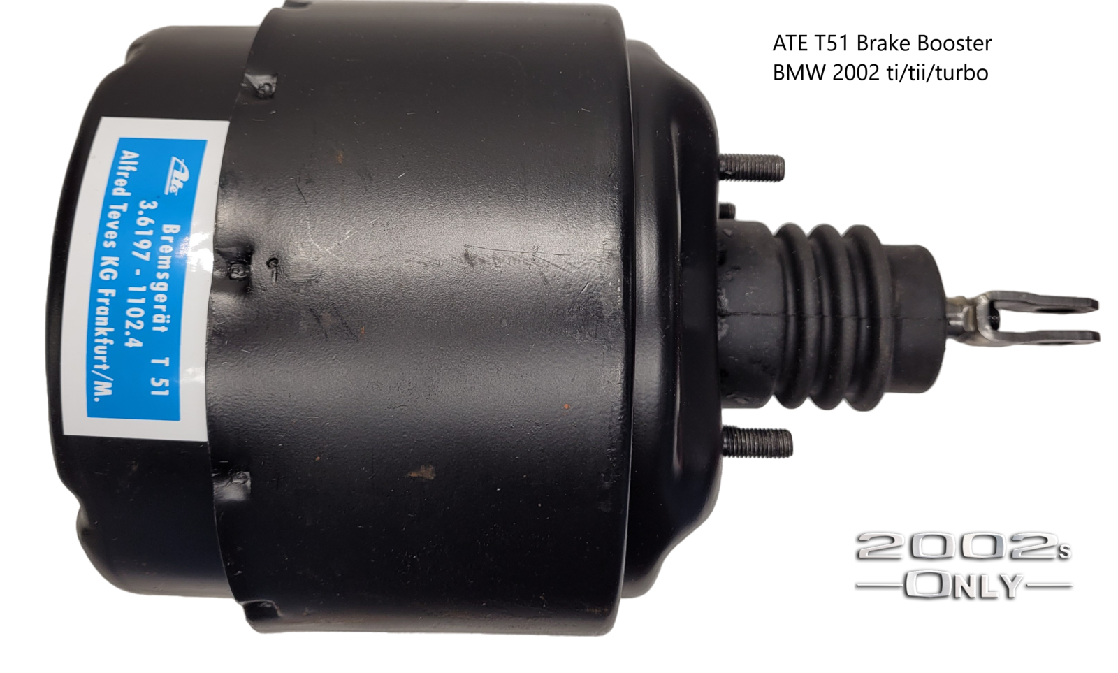

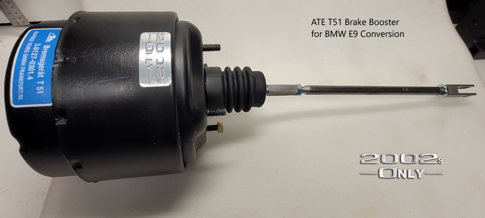

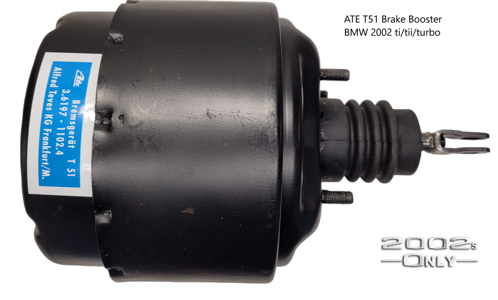

There are many different period-contemporary ATE T51 brake boosters with the cannister size, dual diaphragm and mount points of the original 2002 ti/tii/turbo boosters. The 2000CS is one example. On the 2002 the connection to the brake pedal mechanism is a yoke and clevis pin connected to a bell crank and then to the pedal as in the attached pic. Whereas on the E9 it is a straight rod that bolts onto the pedal with a yoke and clevis pin.
Here are some pics.

@autokunst and @bluecoupe30! thank you for your kind words. We have been producing these boosters for the 2002 crowd for several years and finally found a way to make them a bolt-on upgrade for the E9s. Both the coupes and the '02s need them for the same reason: more room for upgrades to the stock intake system. But rebuildable ATE T51 boosters of any configuration have become extremely rare in the last 5 years or so. And the "good used" ones that are out there are often not rebuildable. Our experience is that about 20% are not useable. Despite that, we hope to be able to supply these for a few years to come.
