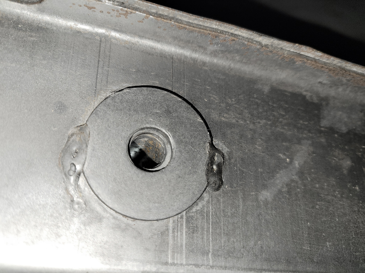

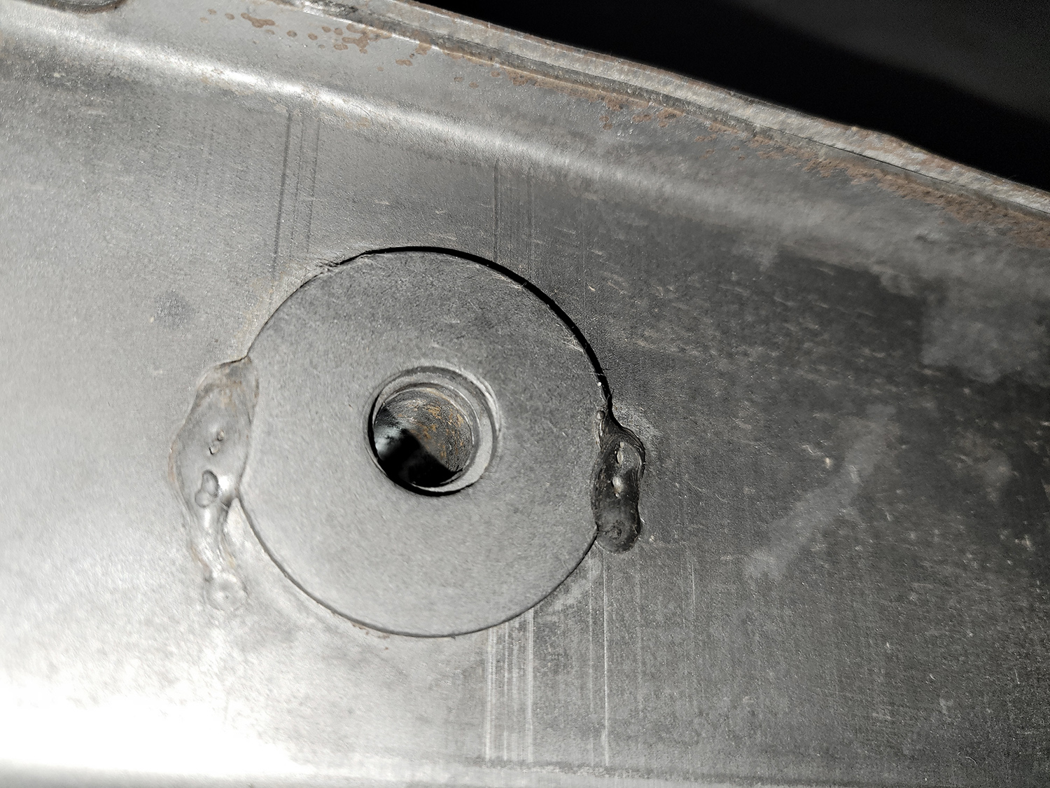

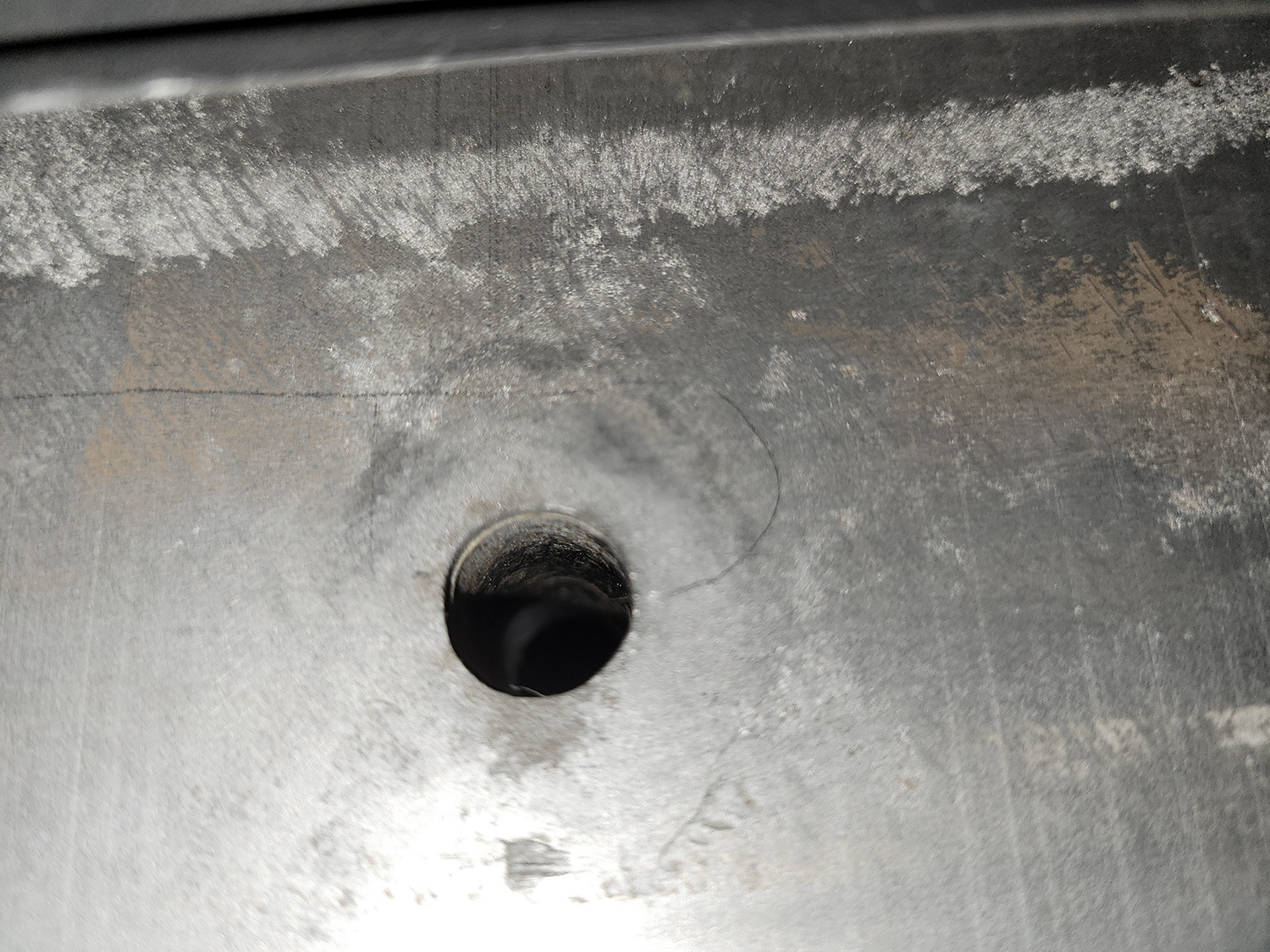

Follow up. Here are photos of the 1973 US CS bumper attachment points. Sorry for the delay.
View from inside (engine bay):
View from outside (wheel well):
Excellent pics @autokunst , these demonstrate there is actually a steel spacer tube to reinforce the frame as @jmackro wisely said
