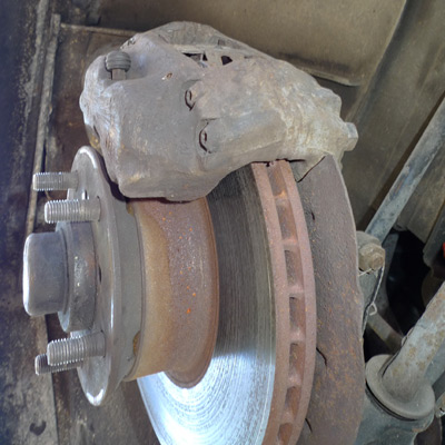

Hi. I need to remove the outer spacer from my front hub for better wheel fitment. Do I simply pry them off or is there more to it, e.g. shorter lug bolts?
You will have to remove the outer bearing under the cap. Others chime in but I think that spacer is an integral part and not sure how the bearing will seat without it.

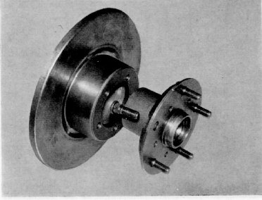

Ah, you're right. The car is in storage now so I didn't know what the part/assembly was. I found this repair manual image.
Follow-up question: I installed 15" OZ Alpina-turbine-style rims (7J-15 H2, et 10) with 205-65 tires and the fronts are 0.5" or so beyond the fender line. Are there any adjustment options be to bring them more inward?
That's not a spacer, it's the actual hub. The brake disc bolts to it and the assembly is then mounted to the axle stub. It's #1 in this drawing.
Edit, posted a minute too late. The only way to bring the wheel inward would be to machine the mounting face, and it depends on the wheel construction if you could even do that.
