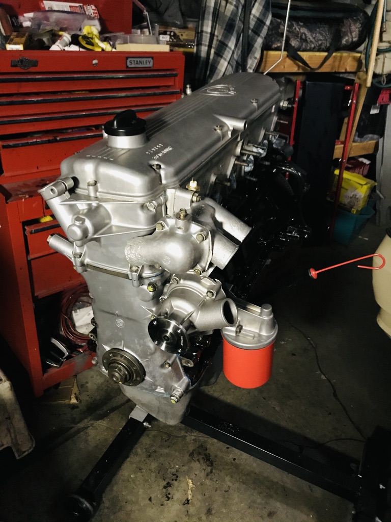

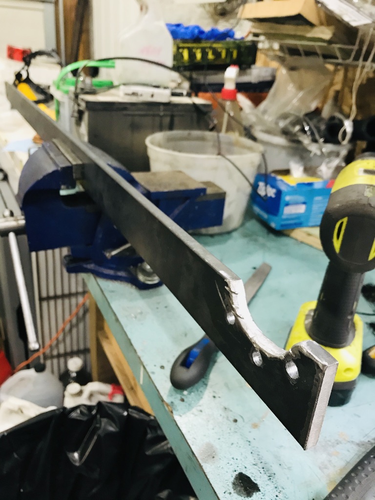

Its pretty straight forward. Mainly creating access by removing pulleys and harmonic balancer. I would remove the radiator too to increase working room and to not damage it. Behind the balancer is a large nut and the flange the balancer is bolted too. The nut is super tight ~300 ft-lbs so you need to brace the flange and use a heavy duty breaker bar. I made a brace out of 1/4" x 1.5" flat iron bar (~3' long) that bolts to the flange and braces against the floor. Once the nut is off, the flange can be pried off the end of the crankshaft. The seal is then accessible, can be pried out and replaced.

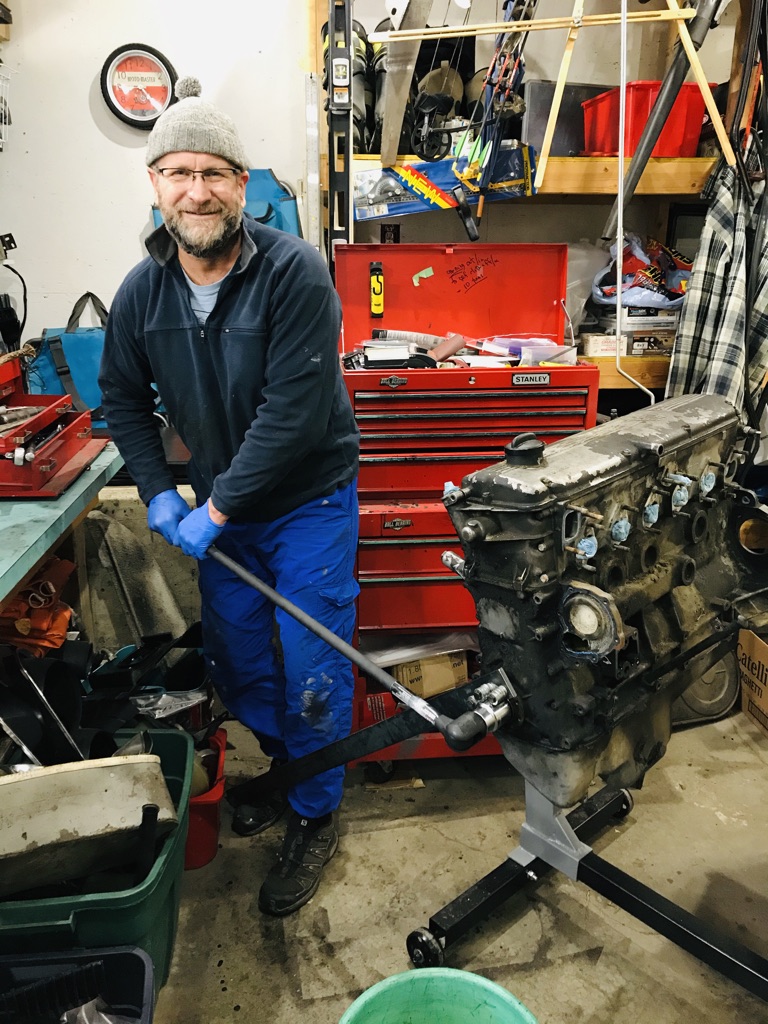

My god the pics of your breaker bar and brace just came in . Ok well that gives me a really good idea of how to prepare.
The nut is TIGHT. Doing it on the ground is interesting to think about. I know it is done though. I am sure others will chime in. I would want to know how others have 'braced' to loosen/retighten the NUT. I wonder if leaving the car in gear is the method?
Oh ya...you do not need to remove the lower timing cover. The seal is pried out of and gently tapped into the cover.

Speaking from a lot of experience, flywheels locks are the way to go if you can get one on there.
Soak the nut for a day or two with PB blaster or equivalent.
A map gas torch is sufficient to heat it up. Heat and cool a few times as the expansion and contraction will loosen the nut.
If it's never been off it can be a bitch.
I have done it from above with a 4-5 ft bar on the socket.
It takes all my weight to get it to pop.
If you can get a big impact tool in there that would be an excellent alternative. And may not need a flywheel lock.
Radiator out but AC condenser may have to be taken loose (not disconnected if you have AC) as well to get room.
Next is getting the flange off.
Sometimes they come off easily and sometimes getting the flange off is the hardest part of this job.
A really good puller and again some heat will really help.
I have had to cut the side of the flange with a Dremel tool to get one off before. Hope this doesn't happen to you.
Good luck, take your time and let us know how it goes.
