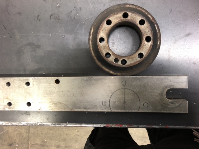

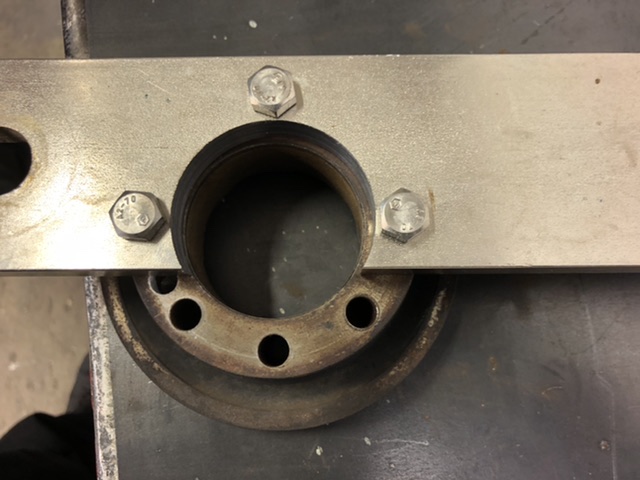

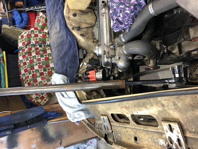

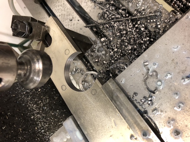

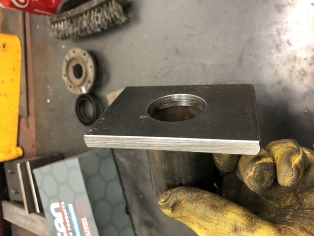

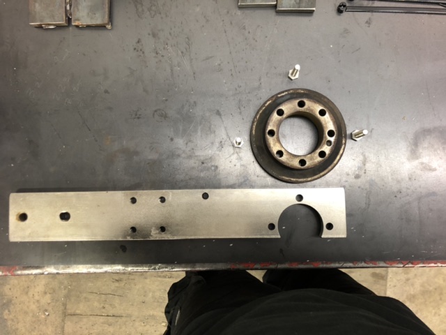

Ok worked on the crank brace here at work. Really nice having a mill at work.
Finished product. Should work like a charm

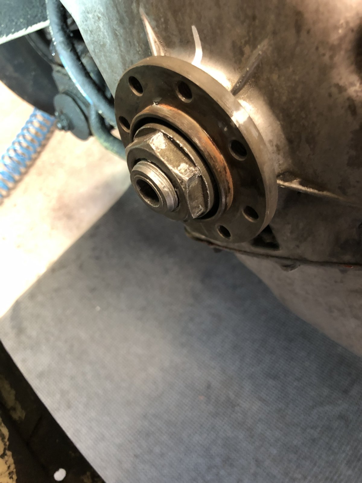

-Alright the crank brace worked like a charm. No heat necessary to break the 36mm nut. Just a long breaker bar like suggested.

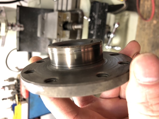

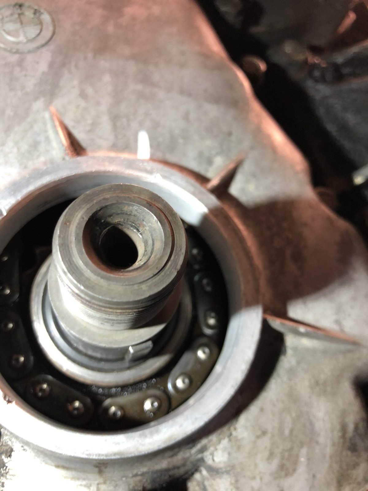

-after pulling the pulley hub off I realized that the seal does NOT ride on the crank shaft but the hub flange itself. Making it way easier to pry out of the lower timing cover (mind you very carefully not to score that surface). making it unnecessary to remove cover.
(sorry I don’t know why these photos load sideways)

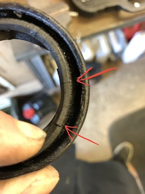

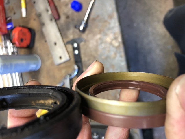

-as you can see from the photo the old lip seal was shot
-the great thing about the replacement victor reinz seal is that the actual lip is located a few mm towards the front then the original. Making installing the new seal easier just lining it up smooth and even with the timing cover as the old one was and not having to worry about lining up the lip with the old lip groove on the hub flange.
-today at work in order to make sure the new seal goes on square and even on the cover I’ll make a custom seal driver to accommodate going around the crank shaft.

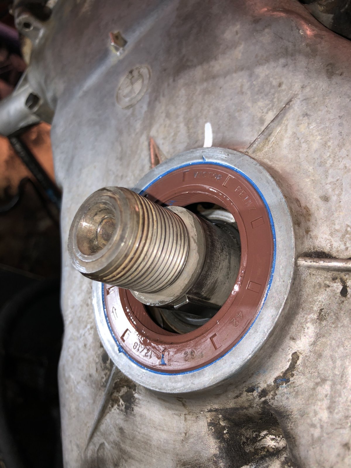

New seal installed I’m confident it will work out ok. Just like to say thanks for all the input and tips everyone. Made the job a lot easier knowing what I was getting into.

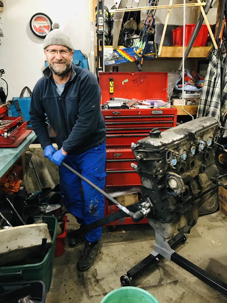

It is mucho ft-lbs. I recall in the mid 200s. To tighted it, I used my weight over the length of a flex bar (200 lbs x 1.25 ft = 250 ft-lbs, if I recall correctly. You can see how I braced the crank to loosen it when I began the engine refresh. I used the same method to tighten just opposite.

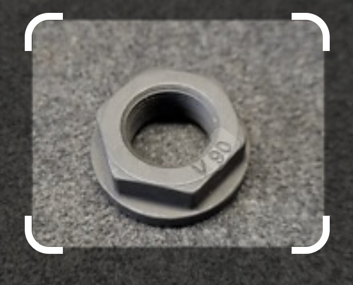

so this style/type of shouldered nut requires around 325ft/lbs huh?
I remember running my impact to remove it (took a while) and did the same to install it.
I ordered the Ireland engineering tool and will be trying it with an torque bar this time.
Hopefully that fixes my problem with the winding/squeaking

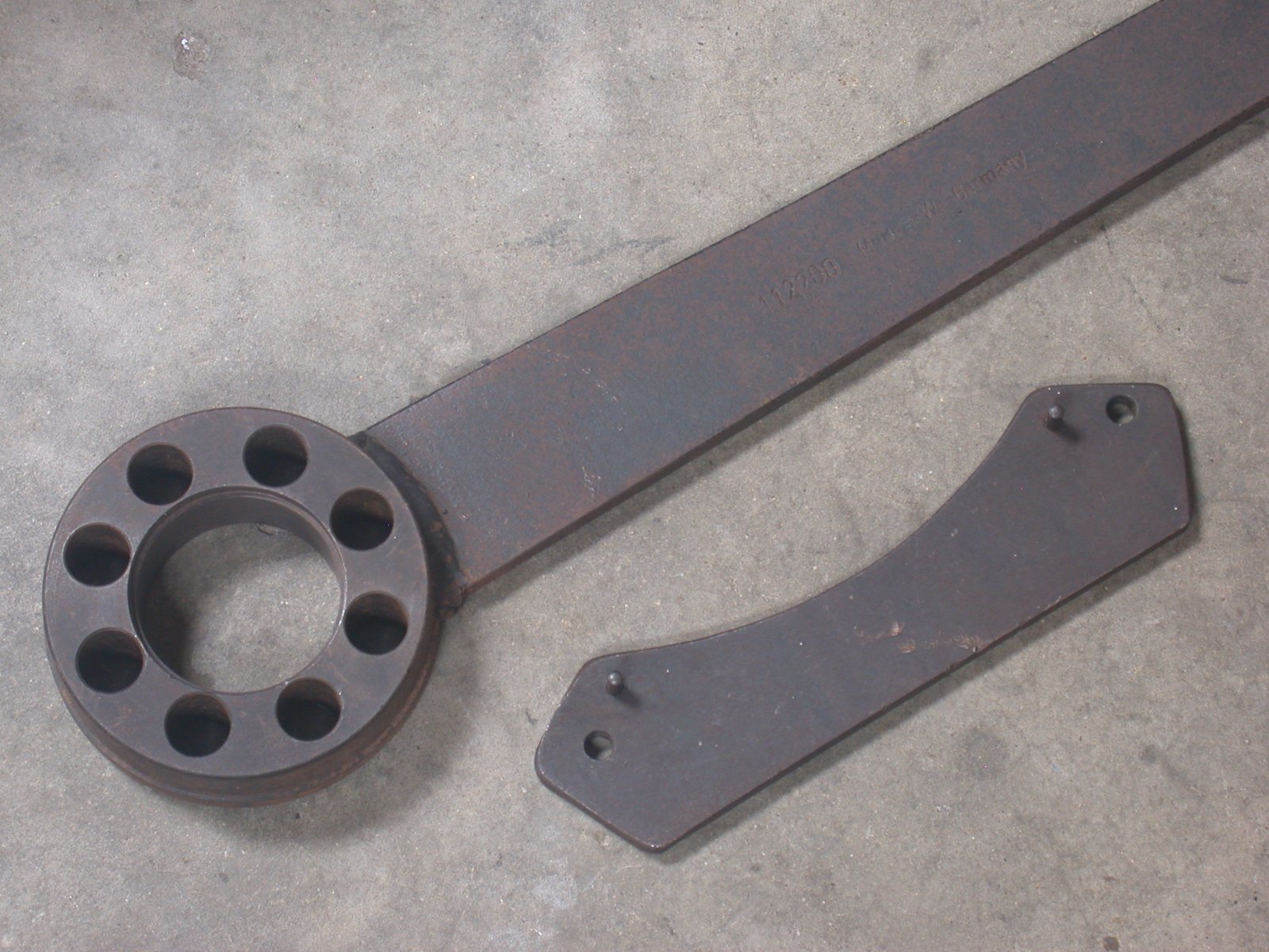

BMW had 2 special tools for this job, a crank holder that bolted to the front hub and a puller
that would pull the hub after breaking the 36mm nut loose.
BMW had 3 special tools for holding the M30 crankshaft, with the engine in the car.
The flywheel could be locked with tool 6069 (11 2 100), or 6069-1 for automatic transmissions.
At the front, tool 7025 (11 2 200) could be slipped over the vibration damper bolts. The tool numbers changed to 6 digits in the mid 1970s.
A small flywheel lock was also available, for use with the engine removed.
There was a factory puller for the timing chain sprockets, but not specifically for the front hub.
