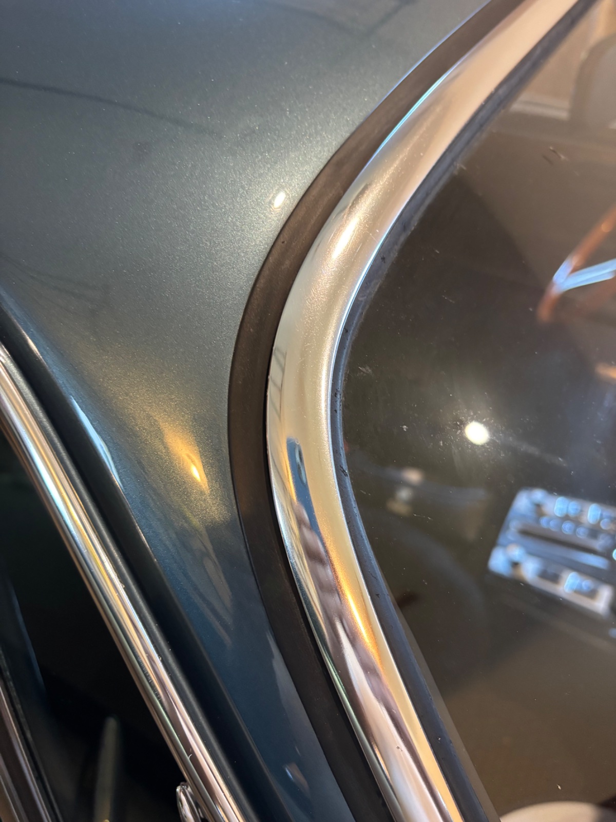

I had the same problem. The new rubber is thicker than the original. Had a professional do the job. First one wouldn’t fit, next one fit except the upper right side. It sagged into the groove there. No matter what we did, that gap would not go away. After 3 hours of manipulation, I told them to put black silicone gasket seal into the groove so moisture would not seep in the rail. It worked.
