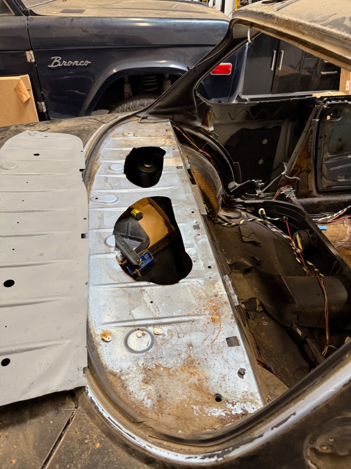

My coupe has never been cut up for speakers, the door panels and parcel shelf are uncut and I would like to keep it that way. I think the planar speakers that @e9Leveque is installing may be a nice option and I may well go down that route.
I am also intrigued by the tweeters in the ash tray that @rsporsche is doing. What are the options for the rear seat area since I will not cut holes in the parcel shelf? I have though about removing the original padding there and adding some surface mount speakers, but look forward to thoughts on other options.

I agree with you on most points. I am having those gaping holes welded up. I have speakers below the rear seats, and will do the in-dash thing (not sure if I will use my cone based design, or the planar one I did for @e9Leveque. I have brand new pristine kick panels door panels, and leather trimmed ashtrays that I refuse to cut into, so that's as good as the sound is going to get. If I don't like it, I'll step on the gas and mask it with the rip of my DCOEs...

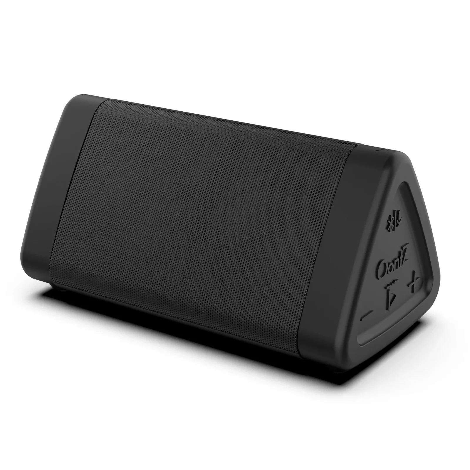

So basically an open-air version of these triangular speakers copied below - have the planar portion as the speaker and then perhaps an angled “foot” that rests on the parcel shelf with the rear open.

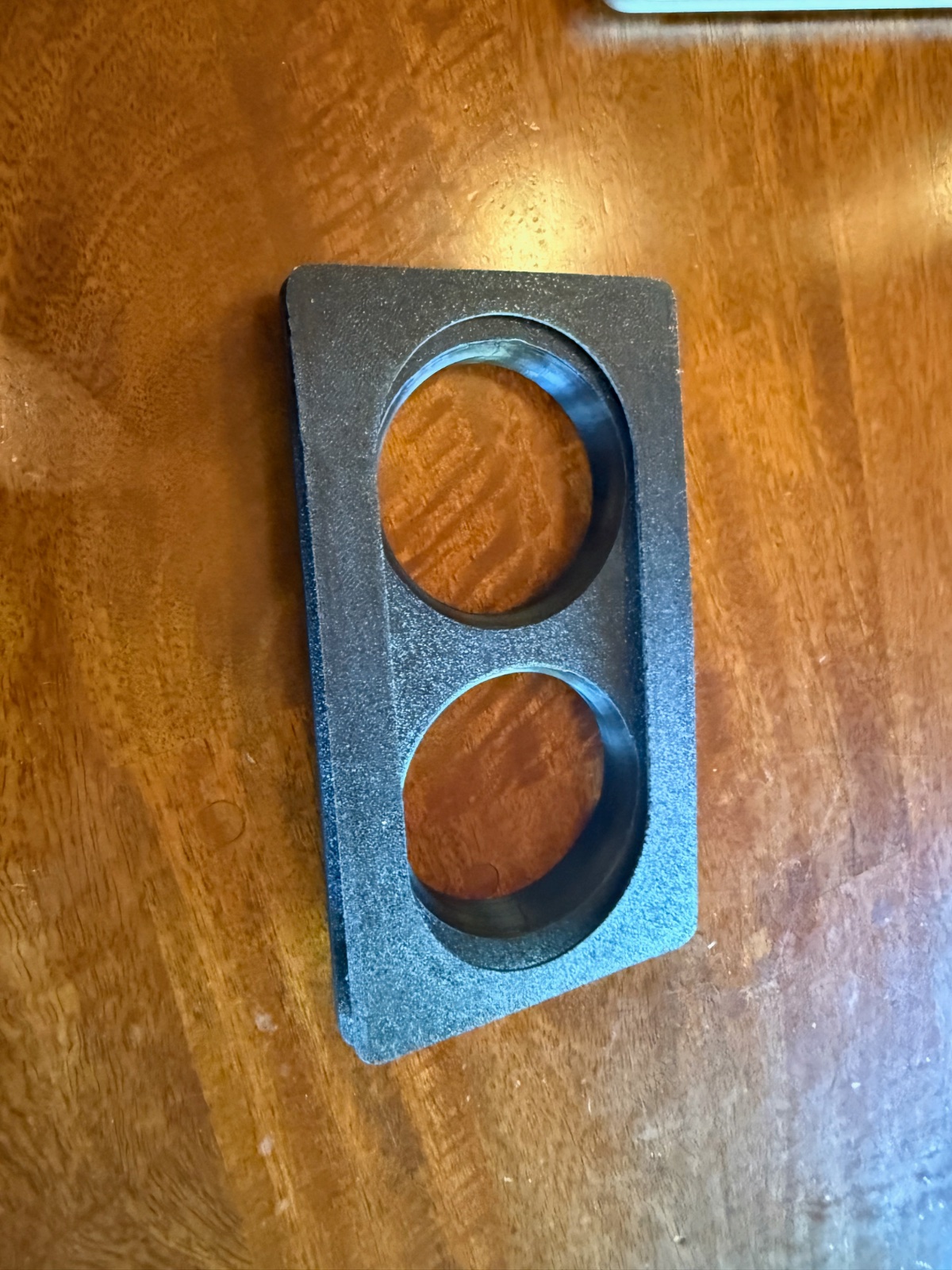

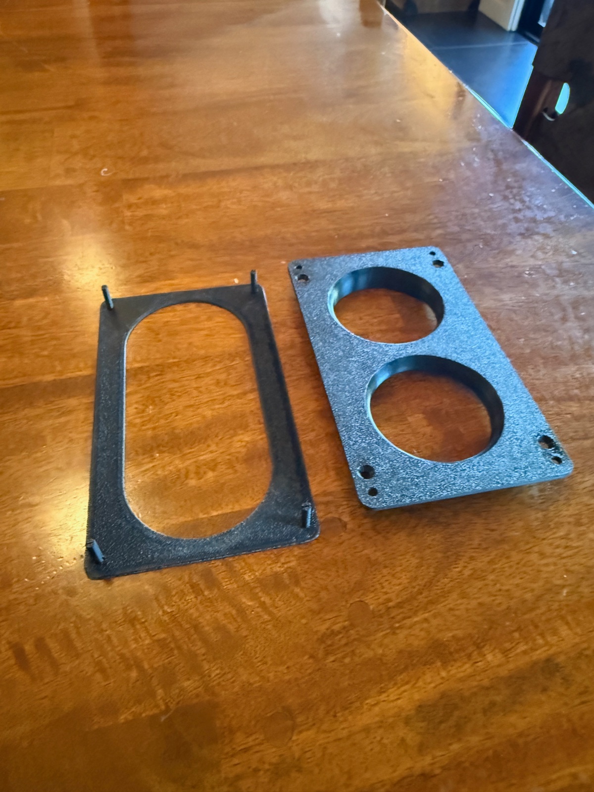

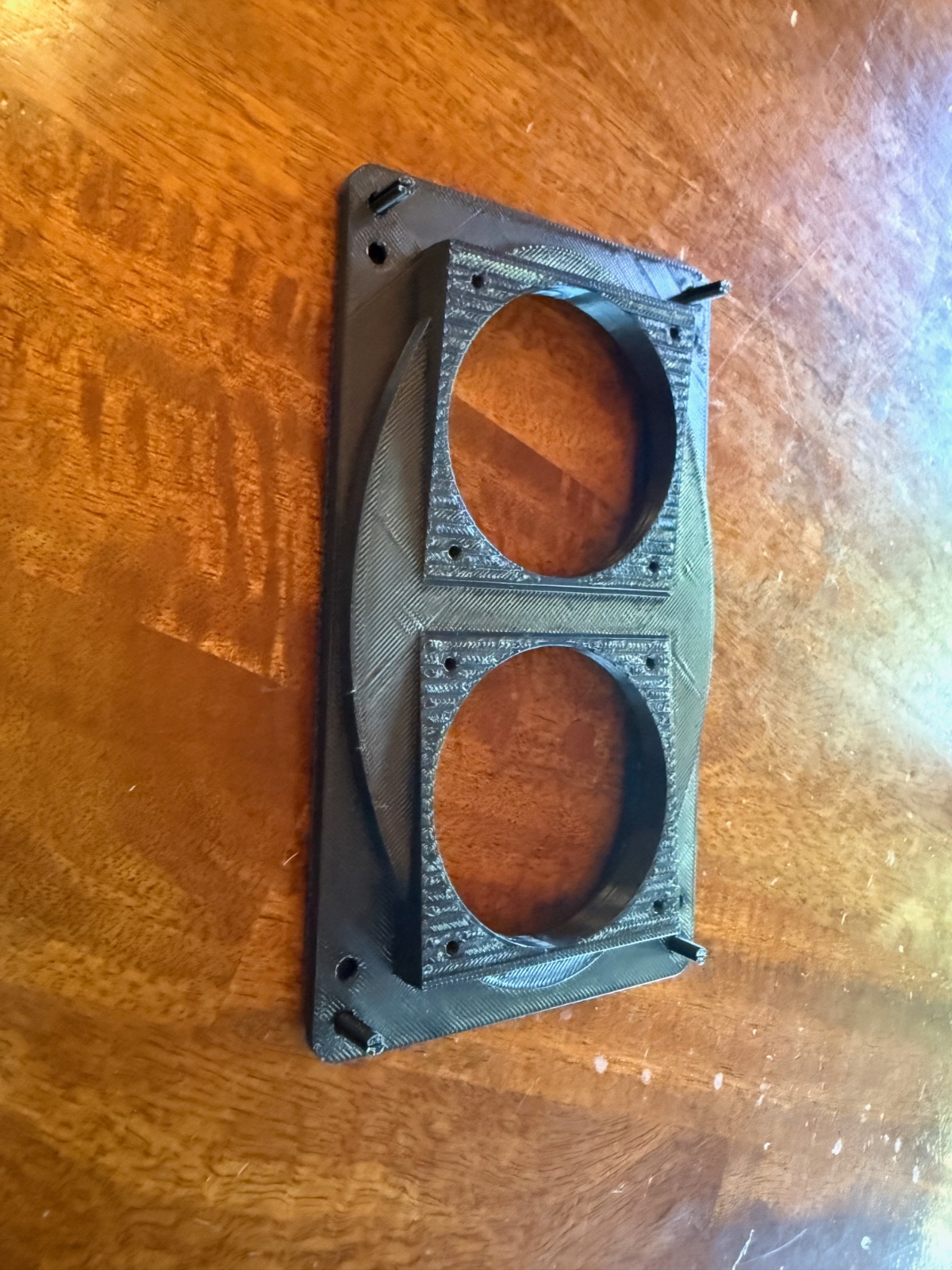

OK, the revised cone speaker version of the baffle I did for JC is in. Fits really nicely! I'll go attach the speakers and give it a try this weekend.
The wood grille gets glued to the thin mounting plate and that gets held on with those pins.The oval section fills the existing oval speaker hole.
