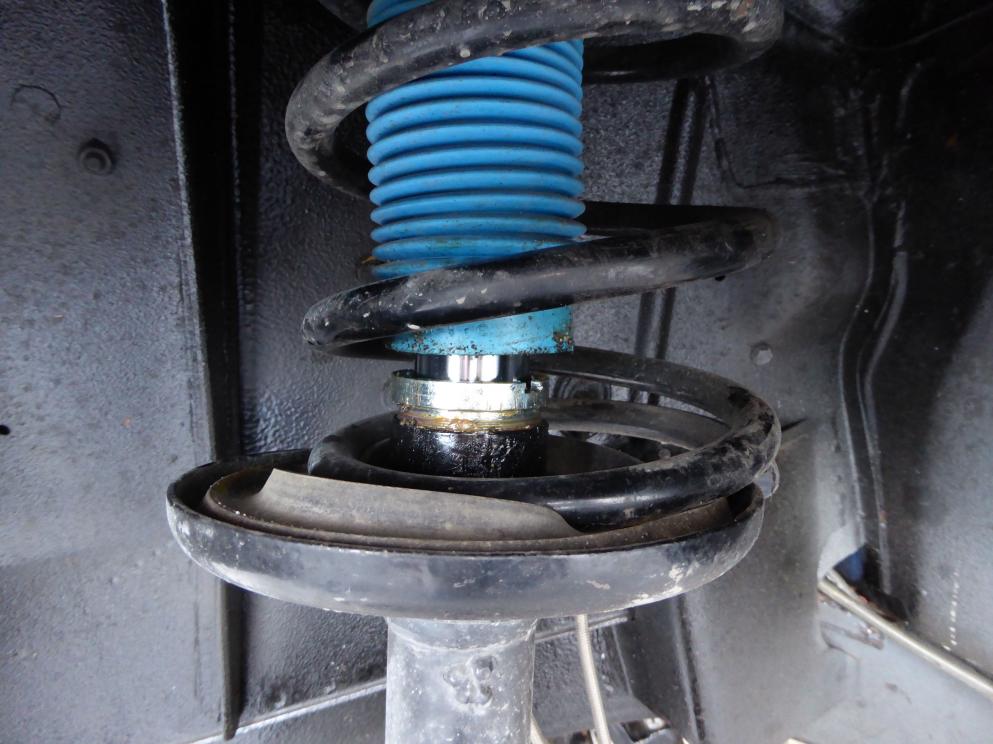

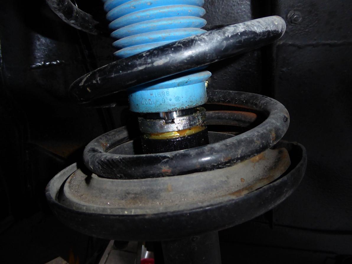

Here are some photos of left and right spring after the MOT test and a short drive home. I think they illustrates my concerns! The spring on the photo has a free length on about 240mm and the gap is about 10 mm. The blue book says that the length of a CSL spring shall be 260mm, so why do some companies sell springs that obviously miss 20mm? It is exactly 20mm that is needed to fill the gap and put the necessary pressure on the springs to keep them in place. I think the BMW engineers saw this when the modified the springs for the CSL.

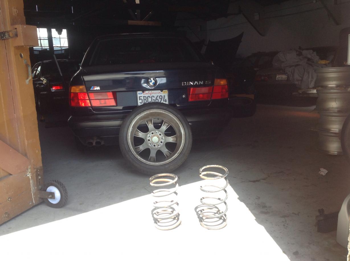

And here is a pic I took last week of a set of springs I took off an csi and replaced with the last known set of original NOS lowering springs from CN. Old springs can go bad.......
These were red stripes. Has anyone measured yellow?
I contacted W&N and asked them if they had an explanation, but the answer I received gave no meaning. In the meantime, however, I found that BMW supplies the lower spring rubber in different sizes 10, 15 and 22,5 mm. So I mounted the 22,5 mm rubber yesterday and it closed the gap. No more rattling from the springs and they will not move out of position. Problem solved!
BTW: By measuring old and new spring struts I found that the lower spring plate are welded slightly lower on the strut on models up to 71. This will naturally cause the gap to be larger on a 2800 CS than a 3.0 CSI.
