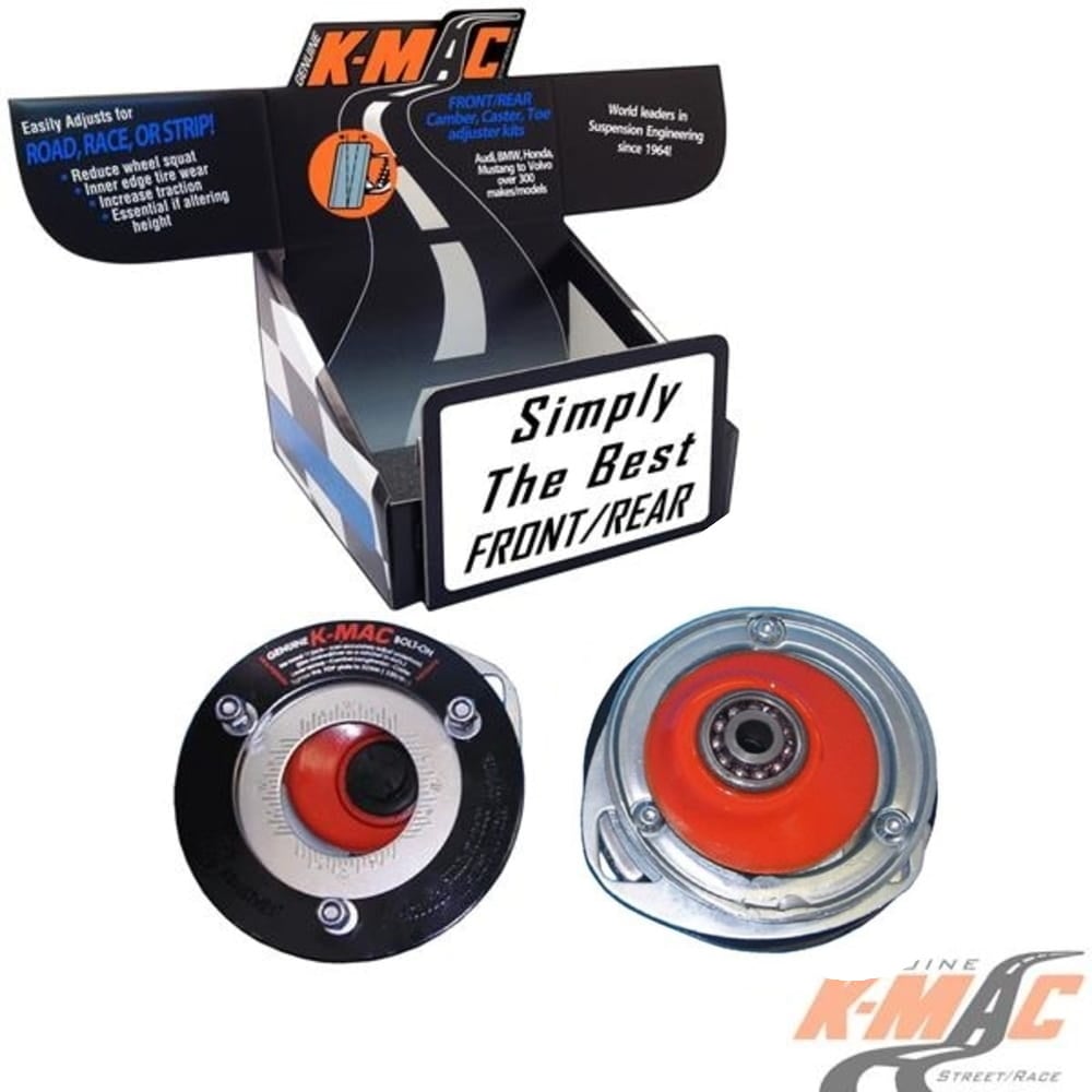

From a price and utility perspective it might be time to consider negative camber plates as an option. I believe that Carl Nelson may have some (I haven't used) and KMAC in Australia sells some as well.
This is a good point. Thanks for bringing it up. I see K-MAC has a few options:
https://k-mac-camber-kits.com/product/bmw-e3-front-cambercaster-streetrace-191716-2l/
and also this from MTS-Technik https://mtstechnik.com/en/products/adjustable-camber-caster-plates-front-bmw-2500-3-3-e3-40679.html
