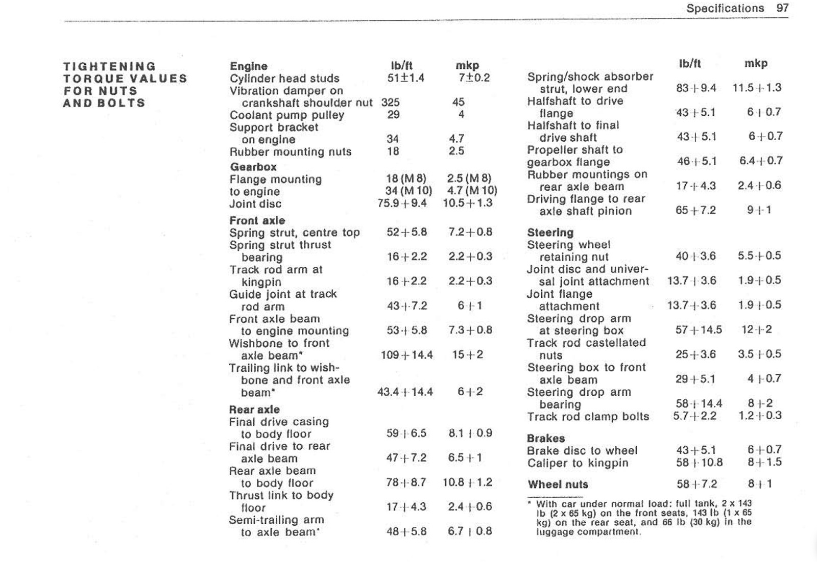

Apologies if this has been answered before - would appreciate a second pair of eyes on the torque settings for the M16 and M14 nuts of the front wishbone as indicated below. I’m not 100% that I’m matching these correctly to the description on pg152 of Autobooks:

Thanks so much. In the meantime, I’ve also discovered these torque settings on pg 97 of this owner’s manual. Curious that none of them agree.
