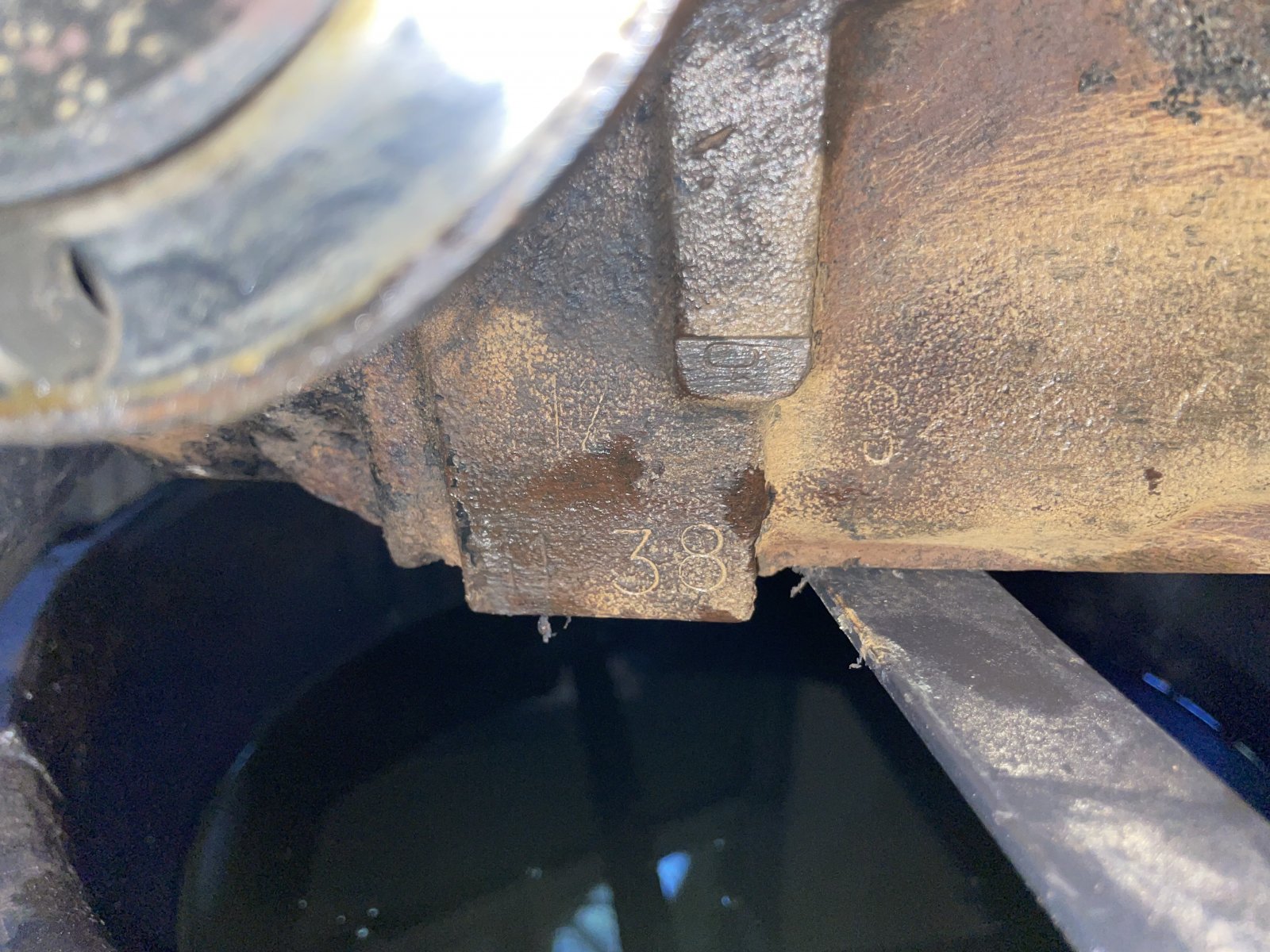

Ratio: 11/38

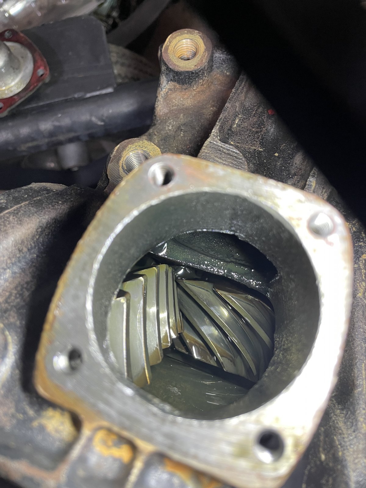

Condition of Oil?

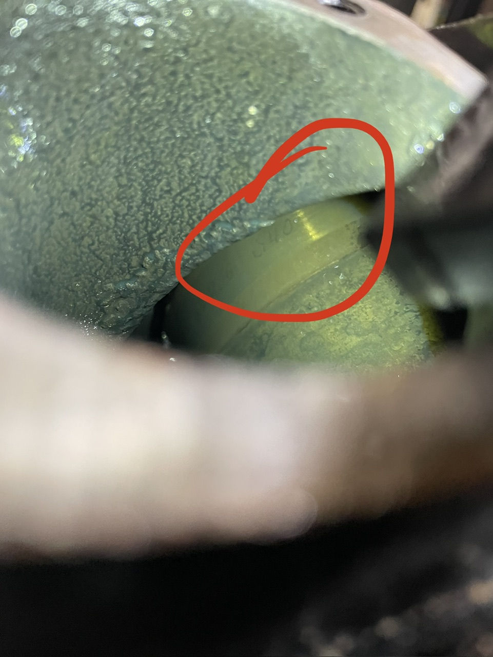

I did not see metal shavings. pinion and crown condition as in the picture here:

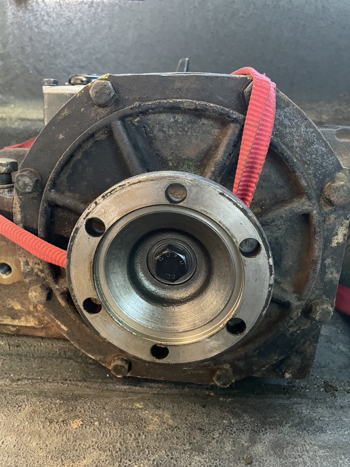

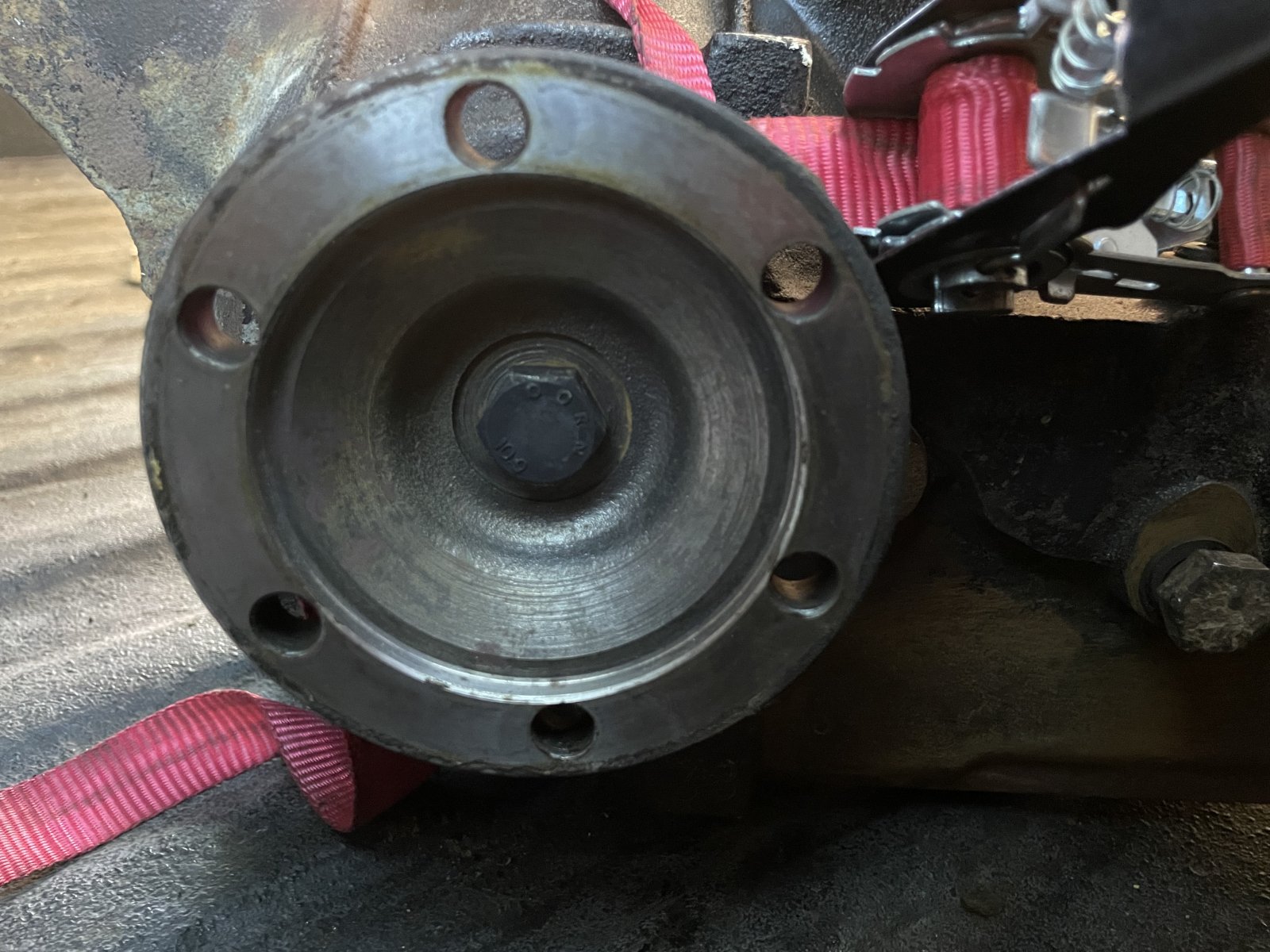

pic please of the side of the diff showing the output flanges.
I can pull a LSD off the shelf and do a FaceTime of how to test If you want.
  • Like
Reactions: Ezz
Ezz
172
116
Arizona
That is very generous of you to offer. I will send you a PM.
Here are the output flanges.

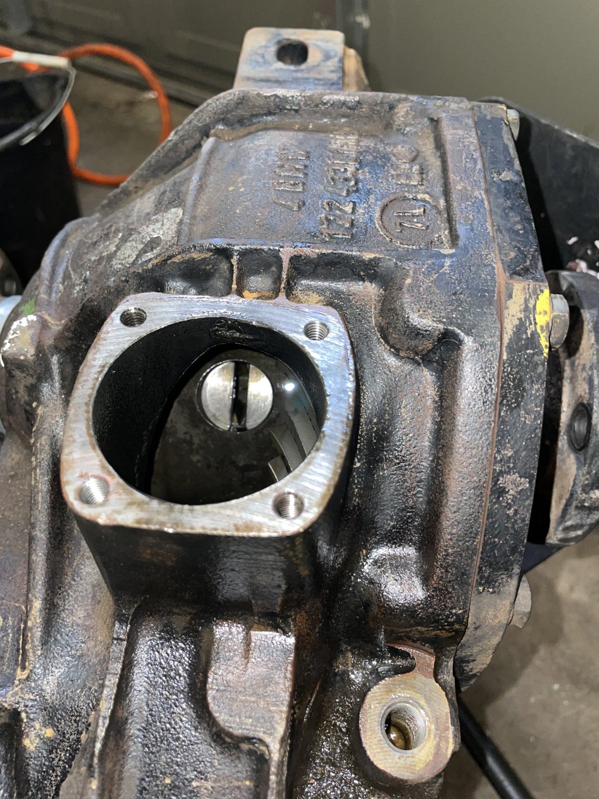

Hello All,
I had the pleasure of speaking with Don on the phone today. He was patient and extremely helpful. He and another gentelman (I apologize I forgot his name) in the shop walked me through a series of tests to determine what I have.
Here is what we figured out (@sfdon please correct me if I am wrong):
This is an early Diff with LSD pumpkin and guts confirmed by the pictures provided above. However, the LSD is not working.
As a result of the findings, this is not for sale anymore unless you know what you are getting and make an offer. Don offered me a solution and I might accept that.
Lastly, I am glad the transaction didn't go through with the earlier offers I received on it. I was not trying to scam anyone. And only a few people offered their help and I certainly appreciate that.
Thanks,
Ezz
