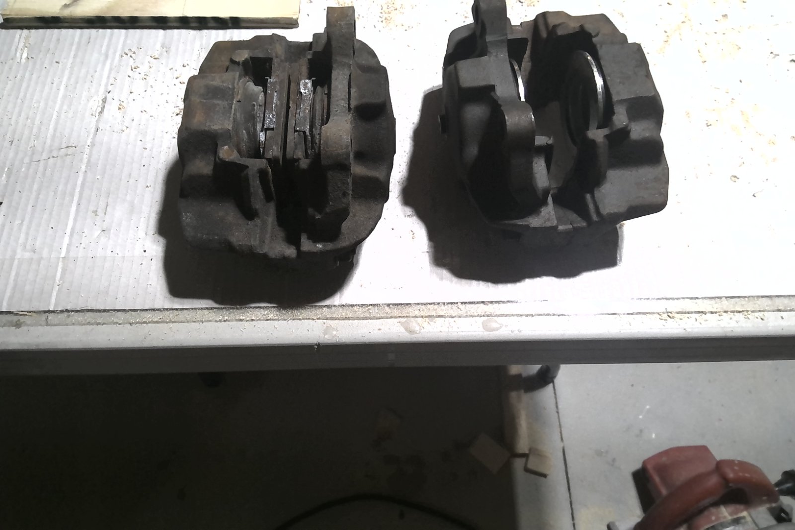

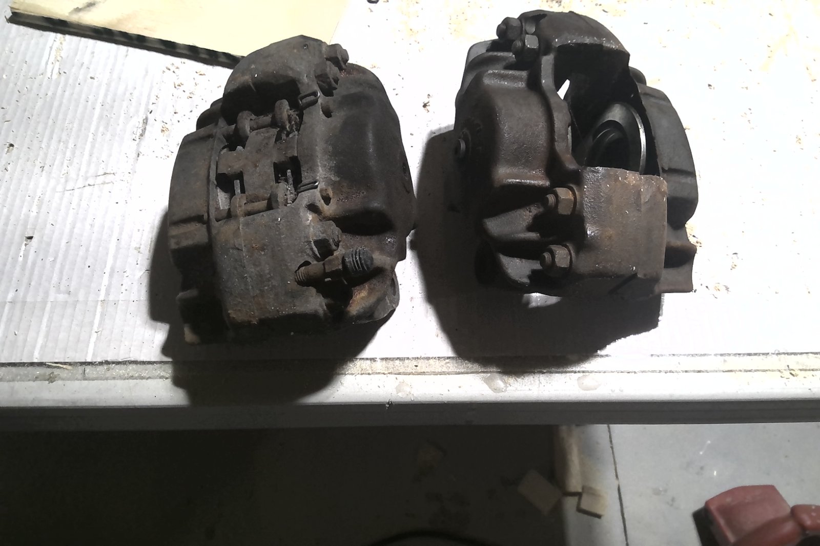

Photos of 2002Tii Brake Calipers.

Is that correct picture? Four piston calipers from factory, but you might have found an interesting interchange if removed from a 2002tii.
Not sure because they came from my Son's inventory along with a pair of Tii hubs.

Looks like reare E3 or rear 528 calipers?
Any manufacturer's marks (Ate, Girling..)? Wire clip retainer more typical of Girling.
Looks like hydraulic fitting is single at the side, reminding me of earlier calipers such as single line 1800/2000.
Wasn't an early 2000 tii was it?
