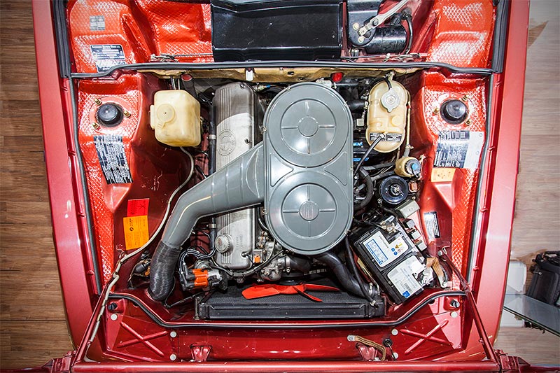

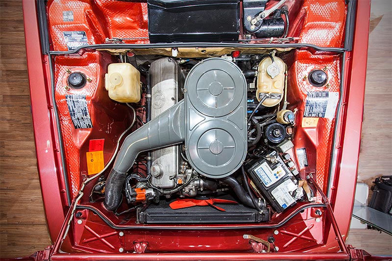

Is the red one restored? It has rubber on the fender seams and the sound pads don’t look correct but hard to tell on my phone.
Oddly enough, both of them have the rubber on the fender seams..... and both have the same decal arrangements and the same tar mats design..... not that it is any guarantee.
I’ll write Christoph.....

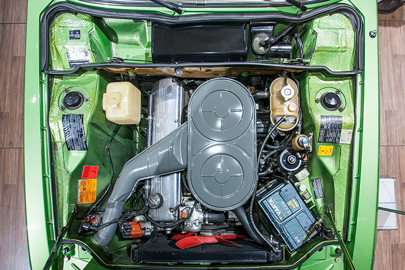

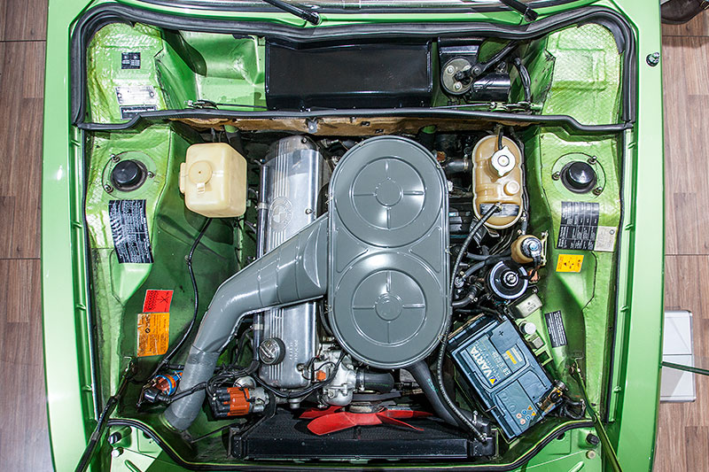

What’s the chance that the last cars in 75’s had the plastic tanks? Here’s 2 pics of original cars, the Green one is Christoph’s and the two plastic tanks have the same age/ color. The red car is ‘apparently’ unrestored too.
I can ofcourse ask him to confirm.....

To my eyes there is a significant difference between the two tanks. The plastic tank has "channels" and "knob" on top, and the hose runs out of the top of the tank. The metal tank has a smoother, cleaner surface and the hose runs off the side. The metal tank's less busy design seems to lend itself to the label. And we have the black on black colors.

Keshav has done some research and heard back form Christoph who says the facelift 74/75 coupes got the synthetic tank. Both pics are carbed coupes and the synthetic tank uses a different hose to the intake manifold, and either tank and hose combo can be used on a carbed coupe. But the CSi uses a longer hose in only one size, therefore I submit to the group that the CSi kept the metal tank until the end.
