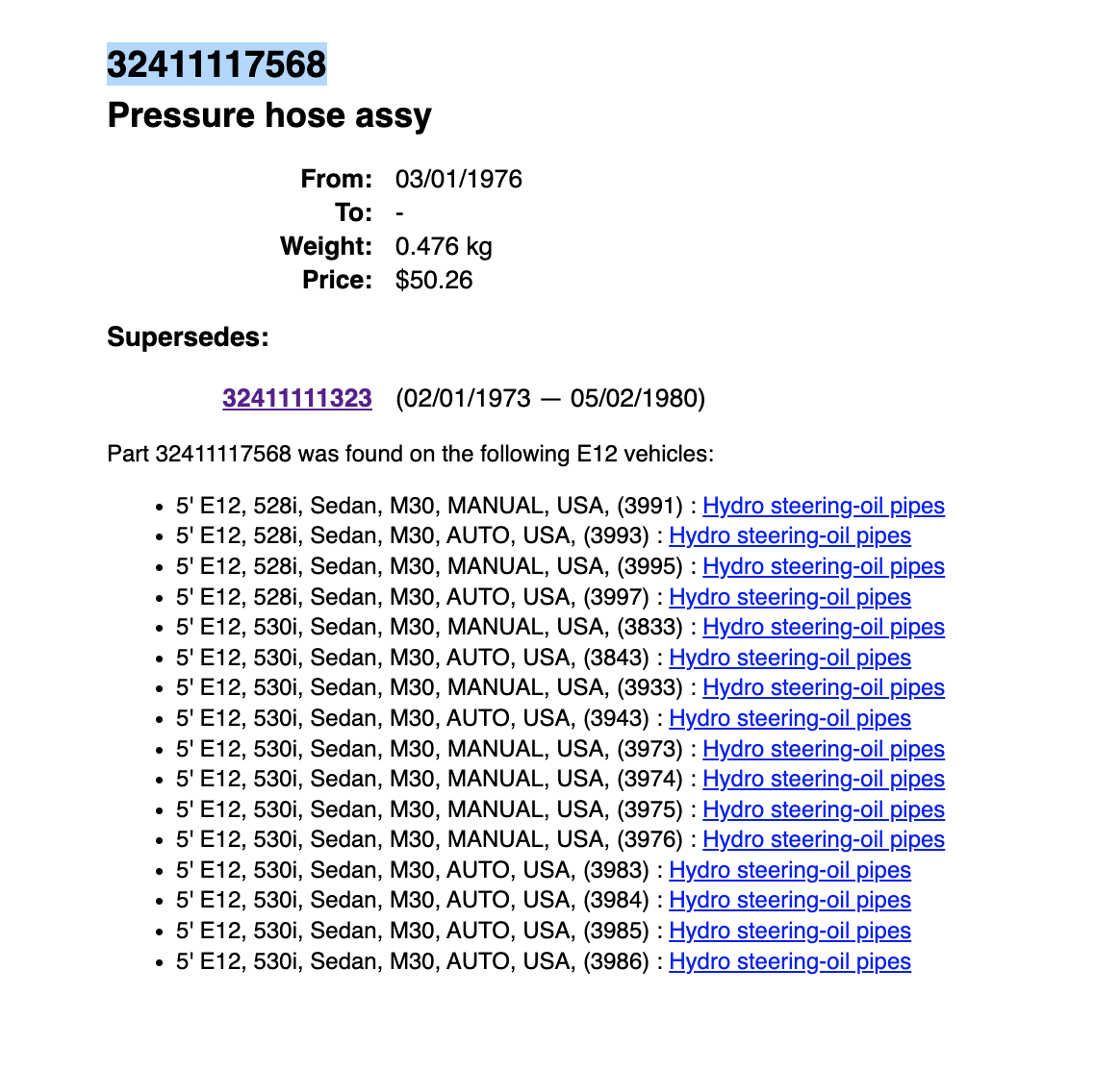

My 77 530i uses part no 32411117568 according to realoem. Every other e12 ( except one year 528i). uses the same part no as Alvaro has listed at the beginning of this post. I'll have to take a pic and measure the hose to see if its close. Not sure what the difference could be. Cars in storage so it may be a few days.

Different part number for 530i
32411117568​
Right thx Don, I did find that part no later. And posted a few postings up ^^^ Seems very odd they would have a vastly different hose for just a couple years . It looks the same compared to the ones I see on here of e9s. Fingers crossed, hose is on the way from Alvaro

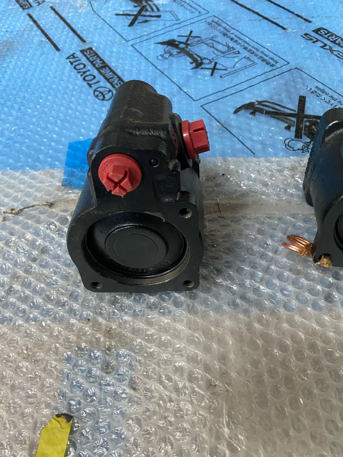

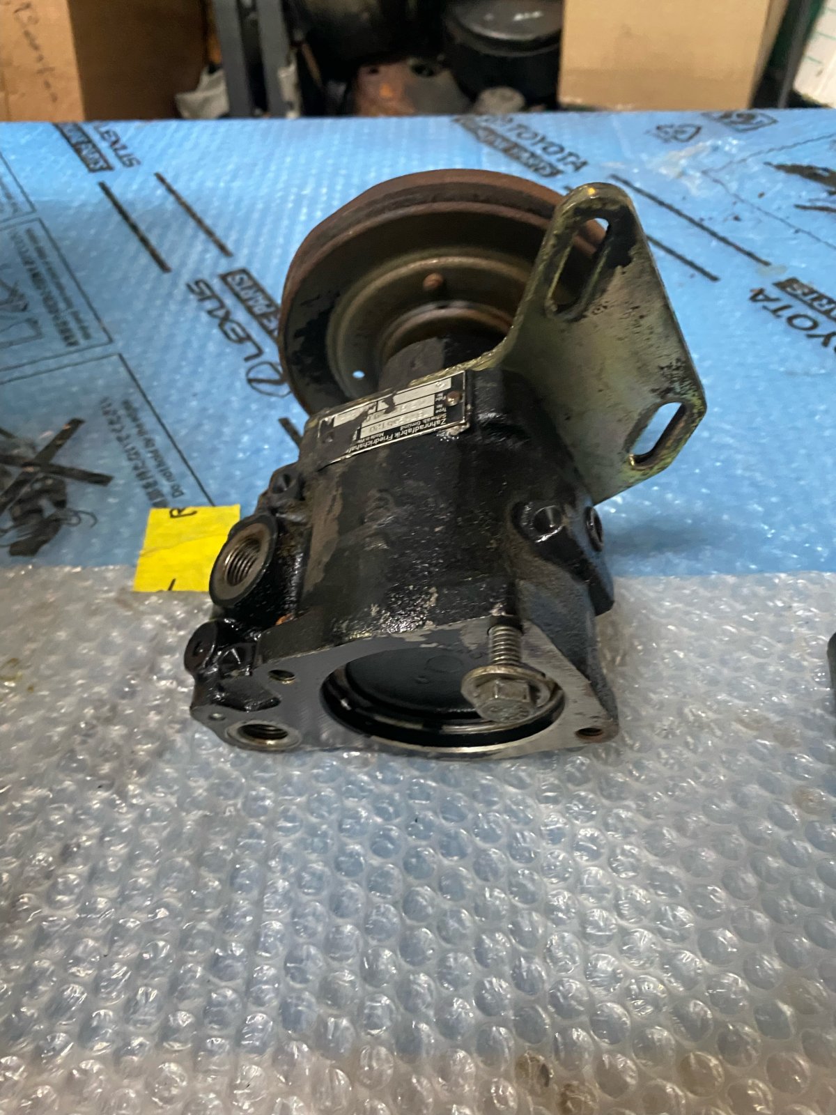

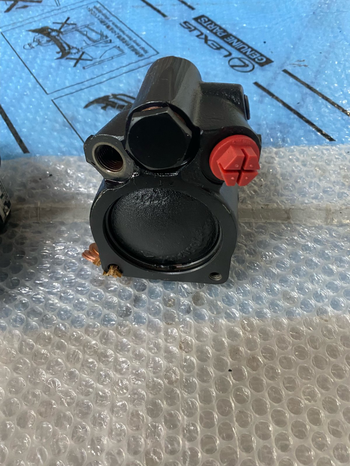

There are 3 versions of the pump.
We use Alprada hose with universal elbow adapter to fit all pumps.
