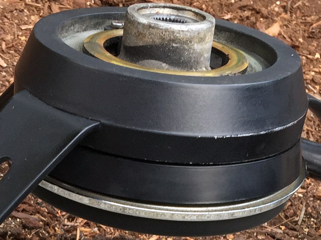

The modification which I made to the old Nardi was relatively simple and did not require any drilling/tapping. It was originally configured exactly as the one in this original thread; a plunger, but no ring or tapped holes. My car and steering wheel are tucked away in the shop so I can't provide the actual photos but here's a near exact set-up which I lifted from a website:
The brass ring and plastic insulator shown here appears to be identical to the one I used and which I removed from an old MOMO adapter. The wire to the horn button is soldered to the backside of the brass and was positioned exactly the same distance from the hub center as that of the original (early) plunger. I removed the original plunger and it's insulator from the wheel, placed the horn button wire through the (now) empty plunger hole and then pressed the brass ring and its plastic case onto the hub. It's a very snug fit on the boss and sandwiched between the wheel and hub and has never moved an iota (I've had the wheel off a couple of times). I would have been a bit more difficult without the boss (as in the subject wheel) but I think still do-able. The turn signal cancellation tab is another issue and though my memory is foggy, I think there was no change necessary.

Thanks for the clarification Jim! That approach sounds much easier. The pic above is a Nardi hub. I can't recall what type of horn ring Momo Hubs use, but I remember that it didn't have any screws. If Momo was smart like Nardi, they re-used a BMW part. I sold mine last year so I can't verify. There are three types of Nardi Hubs that I know of. The newest collapsable one above uses a pressed on ring according to your description (and picture). Prior to that the solid hubs had a brass/plastic ring with an integrated cancellation ring. The earliest Nardi hubs used the same ring as found below. This is a picture of a euro 2800CS sport wheel with spokes much like the 2002 wheel above. It seems that the factory wheels used a separate formed sheet metal cancellation ring that slipped onto the steering column. I had those on both of my steering columns. I can't tell from the pic but I bet that the wheel for sale above uses the same.
