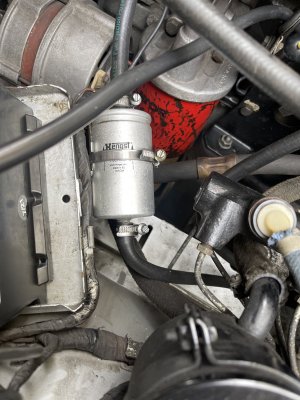

Could some one give me step by step instructions to replace my fuel filter? Should I remove the fuel pump fuse and run the engine to reduce pressure in the system? And is it ok that I have little under 1/2 tank of fuel. 3.0CSi 1972.
Thanks!!
Not sure it is the right location.
Please follow service manuals which are available under main page - tech. docs

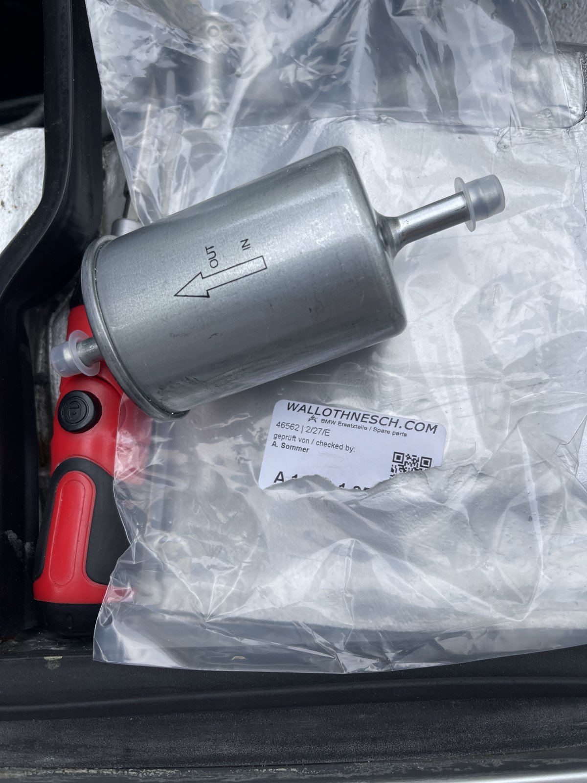

Correct location for Csi
messy job
pay attention to the arrows
use a small pan
Thank you both - done successfully. Also changed plugs and gapped them correctly - old ones were gapped way to wide and pretty beat up. Cars running great now…

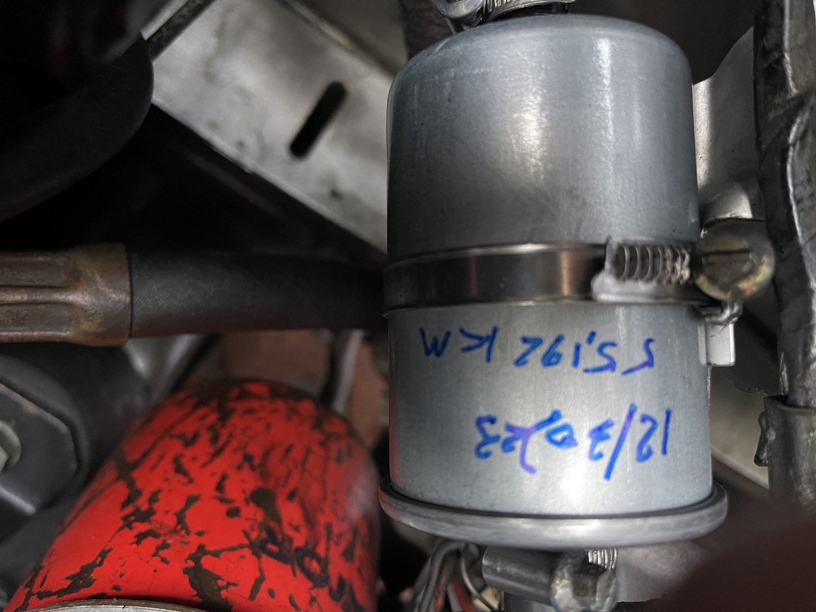

Hi there
I am about to fit a new filter to my car also, but I am not sure to what or how the filter bracket is attached.
I removed the filter years ago and can’t remember how it goes back.
Does it just “hook” around the battery tray support gusset or something and did it come loose when you loosened the jubilee clip ?

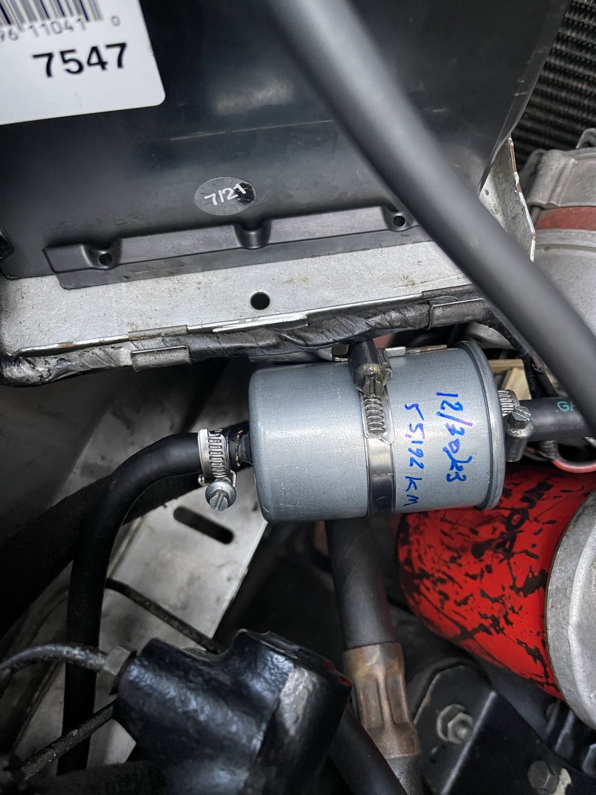

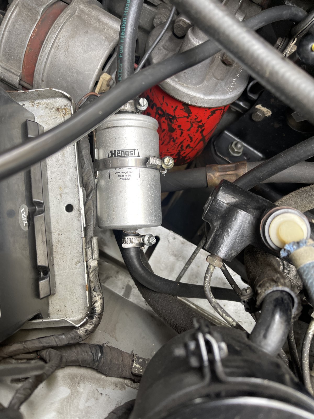

Hi Barry - there is a bracket on the side/underside of the battery tray around which the clamp goes. See the pics attached.
