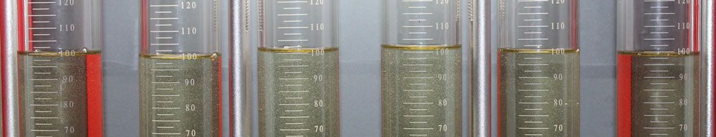

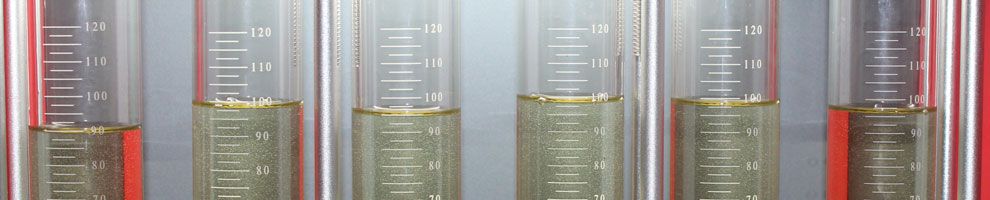

I would clean the injectors, my car was running good before I tore it apart but still wanted to make sure they were tested and cleaned. Here is two pictures, before and after ultrasound wash.
Not sure if it is noticeable, but it feels better knowing they are ok ;)

I redid my whole intake system when I got the car. Gaskets and such for the manifolds from BMW, had the injectors cleaned by a local FI shop. I couldn't feel the difference bbut the flow charts showed tow were pretty bad. If you local dealer doesn't want to deal with you, complain to BMW Classic.
